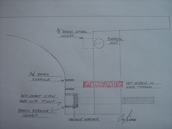

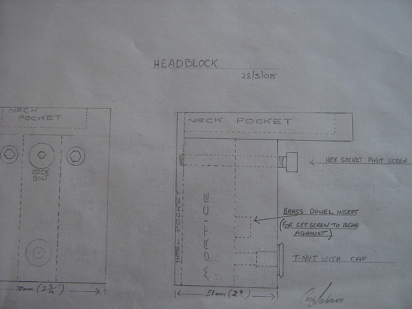

Post by Craig » Fri Mar 28, 2008 4:35 pm
O.K. here's another,one of my plans I'll call MARK 2.
It does away with a captured screw system and is very simple . The set screw decides the angle and the lower screw is tightened against it. It's ferrule is only 3/8 " the other 1/2 "
It does however require two ferrules in the heel. What I do like about it is the fact that the lower screw/bolt tightens against something , rather than the thread being held steady by the T-Nut in the headblock as is my MARK1 . Not saying that won't work either. I 'm looking forward to your views guys.
It seems so simple , I keep thinking I've missed something bleedin' obvious.
As I say , it requires two ferrules ,so some may not like that idea.
Dave , If you can P.M. me your postal address , I'll knock a couple of those ferrules up for you in the meantime and send them over.
Cheers guys , Craig
Post by Allen » Fri Mar 28, 2008 6:07 pm
I'm getting your idea here. It looks to be a very simple, and workable design. One consideration though is that you would want the allen head key sizes to be the same, or it means 2 tools instead of one.
Post by Craig » Fri Mar 28, 2008 6:29 pm
It would mean two different size keys to keep in your case Allen , that's correct.
I rushed together this idea and post this morning . On reflection ,it may be better to have the lower setscrew below the neck bolt/screw.
I could leave out the top bolt altogether . I'm pretty sure that's what Rick was getting at earlier on.
Cheers ,Craig

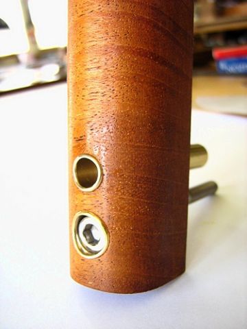

Post by Craig » Sun Mar 30, 2008 9:19 am
Dennis , thanks for that excellent report on set screws. I too favour the oval model . I only seem to be able to get the cup tip , where I live , bit these could easily be filed to an oval tip.
The set screws I bought were 1 1/4 " for the 6 mm , and 1 1/2 " for 8 mm.. I am going to try and get some stainless ones next . I agree that the 6 mm. are all that may be required.
The 6 mm. ones have a thread pitch of 1 mm. whereas the 8 mm. ones have a pitch of 1.25 mm. They look much coarser visually. I thought the coarser thread would be better until I tried out both on a trial run. I did this trial on Mahogany with the correct grain orientation. The coarser thread not only have a wider spacing between the thread , but also have their thread go deeper. In both cases I found drilling a hole around 1/32 " smaller than the actual thread was as small as I could get,and still have the set screw happily cut it's own thread. Your test into Maple would have made it hard work for the poor old setscrew ,and hence ,you could only get the hole 1/64 " smaller.
Here is a pic of the results ;
You can see that the 6 mm. one on the left,has cut a thread full depth to the setscrew's thread. The coarser threaded 8 mm. one has cut a thread probably as deep, but this hasn't been enough to house this type of thread properly .
( having trouble loading the pic ,,will try again )

Post by Craig » Sun Mar 30, 2008 9:49 am
As you can see , the 6 mm. one on the left with it's finer 1 mm. thread pitch does a better job.. It also turns better . Quite smooth yet very firm . The coarser 8 mm. one ( 1.25 mm thread pitch ) tends to 'click'. Stainless setscrews may have a slightly different feel again , having a smoother thread surface than the blackened steel ones I used.
Regards the distance of the pivot from the fretboard :
I planned on 30 mm. which leaves 20 mm. for the neck extension and pocket and a further 10 mm. for the head of the neck bolt under the neck pocket .
If I was to lose the top neck bolt ( as suggested in my Mark 2 plan ) , the pivots could go a tad higher , but even with a 30 mm. pivot , there doesn't seem to be an intonation problem . I may be wrong here , but I think Dave's pivot point was even greater and still doesn't have a problem with intonation.
I too tryed the thread tape to stop any play in the bolts. Not very successful, which is why I came up with my Mark 2 system , where it doesn't become a concern .
It would be a shame to lose the yaw adjustment Dennis . It's part of the beauty of the adjustable neck system . I don't see that we need to lose them.
We have to keep in mind the actual fabrication of the system too. I originally had a barrel in the lower headblock to hold the lower neck bolt , but this would make it difficult to have this lined up properly, remembering that a hole for it would have to be made in the headblock before attaching the headblock to the sides of the guitar. It's why I changed to a T-Nut to catch the lower neckbolt.
A hole would be drilled through the neckblock after a initial neck 'fit'. This hole being drilled by placing the drill bit through the HEEL bolt hole and then drilled through the neck block , ensuring an exact fit to both. A t-nut could then easily be fitted to the rear of the headblock via through the sound hole.
Cheers Craig
