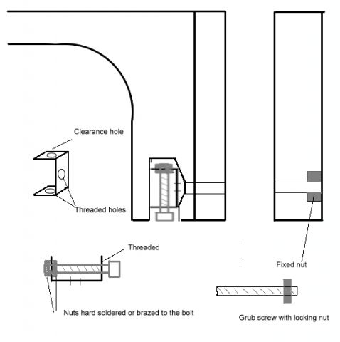

Tom… I played with the idea of a scissor jack type set-up, but it had too many pivot points (failure points) for my liking. The concept was to make a mini scissor jack (like the car jack) and attach it between the neck and body. The problem is making something like this small enough to fit in the space we have to play with while being strong enough to pull or push over 300 kg (the 80kg string tension is at the long end of the lever about 360mm from the pivot point. We’re trying to pull against this at a point 80mm from the pivot so leverage is against us).
Rather than give up, I took the concept and dumbed it down to make it simpler and more robust. What I ended up with was a truss rod like set-up, a captured bolt in a u bracket so that when you turn the bolt it compresses the bracket causing the back to bow. Fit the neck to the guitar then screw in the grub screw from the neck block so it picks up the threads in the back of the u bracket then lock it in place with a lock nut. When you turn the bolt in the u bracket the back of the bracket will bow outwards forcing the heel of the guitar away from the body. I came up with a number of compression fittings that would do the same thing but this is the only one I got around to doing drawing for.

I find your simple adjuster clever, Im sure it is obvious the hole to mount
it as shown would be tricky. I do find it "food for thought" and it did give
me an idea of a cam style adjuster. I think it would be cool to have the adjustment screw accessed in the heel cap. Thanks for the input.

James,

the brass thing you can see is a bit of rounded brass rod used to plug the hole where the hex bolt sits. There's a small hole in the tip; you fish it out with a paperclip when you wnt to remove the neck.
The 5" high tensile bolt screws into a simple brass threaded nut screwed into the bottom of the neck block.

Correct, there is one bolt holding against the string tension. Why would the neck ride up and shift?
Here's the thing...as I said it's really easy to get all up in your head, over intellectualizing and spun out imagining ways this won't work. Just build one. Build one your way, build one my way, do whatever, but stop thinking so much and let your hands get to work and just build the damned things and learn first hand what works and what doesn't. If Thomas Edison hadn't tried about 1,000 different things for light bulb filaments, we'd still be reading by gaslight... There's a point where all this discussion has to be identified as what it is...talk... Where the rubber meets the road is in building guitars, not talking about them. Nothing ventured, nothing gained.

Well, I did plan, and I studied some old guitars with adjustable neck joints. I added my own spin, but didn't get all hung up about it, and it works. It's not that I don't plan; it's that I don't let planning stop me from doing hands-on three dimensional sketching in wood. What I see here is an awful lot of drawing and chatting and it still looks overly complicated to me...for instance that upper bolt. Looks good on paper or the screen. But it's as useless at teats on a boar...
Look, in my system you've got a three way adjustable tripod...two jack screws up under the fingerboard, one nearer the heel cap. The stresses on it are out of balance because of the leverage on the neck from string pull.
There's a single screw in tension just above the jack screw by the heel cap. In practice because you've got compression from leverage on the two upper jack screws and the lower one is wanting to come away from the body, that lower one is just there to lock against the single angle adjustment screw which is where the true action adjustment comes from.
This system is just too easy, I guess. Not complicated enough for lutherie!

Thanks for your reply Rick,
My design also works on a very simple tripod system. Couldn't get much easier. The difference being , that mine is more aesthetically pleasing IMO . and doesn't require an engineer to fabricate. The hardware parts are also easly shelf bought . A plan that the average luthier can adopt with ease.
