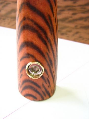

+1 !Damn your good with a drill press, I'd love to see what you would be capable of with a lathe.
Looking good so far Craig, the brass ferrule is going to look elegant and go a long way toward inspiring confidence in the buyer/player/adjuster.

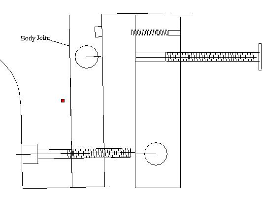

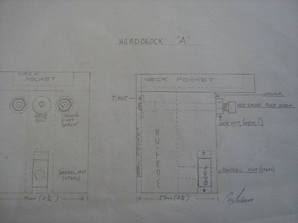

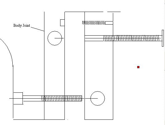

Craig,
Your brass insert sample looks great, nice quality look.
If it was me i would go with the top pivot adjustment screws as you show
in your Neckblock drawing "B". I feel it would be tricky to be able to adjust
the bolt as shown in Headblock "A" One hand inside the soundhole holding
a wrench (and it would have to be a short one) while your other hand tries to adjust with a allen wrench, (through the soundhole) the cap head bolt.
Maybe you have real tiny hands.
Im with you I don't care for the butt joint heel either, I like the extra contact area of the mortise and tenon also.
I can't see how the barrel connector can rotate with adj.
The bolt is straight and the threaded hole in the barrel is straight.
As you adj. the angle of the heel. The force would try to push the barrel
up towards the fretboard or down towards the back of the guitar.
Clockwise would be the up force counter clockwise the down force.
The first pic shows the connection as straight. The 2nd pic shows the heel
adj. in by 1 deg. The CL draw on the heel bolt shows what I tried to explain.
This is how I see it. Others may see it another way.
Straight Joint.
Joint 1 deg. tilt
I hope this helps!
Cheer's
Tom

Thanks for pointing that out Tom.
If you go back a page and look at my last plan , you'll see I mention the hole in the headblock (for the screw going to the barrel ) as a 7.5 mm. hole.The screw is 5.87 mm. in diameter.
I intended drilling the hole through the heel at around 1.5 degree. Of course the barrel can rotate some .
As I mentioned in a previous post, a half turn on the adjuster screw , lowers the action .5 mm.. I consider that a fair whack of an adjustment. In this case the thread move in Half a mm. ( about 1/64 " ) . I don't think there is a concern there Tom.
I have tried a dummy run at tightening the pivot and lock nut . I have a small 10 mm spanner ( just a normal cheap one from bunnings ) . I can hold the allen wrench from turning while tightening the nut . It's not that hard . One handed obviously
. Bear in mind also Tom , I can't see the pivots being adjusted much ,if at all, after final set up. Dave ,who is experienced with adjustable necks , mentioned this also in a previous post
Cheers , Craig
Cheers , Craig

Tom,
I just did a calculation on your 1 degree adjustment you show in your plan.
1 degree would lower the string height above the 12th fret by 2.75 mm.
We are talking a whole lot less , when it comes to adjusting the action . Using .5mm adjustment as an example , the angle change is around .2 of one degree.
It's a valid point all the same ,and I'll give it more thought, thanks mate.
Once again my apologies for my thoughtless comments regarding heel joints. It was a crap thing to say , and more than likely wrong ! As I say , my old guitar is still going strong and both my kids play it regularly.
Cheers, Craig

I love the brass ferrule - have you considered making a few more and selling them? I'm not tooled up for this sort of stuff and would love to buy some. The other option is something like the Waverly bushing converters or electric guitar through body string ferrules, but they don't look as neat and the inside diameter may not be large enough for the bolt head.

I wish I could buy the ferrules off the shelf !
. They aren't that easy to make ( on a drill press ) .difficult to centre the hole. I imagine it would be no problem with a lathe . It'll be good when Allen gets his new lathe
Only lives just round the corner ( I wish ! )
I made the ferrule with a 3.5 mm. thick floor or base or bottom
. Hope you know what I mean. This is because it is an important area, handling string pull as well as being the bearing surface for the adjusting screw. I've mentioned it before , but the ferrule also increases the bearing surface area considerably . The ferrule will be epoxied in so the walls of the ferrule will also share that load.

Ignoring the pivot screw set -up for the time being ( at least until we hear back from Dennis ,, ) Here is an update on what I was trying to explain in my above post, regarding the lower barrel in the headblock.
My old plan is now looking a bit rough around the edges with all the changes I've made . Hoping you can still see it clear enough.
I've enlarged the headblock hole to 8mm. for extra wriggle room
Cheers , Craig
Cheers , Craig

Let me try to get this straight in the old gray matter. The upper adjustment screws (whether set screws or cap head screws) will actually be holding to top of the neck just slightly away from the neck block. The upper neck bolt will pull the neck up snug against these set screws. Then the lower adjuster screw will either tilt the neck up or down.
If this is the case, then the upper set screws are a definite improvement to my mock up for the simple fact of not having to back off the upper neck bolt. The neck is going to pivot on these screws with some ease.
I suspect that we're looking too hard for flaws with the design here. If the neck is going to pivot on the upper set screws, and the lower adjusting bolt will move the neck the desired amount for any normally required adjustment, then I'm liking where this has progressed too.
We are left with how to go about building it, ie. when to drill holes for neck bolts. With something that requires precise alignment of of all these parts, I like the idea of drilling on a drill press through neck block and neck, before they are attached to the sides. This does pose a problem with making sure that the neck block is glued precisely to the sides especially in relation to the top.
The reason I like the idea pre-building the neck/neck block is that I've never been totally satisfied with trying to drill by hand and get everything square and lined up once the box has been assembled.
If there anyone has insight on how to go about this, then please, I'm all ears.

Do you think epoxy strong enough to retain that T-nut though? The reason I had it in my mind to put it at the arse end was that the string pull would be pulling against the flange which would be hard up against the rear of the headblock. ( can't be pulled out/through ).
I thought I'd hit on it with the vertical barrel. In fact I was quite pleased with myself,,,,,,,,,,,until now ,,,,,,,
. I think you are right Dave . Once it's in there you can't get it out, and I don't like the idea of that much at all.
B.T.W. After your description of taking off the neck with a captured screw , I can see that it poses some difficulty, or should I say inconvenience . I think I might cop that inconvenience if the benefit was to have an external adjuster, but there again , I've never undone a neck with a captured screw system as yet , so what do I know . Also mate, I would make up a heap of ferrules and send them to you if they were that easy for me to knock up ( man, I know I owe you that at least) . Truth is , they're very tricky to make on the drill press. I'm sure a guy with a lathe would pop them out in no time, and that's probably the way to go.
I've given nyloc nuts a fair trial this afternoon , just so I know of their durability. With the particular nuts I used ( 6 mm.) they failed miserably.
I ran the nuts up and down a thread about 1 1/2 inches long ( once only ) ,after which their locking type resistance had bloody near gone altogether. That was with that particular brand of Nyloc nut . Other brands may perform better, but I've certainly lost confidence in them.
I also gave the set screw into wood ( creating their own thread ) , thing a good go. Using a piece of Mahogany with the correct grain orientation, I trialed several different size holes . I got the tightest fit when the hole was 1.1 mm. smaller than the actual outside dimensions of the thread . I went for a hole 1.25 mm. smaller than the thread , and it didn't like it . The wood started lifting around the entrance to the hole , so settled with the hole 1.1 mm. smaller than the thread . I must say that I'm fairly impressed with their performance. Dave , you have been using them for some time . Do you think a steel thread into steel retainer ( T-nut etc ) , is worth pursuing ? I had it in my mind that it was the way to go , but it poses an extra set of problems by way of locking them from turning, whereas the wooden thread seems to offer enough resistance without having to worry about lock nuts etc . Did you find your belt and braces method necessary or just as an extra insurance ?
Dennis , we are trying for an external adjusting system, that is ,if we can design one that will work reliably. It would be a whole lot easier to deal with an internal adjustment with a locking screw . That's been handled by people like Dave without problems ,as far as I know. To be able to adjust the string action , without having to loosen the strings and dive into the soundhole would be a great advantage . This is what we are striving for, and hopefully achieve.
You mention the intonation thing again . We have covered that in a fair amount of detail , and discovered that this isn't an issue at all. This was confirmed by Dave who is experienced with his adjustable system , and also with my calculations showing that with a pivot point of 30 mm. from the fretboard , the string length only increases it's length by .093 mm. ( around 3 1/2 thou ) , when lowering the string action .5 mm above the twelfth fret. Intonation is of no concern.
To recap :
We have only Daves idea of a T- nut in the lower headblock to accept Craig's captured screw system. Using Daves T-nut would enable the builder to line up the heel to the headblock . I suggested this T-nut would be better placed in the arse end of the headblock ( the headblock face you see through the soundhole), although it would in my opinon look shithouse. I've expressed concerns that the T-nut might get pulled out when installed in the front of the headblock ( Daves missionary position )
Hope I haven't missed anything here . Let me know if I have !
With the upper pivots , we have a steel thread going into a T- nut (installed into the front of the headblock) with a locking screw set against the headblock surface . ( as per Craig's plan ) ,,OR a steel thread ( by way of a set screw or long threaded screw ) creating it's own thread through the headblock. My trials with Nyloc nuts show them to be unreliable.
That's it so far , but please tell me if you think I've missed something.
Dave , I can't say I'm absolutley wrapped in a T-nut being installed in the front of the lower headblock with only epoxy keeping it from being pulled out by the 170 odd pound of string pull.To me it makes more sense to have it installed at the rear where it can't be dislodged by the pull of the strings. Shame it would look so ugly . Maybe a cosmetic job may help in this regard.
I invisage drilling this lower hole through the headblock by puting the drill through the lower heel hole ( captured screw system removed of course ) and drilling through the headblock . This to be done after doing a neck "fit". It would give this hole the correct angle and placement in the headblock. Whatdoyareckon ?
Sorry to be so long winded folks.
Cheers Craig
To recap :
Cheers Craig
