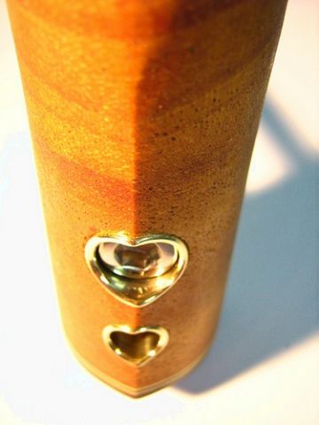

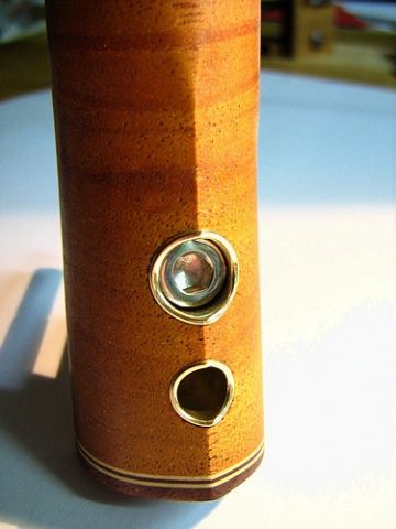

Here's a couple of shots of the ferrules in a pointy heel for Dennis ,and any other stiletto folk.
This was a surprise to me ! When you are looking down on the heel , the ferrules become heart shaped 8)
Whadoyareckon?

Post by Craig » Tue Apr 08, 2008 10:10 pm
Allen wrote: Who knows what a chronic tweaker would do with it if it was too handy.
Geez , I think I might be one of them Allen :? :lol:
It's a good point ,and one Kim bought up around a couple of hundred posts ago.
Rick Turner and Mick Doolin don't seem concerned about having external adjusters. Their system must be built well enough to handle constant tweeking . Then there's the Babicz system . I'm pretty sure Gibson are producing a model using his system as well . I would think they have researched the possibility of the "chronic tweaker " :lol:
I'm sure there are others as well.
I agree it is well worth considering though Allen ( and Tom )
Hang on !! ya mean I made all those fancy ferrules for nothing !! :lol: :lol: :lol:
Dennis , regarding Grant's springs, I just checked out that link . Too cool for words and very clever. I learnt a heap . Thanks Grant !
I really admire your mastery of the router Tom . I'm still wary of router learning curves :shock:
Cheers ,Craig
