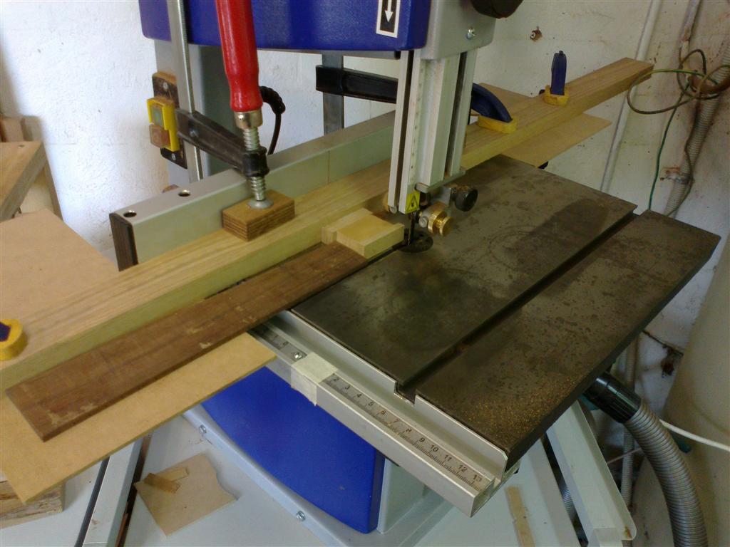

Had a few fingerboards to cut today so I decided to give this little jig a try-out on my 'well behaved' bandsaw.
I had to do a bit of setup first.
The fence needed to be extended out front & back as did the table surface.
So I added on a straight piece of Tassie Oak & some mdf scrap and all was ready.
Since the bandsaw doesn't like to start a cut on the corner of a board, I had to swap the jig to the leading end.
This way the cut starts inside the board and exits at the corner - just watch your fingers & use push sticks etc.
Results were excellent!
Thanks Allen.

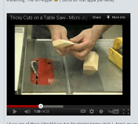

On a brighter note than us group of guitar playing woodworkers focusing on our potential to become amputees, I though offering a safer alternative would be a nice touch for this discussion..If there are safer ways to do things we should take them...even if they can be fiddely things..at least you'll still have things to fiddle with.
Presenting: The Grr-Ripper :D ( Gotta luv that apple pie name)
youtu.be/
I have one of these (should have two for ripping longer stock ), here's my review:
It's a bit of mucking around setting the bloody thing up for each cut and it does have its limitations, but it works well at what it does and is really good for thin and narrow stuff.
