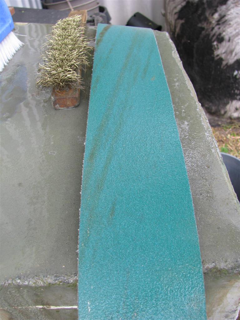

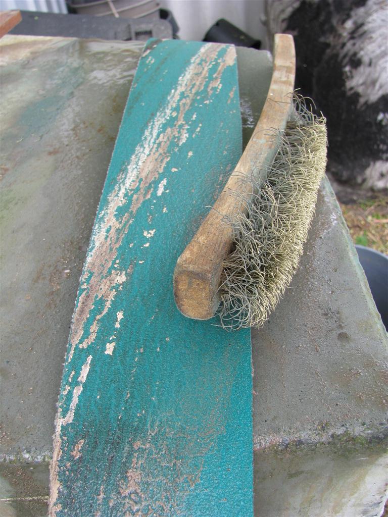

In fact things were gummed up so bad that during the clean up operation the nylon brush was not being as effective as I had hoped even after a 48hr soak. So there I was giving the crook Gerni a dirty look when I came up with an idea for yet another tool that would make the job go easier..a brass wire brush. I guess any wire brush would work as well but the wires on my old brass job had become bent over from abuse and I was hoping that using it to clean the abrasive belts would grind off the bent bits and renew the brush...and as you will see in the last image, to a point, it worked 8)

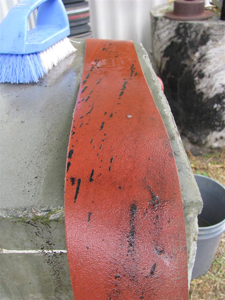

So here we have some more before and afters so you can judge for yourselves how well the method works, even without a pressure washer. Its a bit of mucking about I suppose but it saves a shitload of $ on sanding belts :D

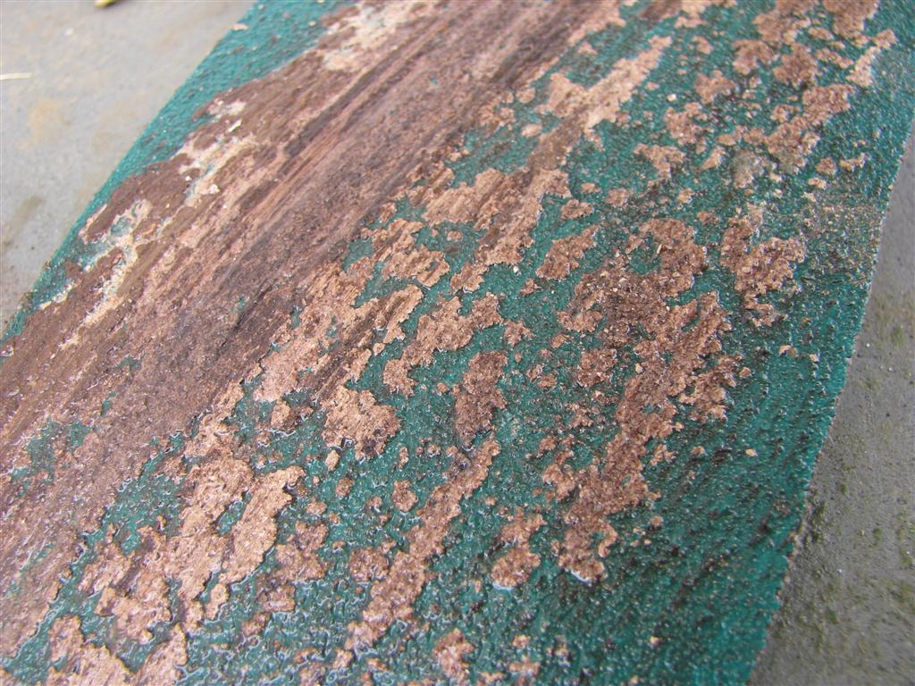

Straight from the bucket after a 48hr soak with the nylon brush at the ready:

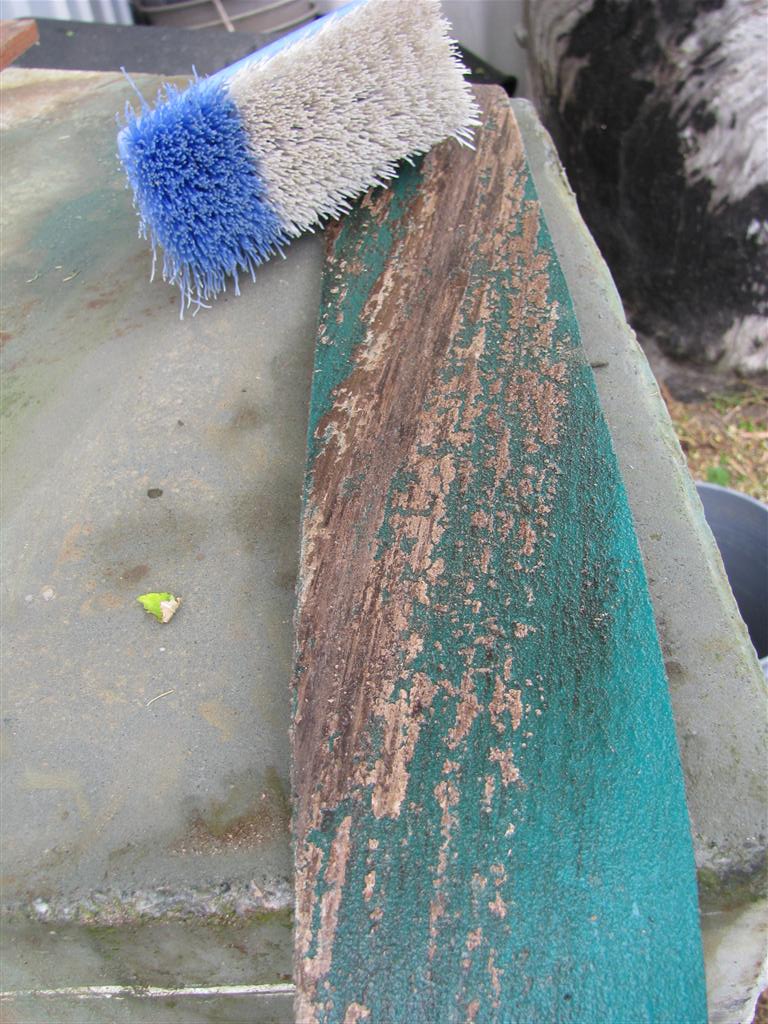

After a scrub with a nylon brush and the brass wire brush ready to go:
After a scrub with the brass wire brush its good to go. Quick and easy, now just hang with the washing for an hour and it can go back on the machine.:

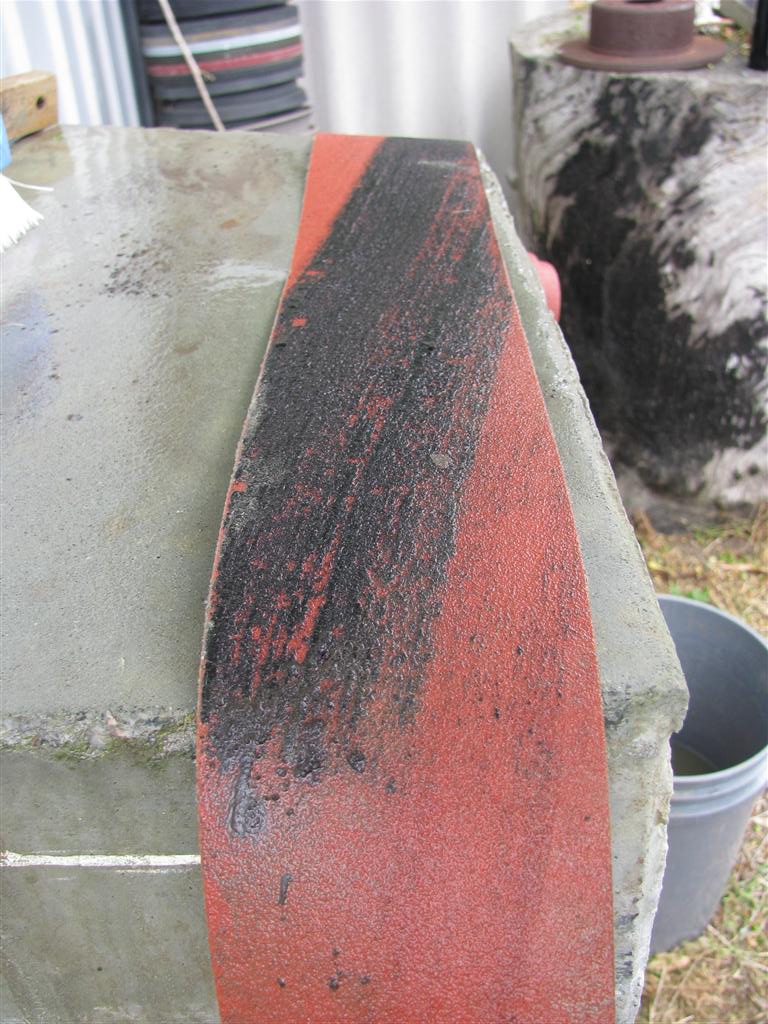

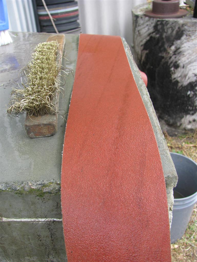

Here's some before and afters of an 80 grit Klingspore, same brand of belt that supplied with the Jet sanders when new. This one has burnt on either particular oily Cocobolo, or the king of waxy woods, Bocote..
Again, quick and easy and ready to go back on the machine instead of the bin..

Yes John, WA Sheoak is another species of wood that must be sanded with 'very' light passes. But if you do happen to get some burning on the belt, this method will sort it.
A wire brush, screw driver, old chisel etc will all work to a degree, but soaking is the only thing that will make most anything fall right off, and because the gunk comes off so easy, minimal damage is done to the abrasive in the process.
I keep a dry 20lt bucket in the shed into which used belts go as they come off the machine. When there's 6 of them in there they get covered with water and a dash of any detergent available is added to act as a surfactant to assist water to get into the crud so it will expand and lift off of the surface of the belt...If you look closely at some of the images above, particularly the third last, you can see that is precisely what has happened.
Some people freakout thinking that doing this will somehow affect the belt. But its not sand'paper' we are working with here. The backing on all of these drum sander belts is a poly of some kind or other and the abrasive is always bonded with a resin of some kind...none of these things, including the abrasive grit itself, will be adversely affected by water. So there is no danger whatsoever of buggering the belt even if you were to soak them for six months...but I must warn anyone who tries this against just leaving them soak for days on end without changing out the water....after just a few days, the water is going to STINK!! and it will do so far more than you could imagine a bit of saw dust could..DAMHIKT :|
