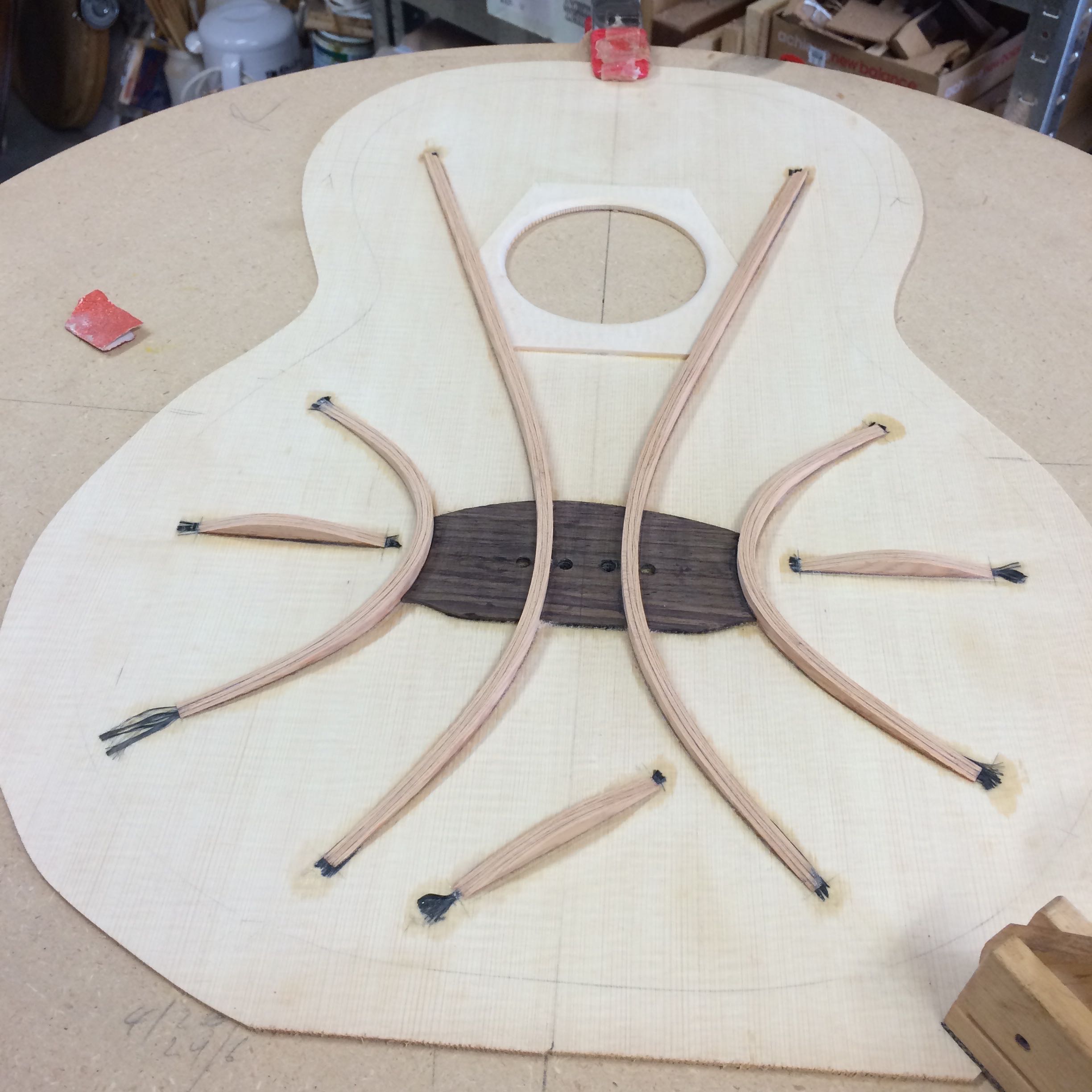

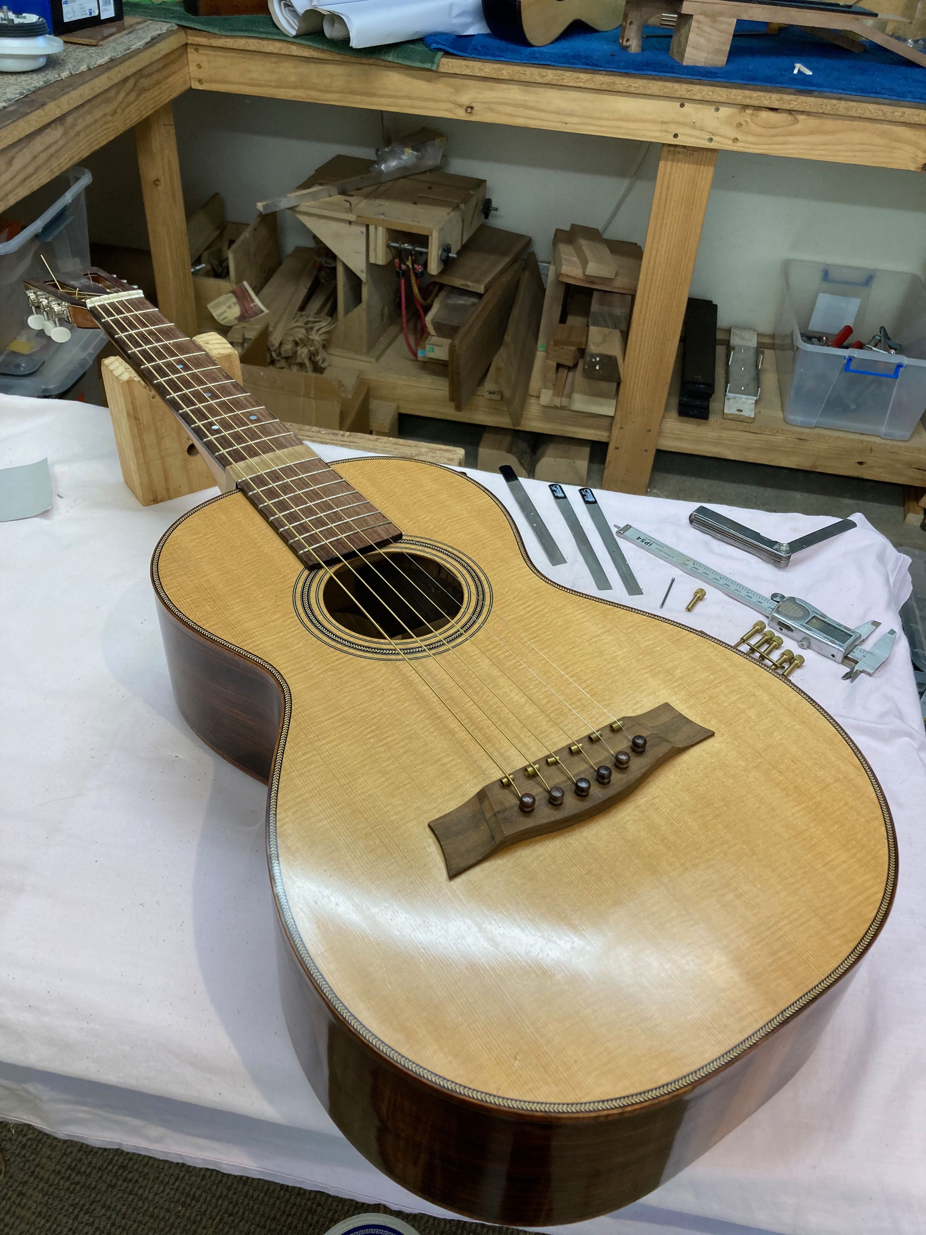

I've just strung up a falcate braced parlour guitar Ive been working on for 2 years now. From memory the bracing dimensions were pretty much as per The Books. The guitar sounds loud and has more balls than any of my larger bodied builds.

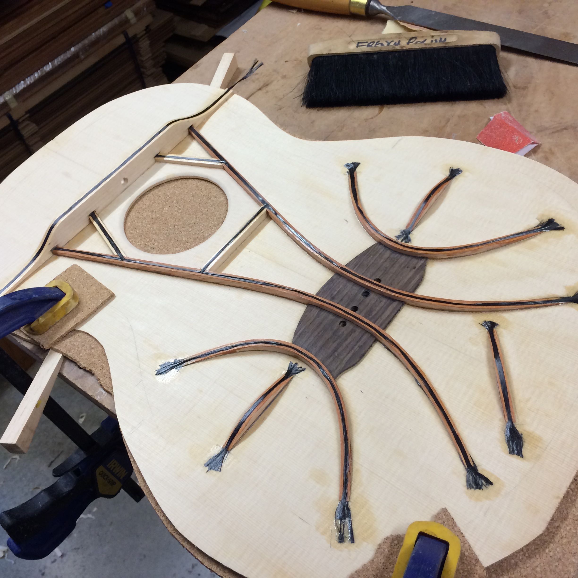

The smallest I have gone is falcate braces on a 00 body. In terms of the calculated thickness, I suspect there is a minimum thickness required for falcate or x braced guitar for the structural requirements. I retopped (a dropped) lattice braced guitar with a top around 1 mm. The lattice distributed the bracing such that the top plate itself did not have to distribute load. I do not like to go much thinner than 2 mm on a classical and a bit more on a steel string to keep the braces from telegraphing thought the top. I do not have any real data though

I imagine you're pretty pleased with that outcome! I haven't mucked much with the bracing, other than my soundholes are moved into the upper bout regions so I have more unbroken plate to work with... it's just the plate thicknesses I thought too thin. About ready to delve into rebracing an X topped 0 that had bad wolf notes following some bad advice per another one of my threads, now following Trevor's. I hope for the same result.kiwigeo wrote: ↑Thu Nov 11, 2021 9:00 amI've just strung up a falcate braced parlour guitar Ive been working on for 2 years now. From memory the bracing dimensions were pretty much as per The Books. The guitar sounds loud and has more balls than any of my larger bodied builds.
