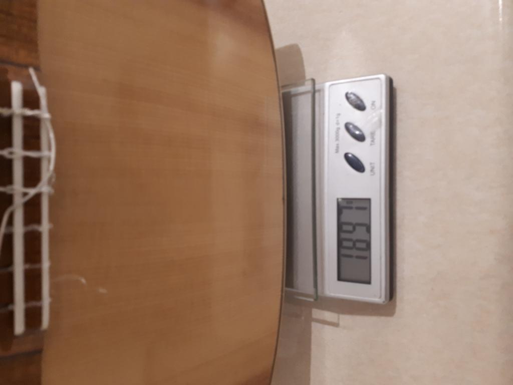

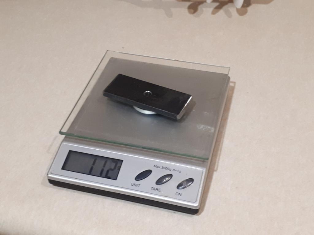

I made some weights out of 30 by 6 mild steel flat bar, cut them to fit in between the top and bottom linings and drilled them for an M6 bolt. They are about 110gms or so each, weights vary a little. I weighed the guitar for each added weight and subtracted the bare guitar weight to get the total added mass, including the bolt.

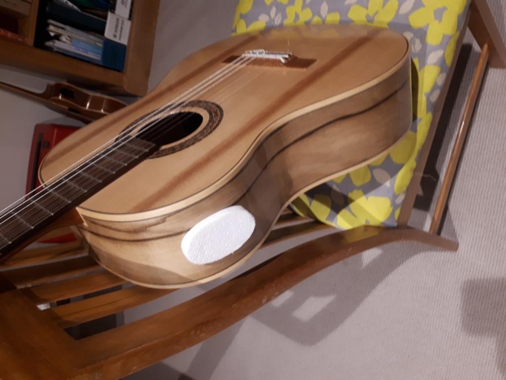

I made polystyrene plugs for the soundhole and for the sound port. I also made a half sized plug for the sound port as when I made my template for the soundport cut, I had no idea what difference it would make, I just chose a size I thought looked good. It would be good to check out what difference a smaller sound port would make.
I went through the tap test procedure for the bare guitar and then with each of the four different added masses. For each weight, I tapped with the soundport open, half open and closed. I only measured T1,1, T1,2 and T1,3 for the purposes of this check. I took three lots of taps, recorded peaks from the screen plot and then averaged them. Accuracy of reading the screen was better than 1Hz, but decimal Hz in the averages give a bit of a misleading impression of accuracy – around 1Hz was good enough for me.

No one will be surprised that the T1,1 and T1,3 didn’t vary much with added weight.
The added mass allows me to tune the T1,2 to 190Hz (my desired frequencies were 100, 190 and 240).
The T1,1 varies significantly with and without the soundport. Increasing soundport area increases the T1,1 and this in turn increases the T1,3. It should be possible to fine tune the T1,1 using the size of the sound port. A way of incrementally increasing it while you check frequencies would be a good idea.
If your T1,3 is too high, then adding a soundport will make that worse. I could do with dropping my T1,3 by 3Hz and will look at that another day. Just add some weight to begin with I guess.
Overall a fairly interesting exercise for me. Unfortunately, even though I am almost exactly on my desired frequencies, the guitar doesn’t yet have the brightness and sustain that its conventionally braced predecessor has so I’ll have to look elsewhere for that solution. Next step is new strings.
There’s a combination of added mass that gets me to 101/190 with the soundport half open size, that’s probably close enough for me, so that’s a good result. The soundport is on the righty side and so I need to block it off and make one on the lefty side anyway, so I might as well make it smaller. As a player, I'm not so keen on the added weight but I guess Ill get used to that.
