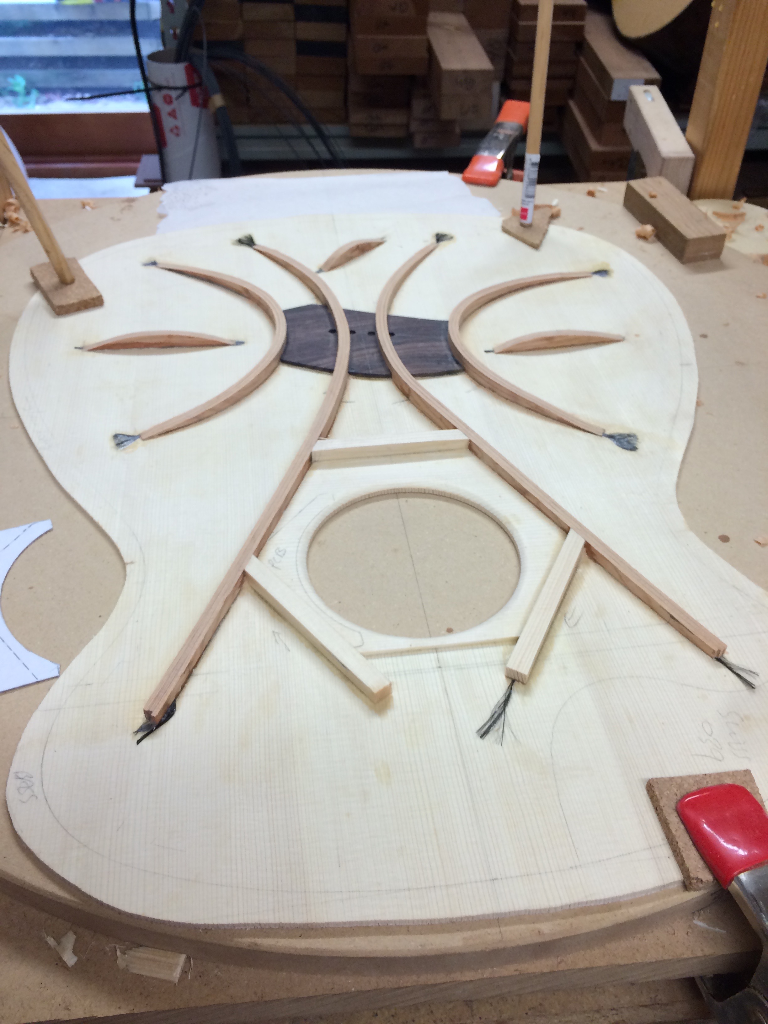

This is a fairly close version of Trevor's medium SS. I think the most important bit as Martin has suggested is to make sure they fit cleanly between the bridge pins.
