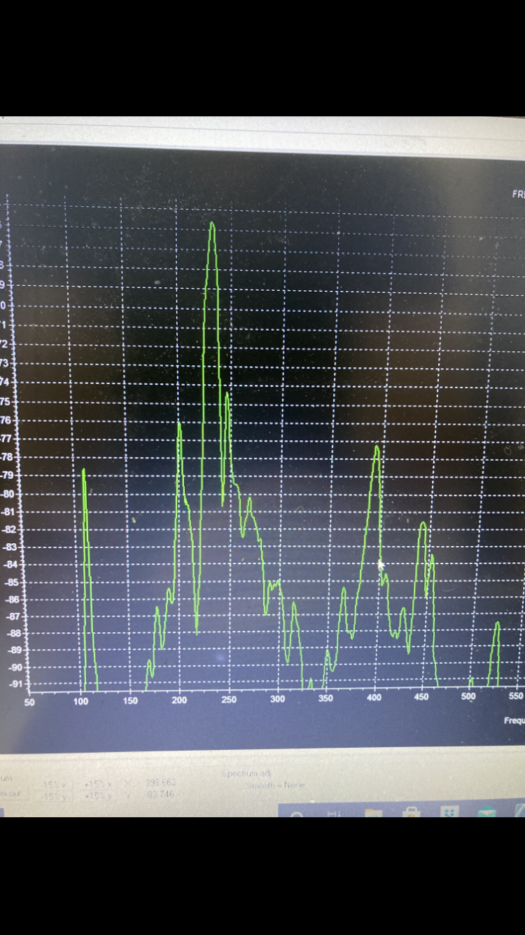

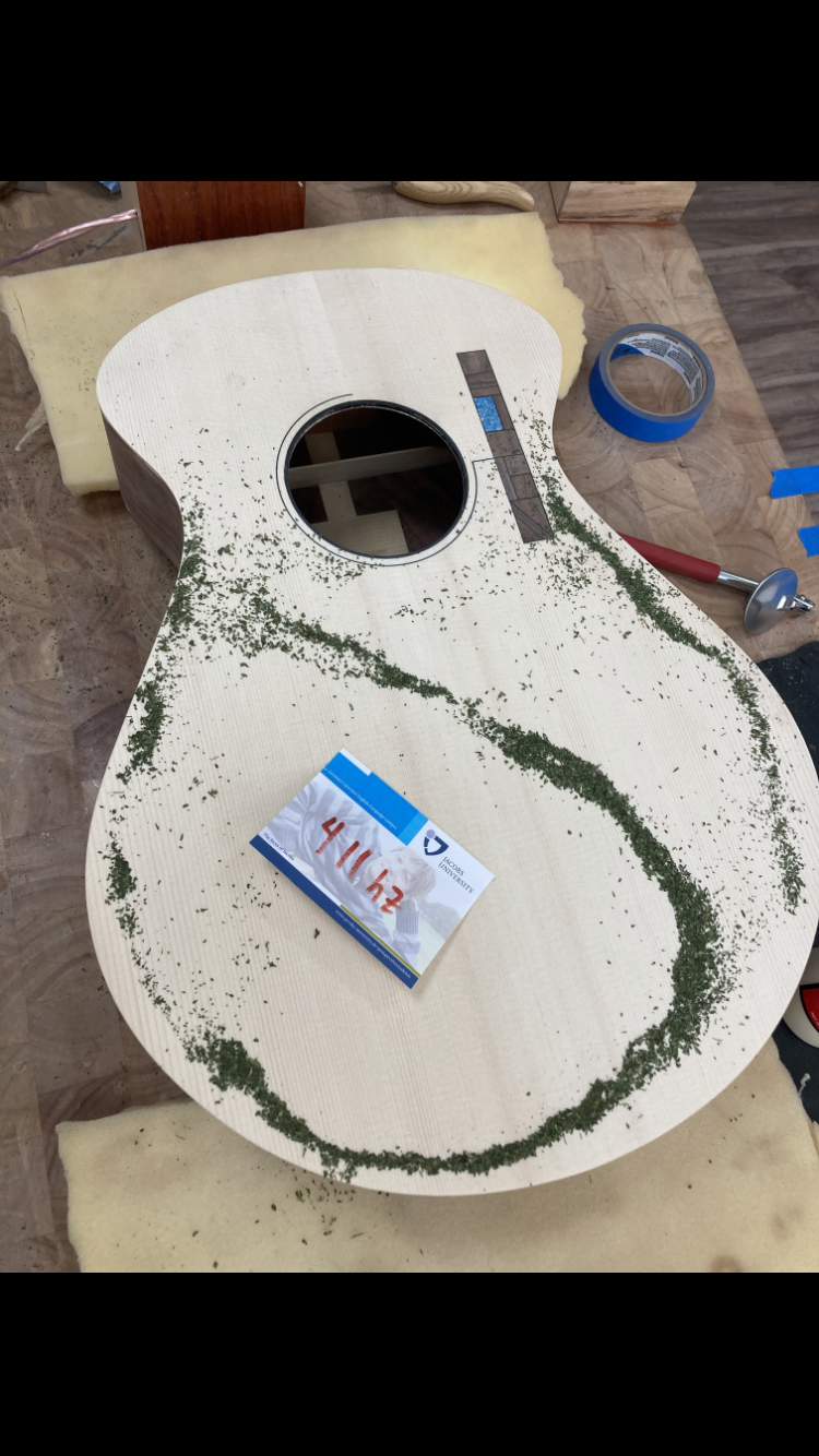

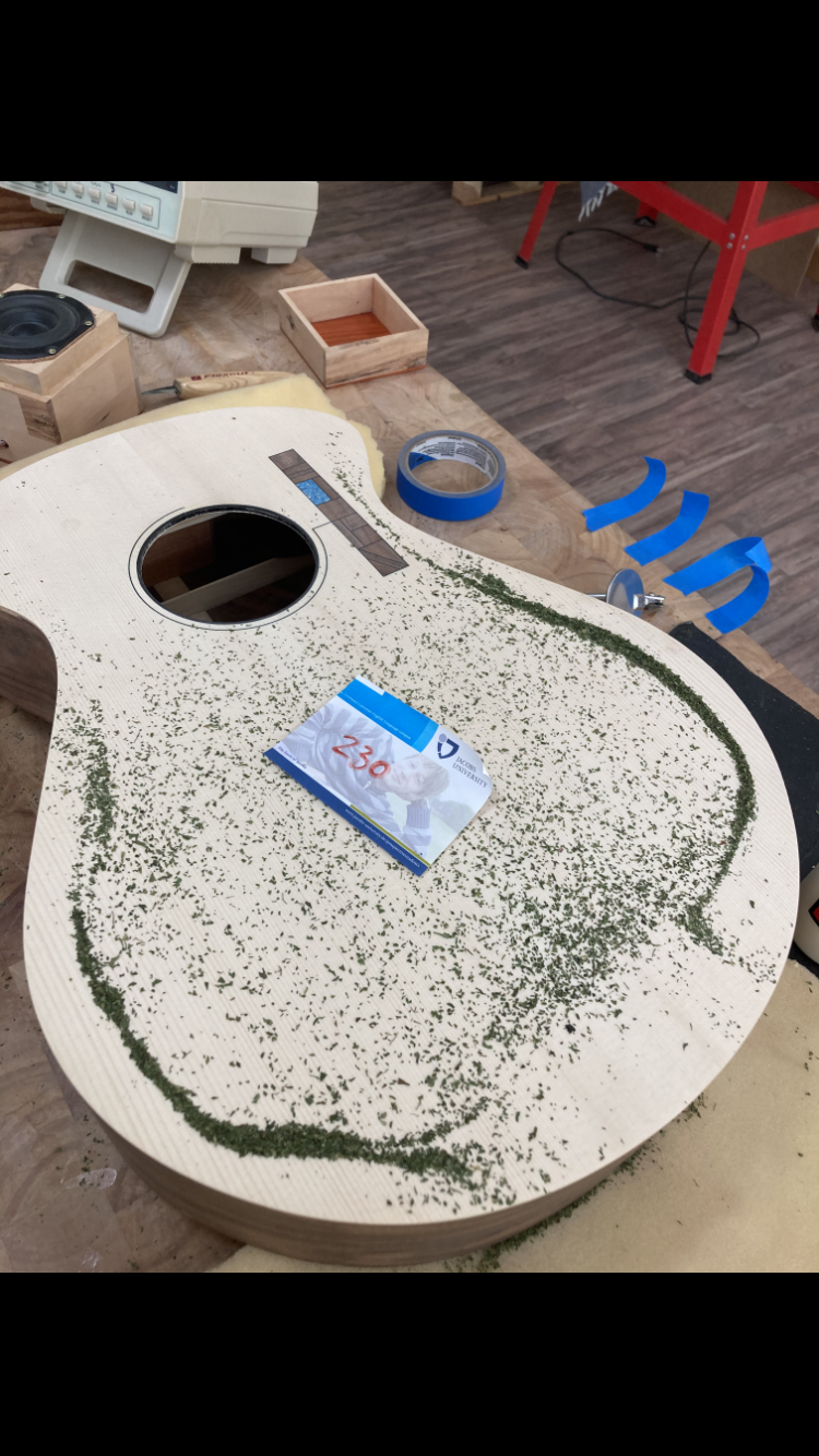

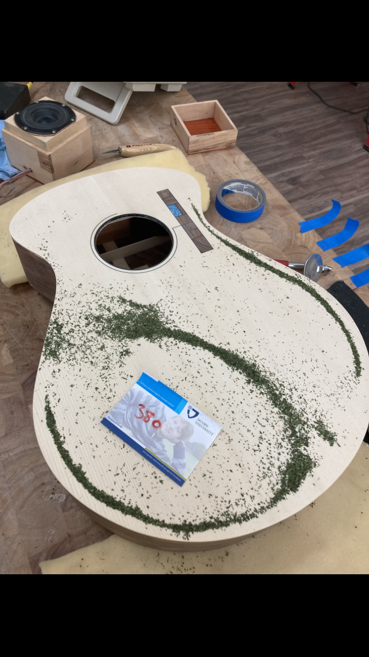

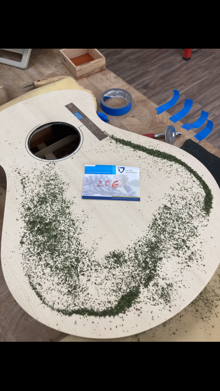

So I recently got the box closed and got a nice peaky spectrum. Pulled out the ol’ signal generator for come chladnis and I have two monopoles and two cross dipoles... and they correspond to peaks on the spectrum. Any idea what is happening there? Are resonances coupling somehow?

I do not see a spectrum spike at 216 Hz. I am wondering if your back is pitched a bit below the top and the back is showing at 206 Hz and the top at 230 Hz. You can stick some mass on the top and/or the back (like blue tac) and see how the peaks move in relation to each other.
