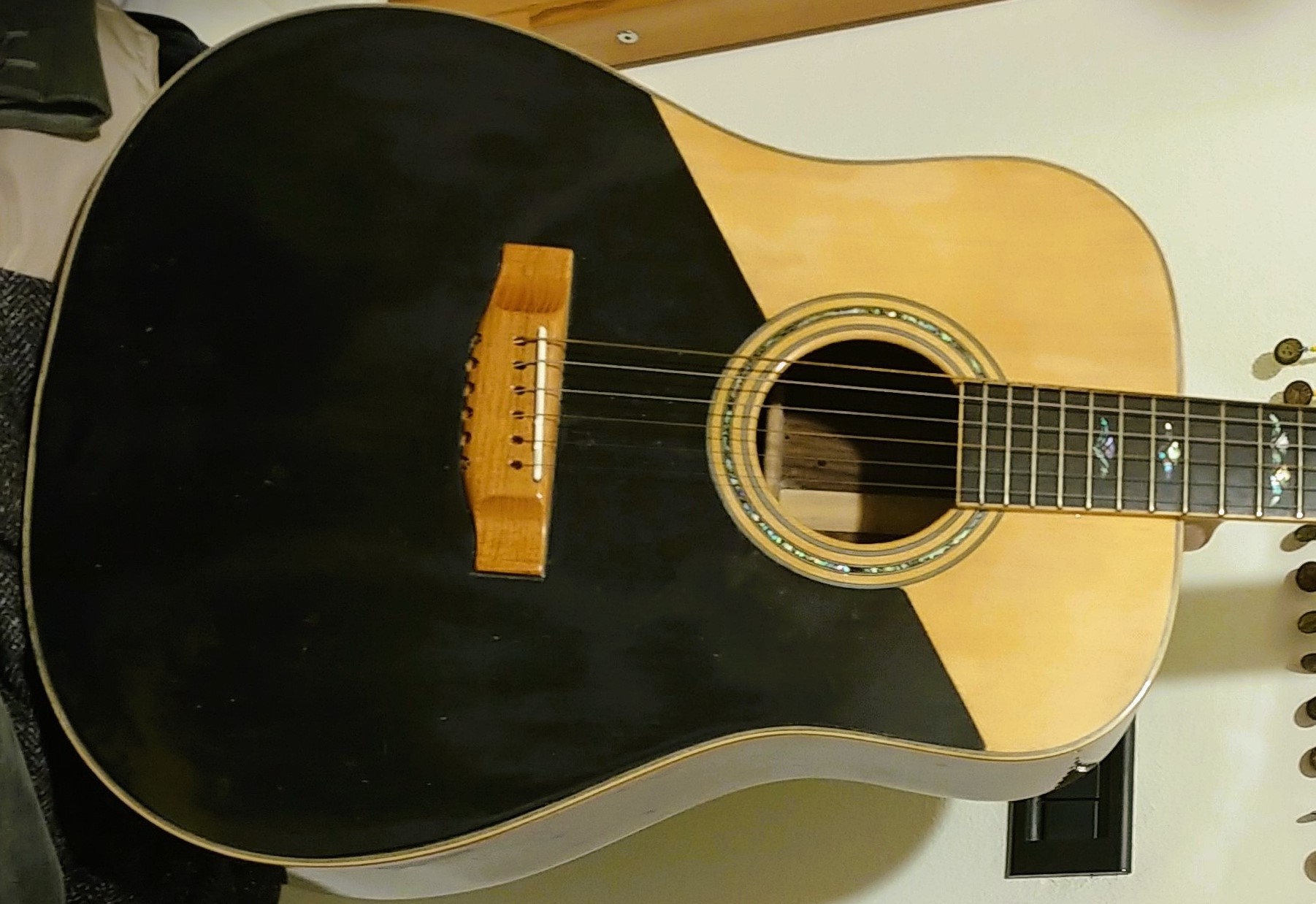

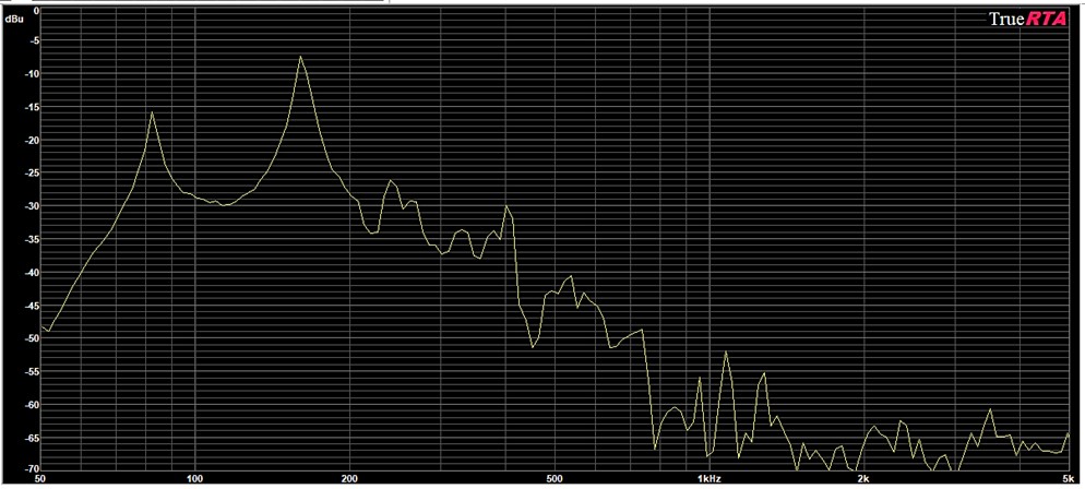

I have just taken a spectrogram of my almost-braceless old composite Dreadnought. Big first and second peak, quite low all the others

But apart from the not completely braceless design (I left the residual X-brace under the wood part) a fact is that the nomex core is thinned from 3.2 to about 2mm on about 4cm width, towards the soundboard edge. And the little variation of thickness correspond to a much greater variation of stiffness.
So even if the largest part of the soundboard is braceless, there is a "map" of variable stiffness.

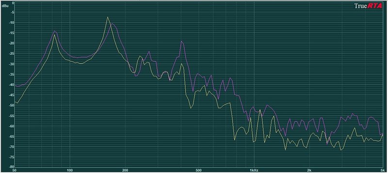

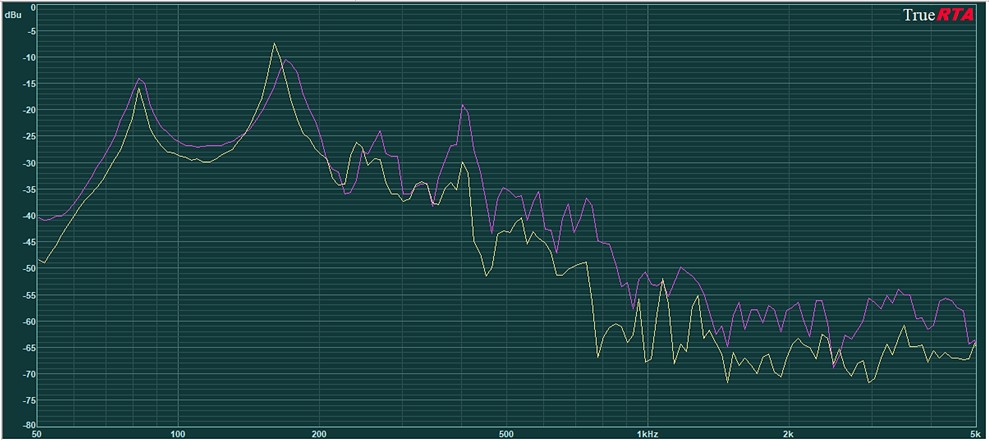

Anyway a comparison is possible with another composite guitar recently built. I miscalculated the braceless soundboard, that resulted too weak. For thi reason I added just two c-shaped balsa-Cf reinforcements, something like a "partial-falcate".
Comparing its spectrum (pink) with the previous (yellow), we can see higher 3rd an 4th peak:

Here, the "half-falcate" shows more evident higher peaks
Of course, the comparison is not solid, guitars are very different in other aspects. So the comparison is in many ways apples vs oranges...
Never the less, I think that braces do give an appreciable contribution in shaping some resonances.
But we can consider (A) the important stiffness variation that can be obtained by (B) less relevant variation in thickness, and (C) the almost negligible weight of the honeycomb core that defines thickness. Putting everything togheter, I wonder if is it possible to build a very light soundboard with an appropriate "stiffness map", simulating the effects of braces without their weight
