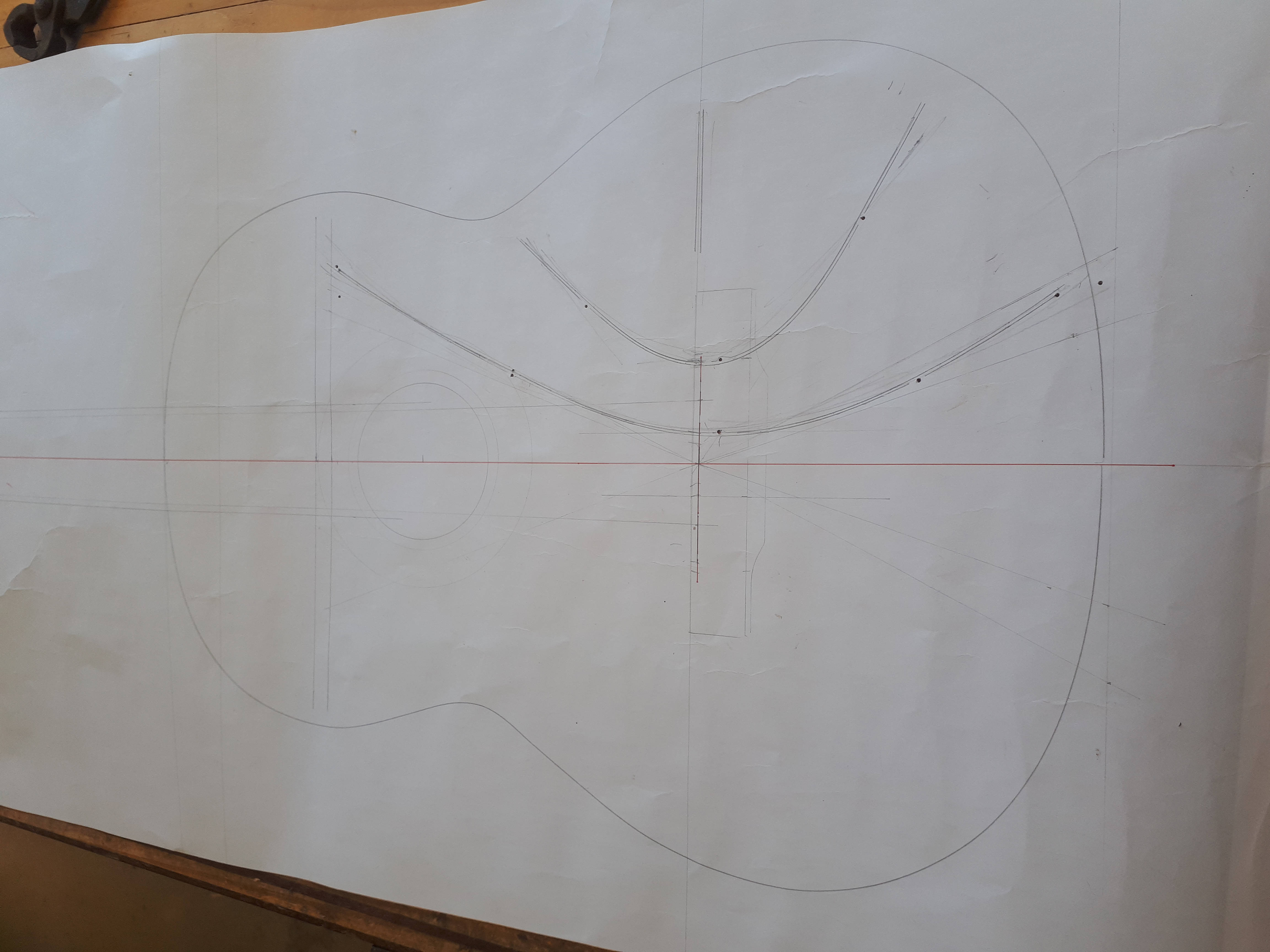

My bracing is going to be more or less the same as the steel string layout. I drafted my own but will amend it slightly. Im intending to put the lower TB in.
20200403_133723.jpg ...
The lower transverse brace even an open will make a big difference when determining the height of the falcate braces. Brace stiffness falls off by the cube of the length. The lower transverse brace effectively shortens the length of the primary falcate braces and adds in a lot of cross bracing. So your lower calculations may be correct.

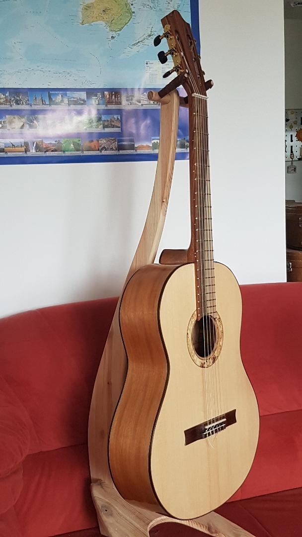

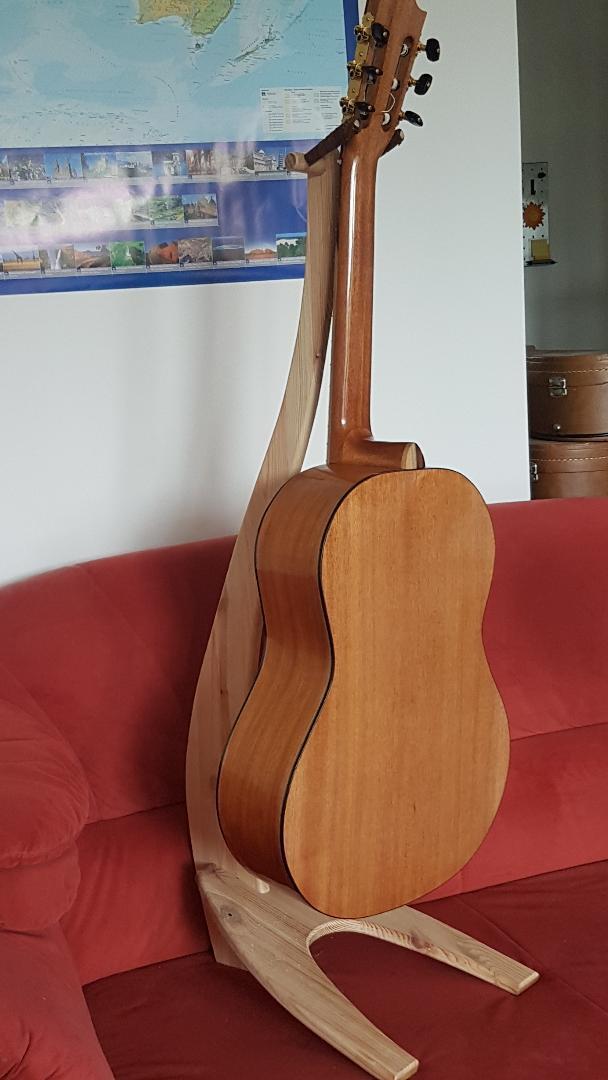

and just to finish this topic here two pictures of the guitar :

Post by seeaxe » Sun Nov 01, 2020 6:30 pm
Hi Jurgen, Hope all is well with you. Your guitar looks very nice.
