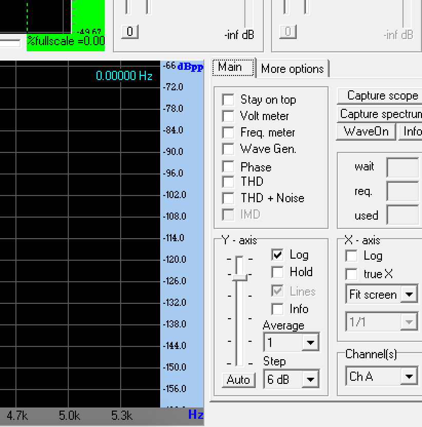

Re: VA, opening saved files
Thanks John, I’m running 9.06 and I see you are running VA 2011. In 9.06, the are only two tabs on the control box in the lower right corner. One is Main, the other is More Options, but when I open More Options, all I get is a Frequency Compensation condolence box.
- Posts: 195
- Location: Drayden, MD, USA
Here are screen shots of the lower right control panel and the panel I get when I click More Options tab

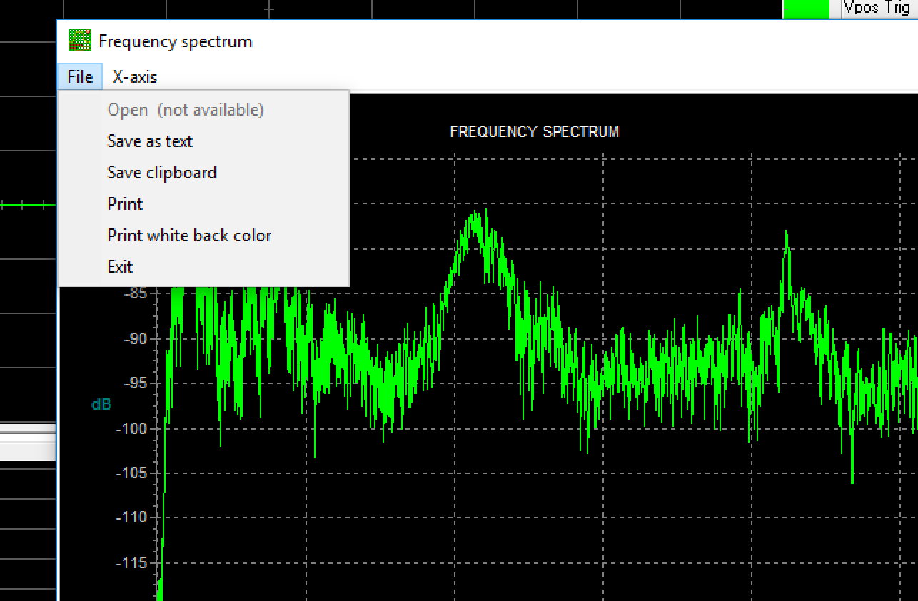

When I do that, the Open File shows as Open File (not available) and no amount of clicking gets it done. I wonder if this is because I am running VA under on a Mac via Parallels.
