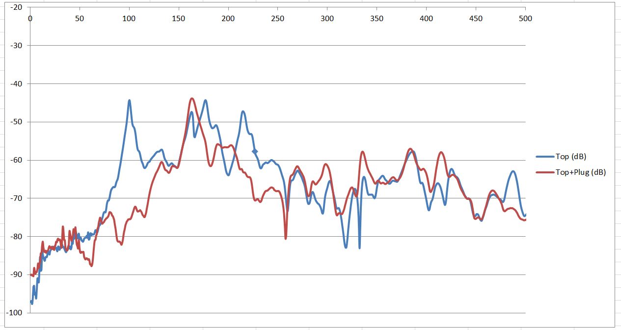

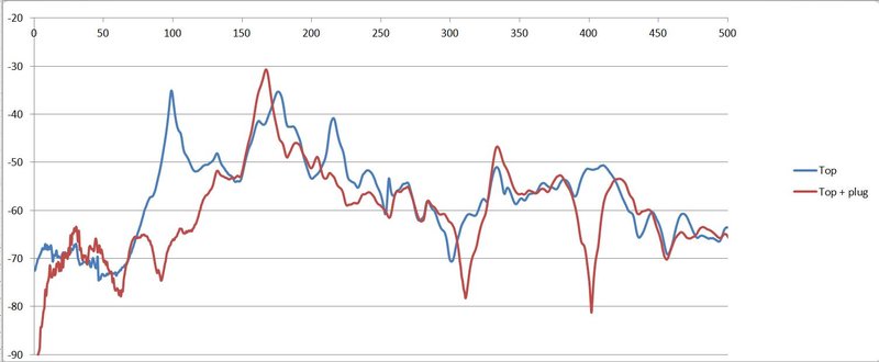

Let´s start with the frequency response.
Equipment: Microphone Samson Meteor (70cm distance from guitar)
Rubber "hammer" made from some big pencil rubber and a wooden stick with around 11mm diameter
Laptop + Audacity and VA

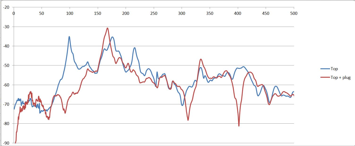

Spectra recorded with the recommended settings from Trevor
Audacity:
VA
In each graph you see the frequency response without a plug(blue) and with a plug (red). With the plug the Helmholtz related peak vanishes and in addition a peak at 214Hz (Audacity) respectively 215Hz vanishes. My interpretation: the easy case from the Book and I can directly get my uncoupled top frequency from these spectra:
VA: 167Hz
Audacity: 163.6Hz

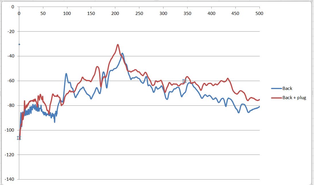

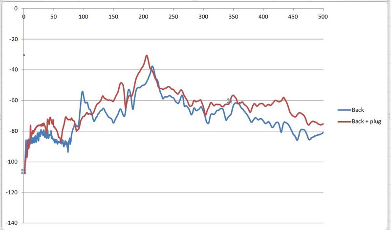

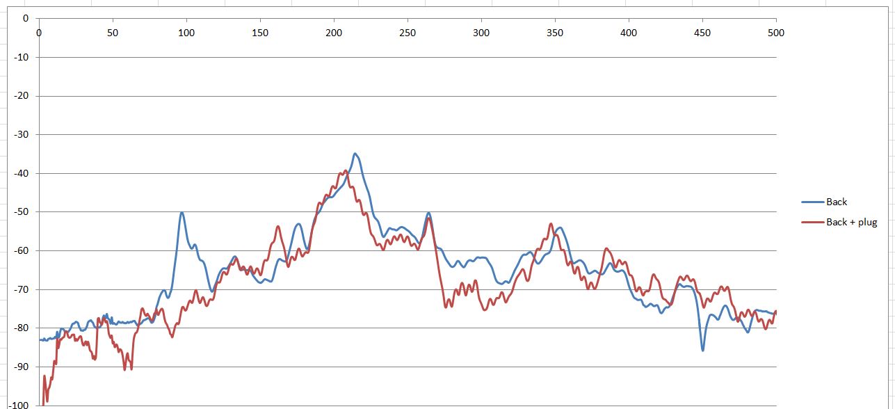

The same done with the back:
Audacity
VA
=> uncoupled back response
Audacity 206.1Hz
VA 204.6Hz
Btw. does anyone have an explanation for the "shaky" graph from Audacity which looks like I have a superposition of a highly oscillating curve?

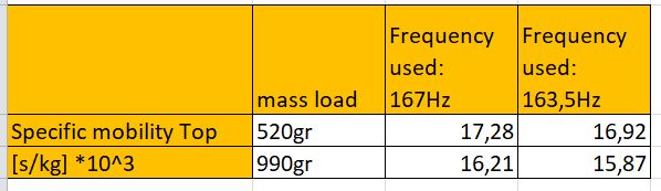

with these frequencies and the deflections I measured for the top (average over 5 measurements: 0.084mm for 520gr and 0.15mm for 990gr) I calculate a specific mobility of
specific mobility.JPG (29.65 KiB) Viewed 19372 times
Ok, when I see those values and compare them with the books... can that really be right what I interpret into these spectra??? That I accidently managed to get most of the parameters into the ballpark? There are a lot of things I would do different nowadays but as I said, the sound is (not only for me) quite nice. Anyway: If you see some misinterpretation on my side or some comments on the spectra I would appreciate to hear your opinion.

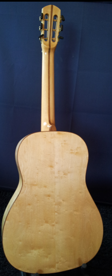

it´s a OOO based on the plans from stewmac with scalloped bracing, spruce top and maple sides and back.

I think your interpretations are all correct, Jurgen.
Regarding the "shakey" tap on Audacity, I don't know what that specifically means in Audacity. However, if you get a plot like that in VA it means you captured two taps in one buffer (rather than just the one).
Regarding the spectrum plots, if it were a guitar of mine, I would prefer the back to be stiffer. I'd be aiming for a T(1,1)2 of 170 Hz with a T(1,1)3 of 214Hz. That will give a plot with the second peak as the highest (rather than the third) and a very full, detailed response. A 000 size is more normally pitched at 180/226Hz for a more typical 000 sound. But hey, if it sounds good and no wolf notes, it's good!

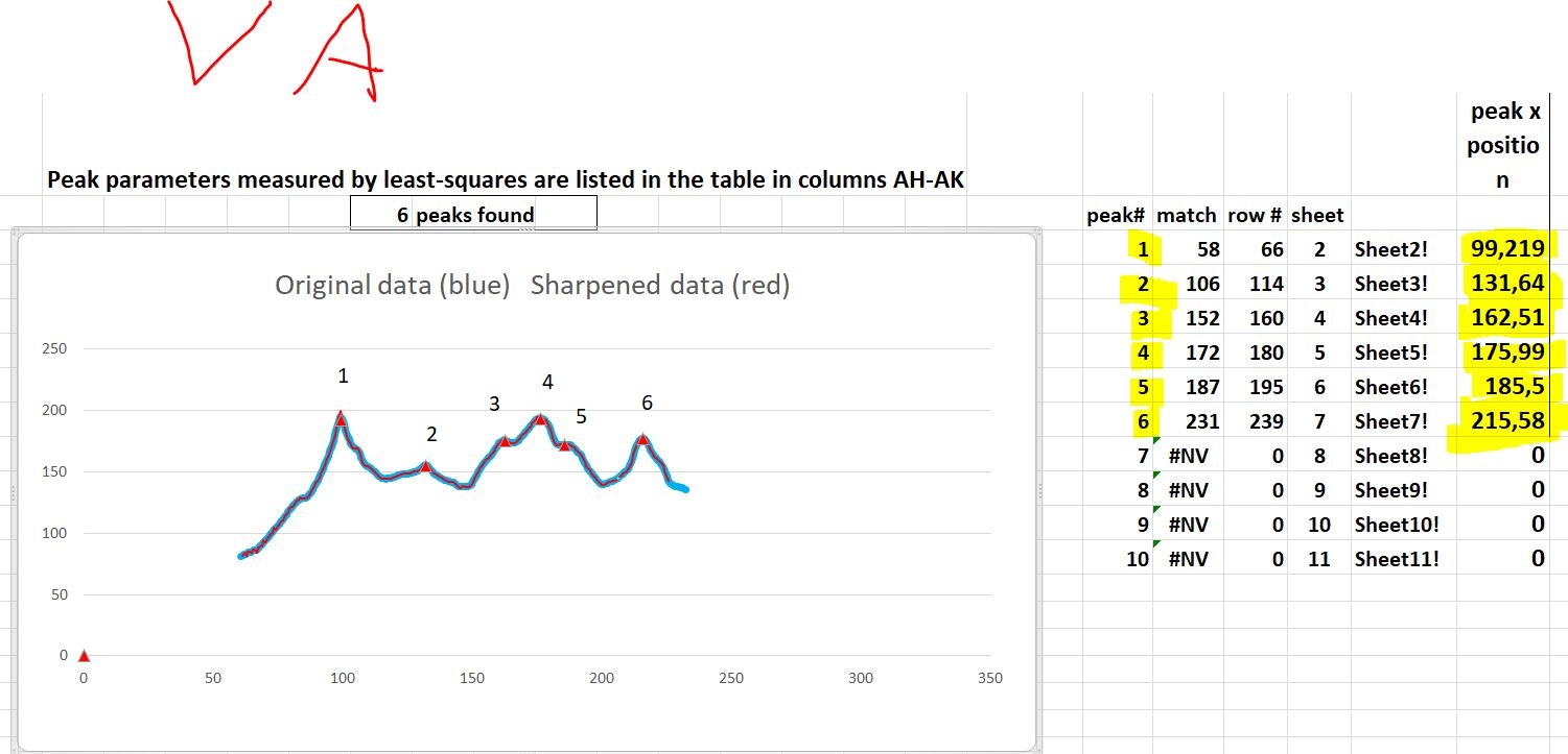

Ok, finally back form work. If Trevor always refers to the fully coupled frequencies the numbers actually are no longer as good...
the unplugged spectrum with the peak positions:
In this case I´m not only a few Hz too low. 162.5Hz for T(1,1)2 and 215Hz for T(1,1)3 doesn´t sound so good anymore. At least the new owner still likes it. Bu now I´m not sure anymore if it´s a good idea to try to reproduce it as good as possible
Trevor Gore
Posts: 1639
Re: opinion about my frequency spectra
Post by Trevor Gore » Fri Jul 12, 2019 2:35 pm
As I interpret those charts I see a T(1,1)1 at ~100Hz, a T(1,1)2 at ~167Hz and a T(1,1)3 at ~215Hz. Stiffening the back will repel the top down less, hopefully bringing it up to ~170Hz. Alternatively, a lower mass bridge would bring the T(1,1)2 up to ~170Hz and by repulsion push up the T(1,1)3 a bit. Either would get you quite close to a set of target figures. The second action would be preferable, but is likely less possible. I'm taking my cue from the VA charts and ignoring the Audacity charts.

I fear I might get annoying but I´m a bit confused so I need to ask to get the spectrum interpretation the next time right:
You write that when you talk about characteristic frequencies T(1,1)1, T(1,1)2 and T(1,1)3 you mean the fully coupled frequencies. So I have to look at the unplugged spectrum.
The "air" and back peaks easy to identify because they disappear in the plugged spectrum. In the unplugged spectrum I have three quite close peaks in this area at 162.5Hz, 176Hz and 185.5Hz. How do you identify the T(1,1)3 as 167Hz with just the unplugged spectrum?
Sometimes you can't, using just the unplugged spectrum. However, if you flip the guitar and tap the back (no need for a plug) you get a peak a little lower in frequency than the T(1,1)3. From that you can usually figure which is the T(1,1)3 in the top tap.
