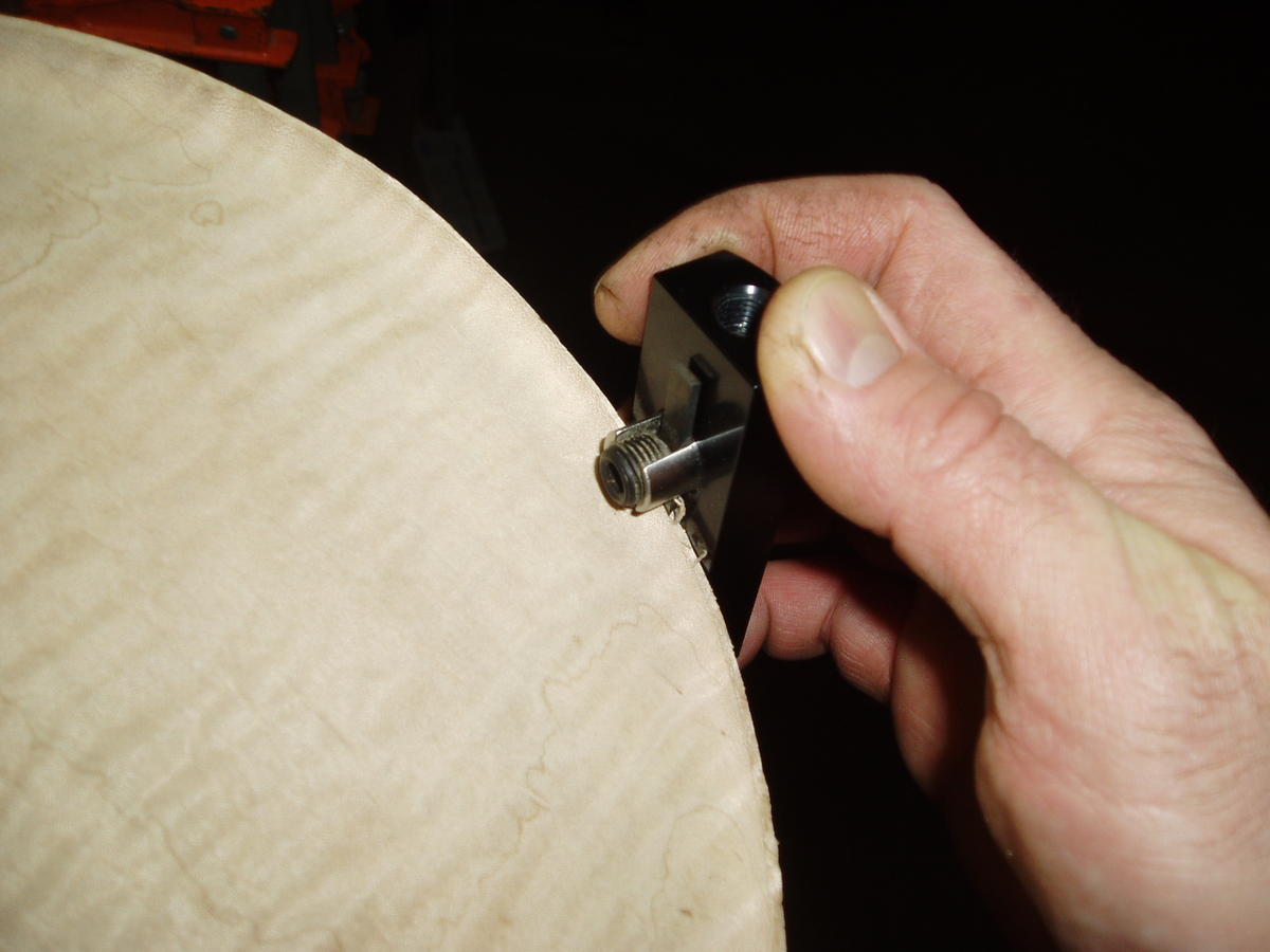

When I use the Stewmac bearing/rebate cutter setup I cut the purfling channel first and then do the binding. With the Luthiertools jig I more commonly use it doesnt matter as the jig registers off the side of the guitar well below bottom of the binding channel.
A few things I do to reduce tear out:
1) I use a new spiral downcut cutter or one that hasn't done too many jobs. For the Stewmac bearing/rebate cutter I dress the cutter with a diamond card sharpener.
2) I shellac top around periphery to stiffen up the wood fibres.
2) Direction of cuts is as per diagram in the Stewmac catalogue.
4) I do a preliminary cut with a Schneider gramil prior to cutting the purfling channel

I'm using the LMII router cutter rather than the Stewmac one. Originally, only the LMII one was (sort of) downshear, whereas the Stewmac cutter was straight. Now they are both "downshear". There may be some differences in the spacing between the bearing and the bottom of the cutting edges, too. Bottom of cutter to top of bearing is 5mm on the LMII cutter. The bearings aren't interchangeable between brands, so most people commit to one or the other.
Anyway, there are a couple of reasons for doing the binding channel first. The first is that you get to check the quality of the top cut (into the spruce panel) and can decide whether it is good enough (or whether some sharpening is in order, or a new cutter). The "downshear" cutters can be sharpened on a diamond hone. I use the blue and green DMT "stones" as pictured in the book. However, the main reason for doing the binding rebate first is that doing the purling first (especially on wide purflings) you cut away the surface which the "doughnut" rides on. Depending on the geometry of the doughnut, if it ends up with the rounded/angled part riding part on and part off the top, you get an uneven depth of cut for the binding. With the LMII cutter, the bearing is far enough below the cutter that there is never a risk of it falling into the binding rebate. At least with the geometry of my set-up. The bearings on the LMII cutter are 5mm deep. So you need a 10mm differential between the vertical depth of purfling and the vertical depth of binding before the bearing falls into the rebate. Max is typically 6mm, so 4mm of bearing is still on the side.
Regarding the router/laminate trimmer, these days I use the Makita one. Never a problem with power for a full binding cut in one hit. I use a climb cut all the way round. The Makita is variable speed, which is arguably more important than soft start, as any resonances can be dialed out so reducing the propensity to chatter. I counterbalance the router these days, as the routers I use have got bigger and heavier, and seal the spruce (or cedar) with shellac prior. The shellac is required anyway to prevent grain tear-out when removing the filament tape that I use for taping on the bindings.

Well I wish I'd read this a few days ago - assuming it had been written. I think that must have been what happened to me. My bindings came out less tall than the should have been. I thought I had sized them right so it could indeed have been the donut problem you mention. Bit difficult to see by inspection I'll have to do a test some time.
Fortunately they were only slightly out and the roundover has pretty much dealt with it, but I shall know next time.
