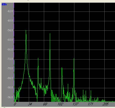

I was getting inconsistent & what I thought were questionable results with tapping so I tried to generate some patterns. On this piece I got 81Hz for Fl when tap testing which seemed too high.
I then tried to measure with Chladni patterns. I started around 30Hz trying to see Ft. I noticed that things got calmer when I increased the frequency so started going down and wound up at 26Hz to get this
I had a multi-meter connected to my analog signal generator to measure the output frequency & I also measured it with VA.
The meter said 26 Hz. VA showed peaks at 26, 54, and 81 Hz. So is is safe to say Fl is actually 81Hz?

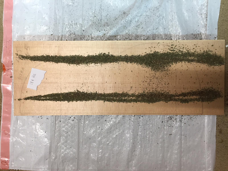

On this next piece when trying to measure Fc I kept turning up the frequency until the Fc pattern formed but the meter said that was at 184Hz. I tired to get the pattern to form around 90Hz but couldn't do it, possibly because I couldn't get enough Db out of my speaker & amp?

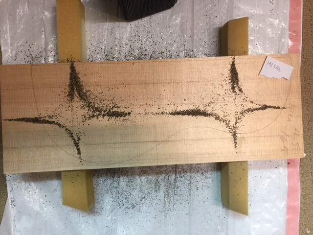

I was also able to get this pretty pattern at 142Hz, don't know if it really means anything useful.
Diamond Pattern-Web.JPG (56.16 KiB) Viewed 14315 times

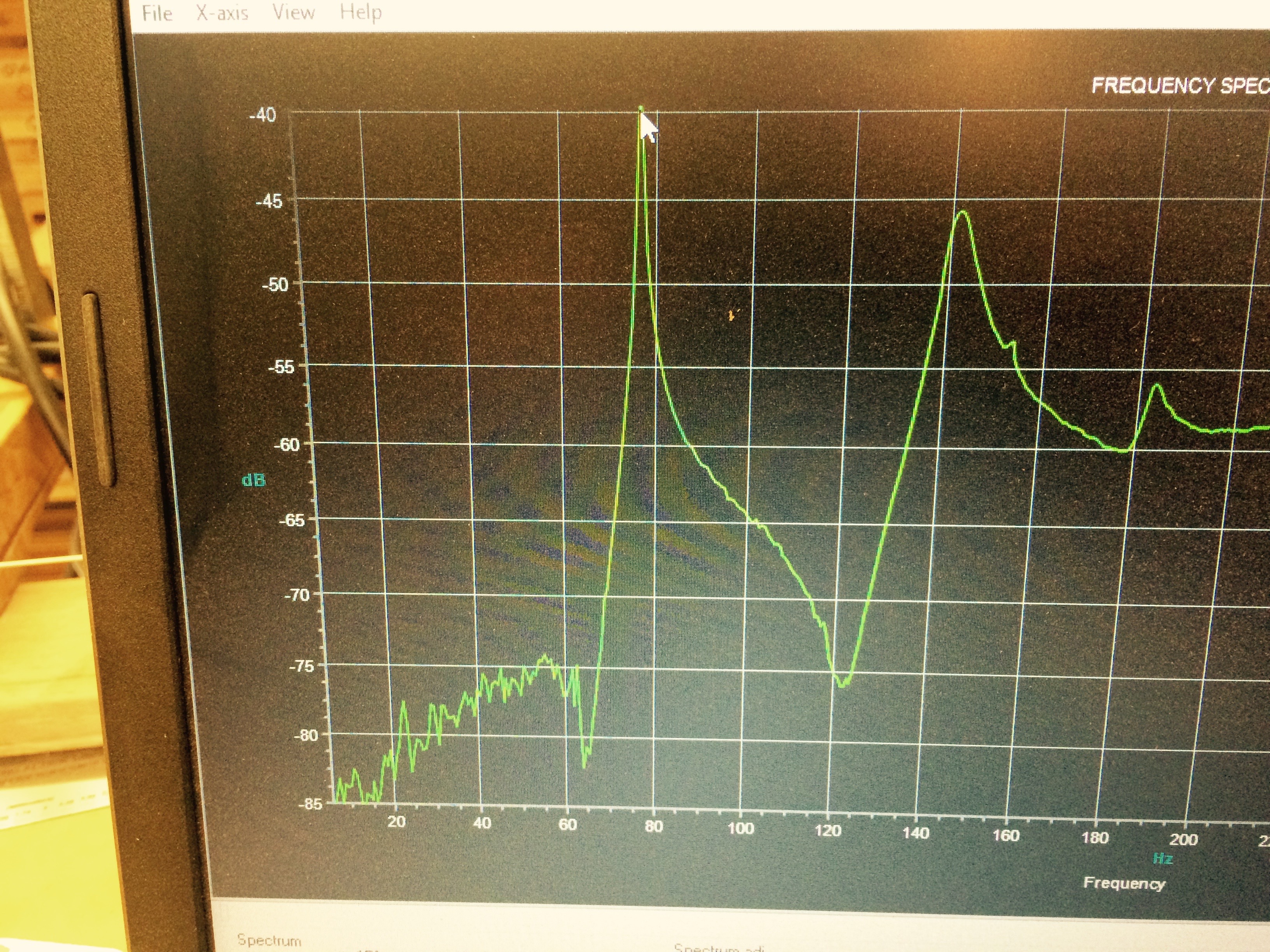

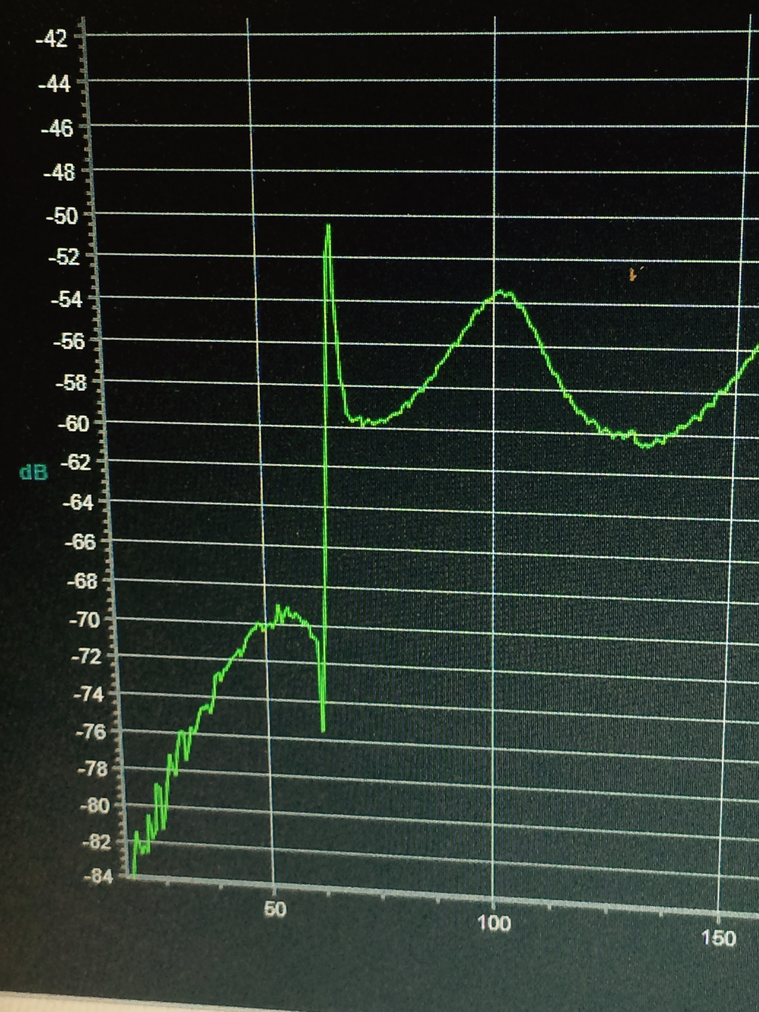

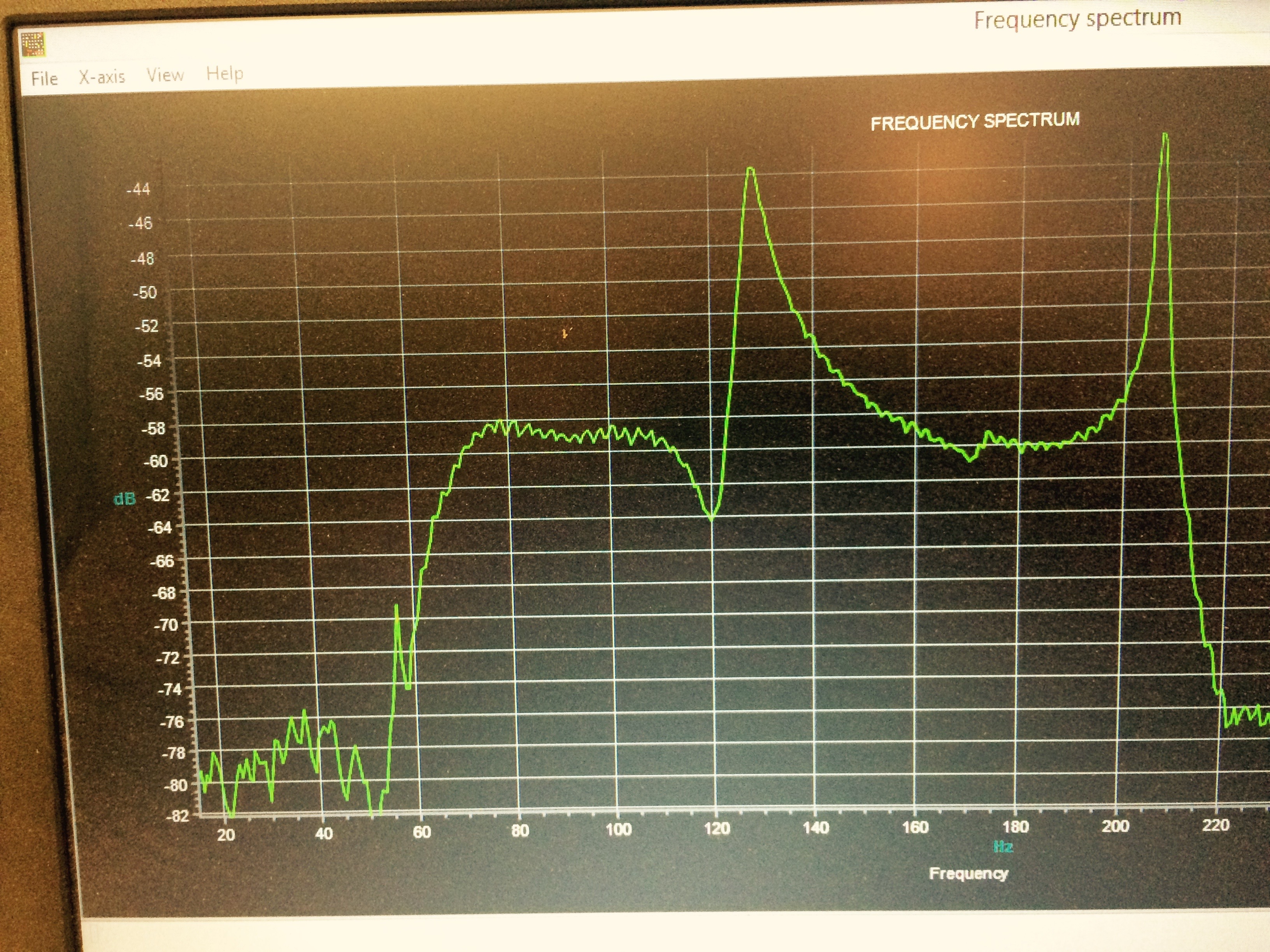

If you hold the plate at the antinode with your (pinched) fingers and tap it you should get a prominent peak for Flong, Fcross and F diag. From memory for the Sitka plates I've tested 81Hz would be where I would expect to see Flong. Here are tap test results for a Lutz Spruce Plate from my stash.
Flong (circa 79Hz)
Fcross (circa 128Hz)
Fdiag (circa 75Hz)

Tap testing the second piece gave me Fc of 122-128 Hz. The pattern shown formed when the signal generator was putting out 184 Hz. I neglected to read that into VA to see what was actually seen by the plate.
Kevin, the VA screen shows those three frequencies and they are all close to integer multiples of 26Hz. It seems that your speaker is generating harmonics of the fundamental, which is not unusual, even when a single driver is used. As you have a pretty high peak at 81Hz (or there abouts) I'd say that is doing the driving and that is what you are seeing on your panel. So the 81Hz tap result is on the money.
