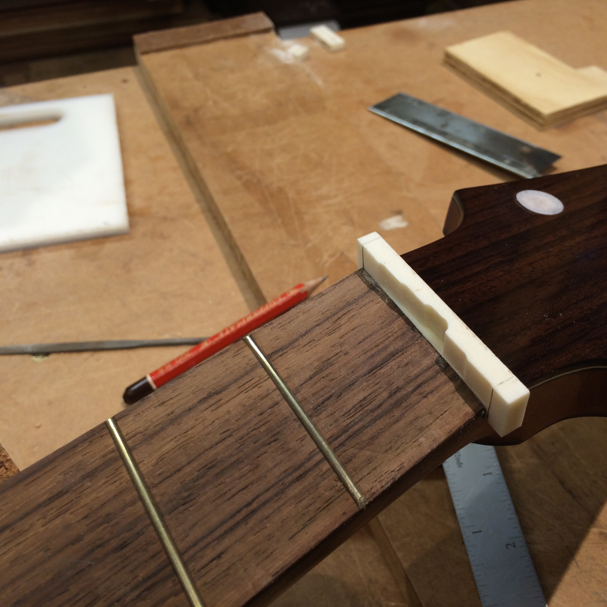

For the last few weeks Ive been agonizing over jigs and procedures to cut a compensated nut. I tried a jig with adjustable brass blocks and an end mill in a drill press. The thickness of the jig combined with sideways deflection in the drill press gave some poor results.

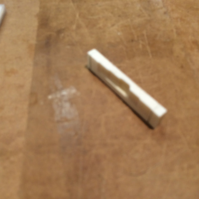

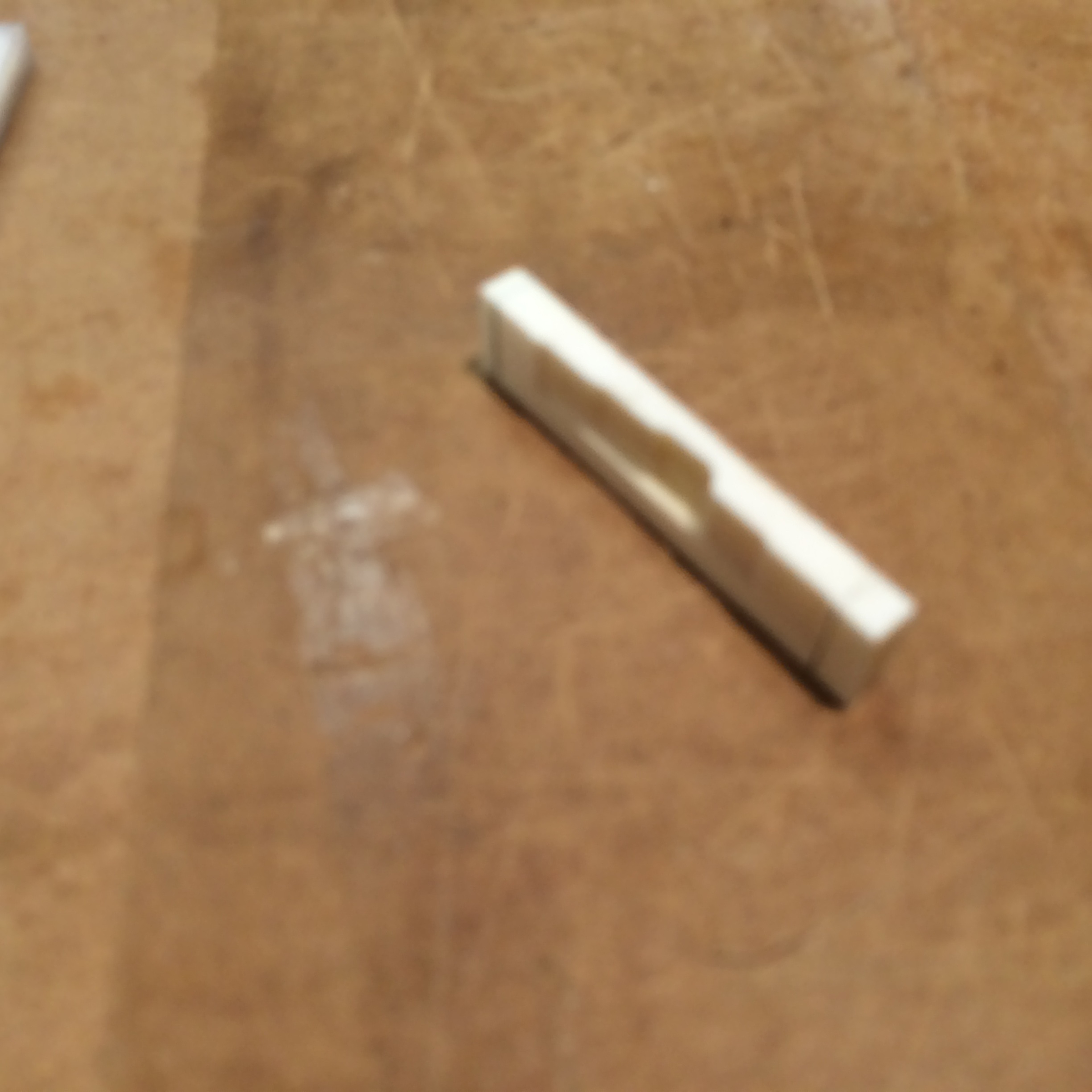

I ended up making a simpler jig from plastic chopping board along with a purpose built Dremel mini-router. Results were much better and the resultant nut only needed a bit of minor touching up with a bit of sandpaper.

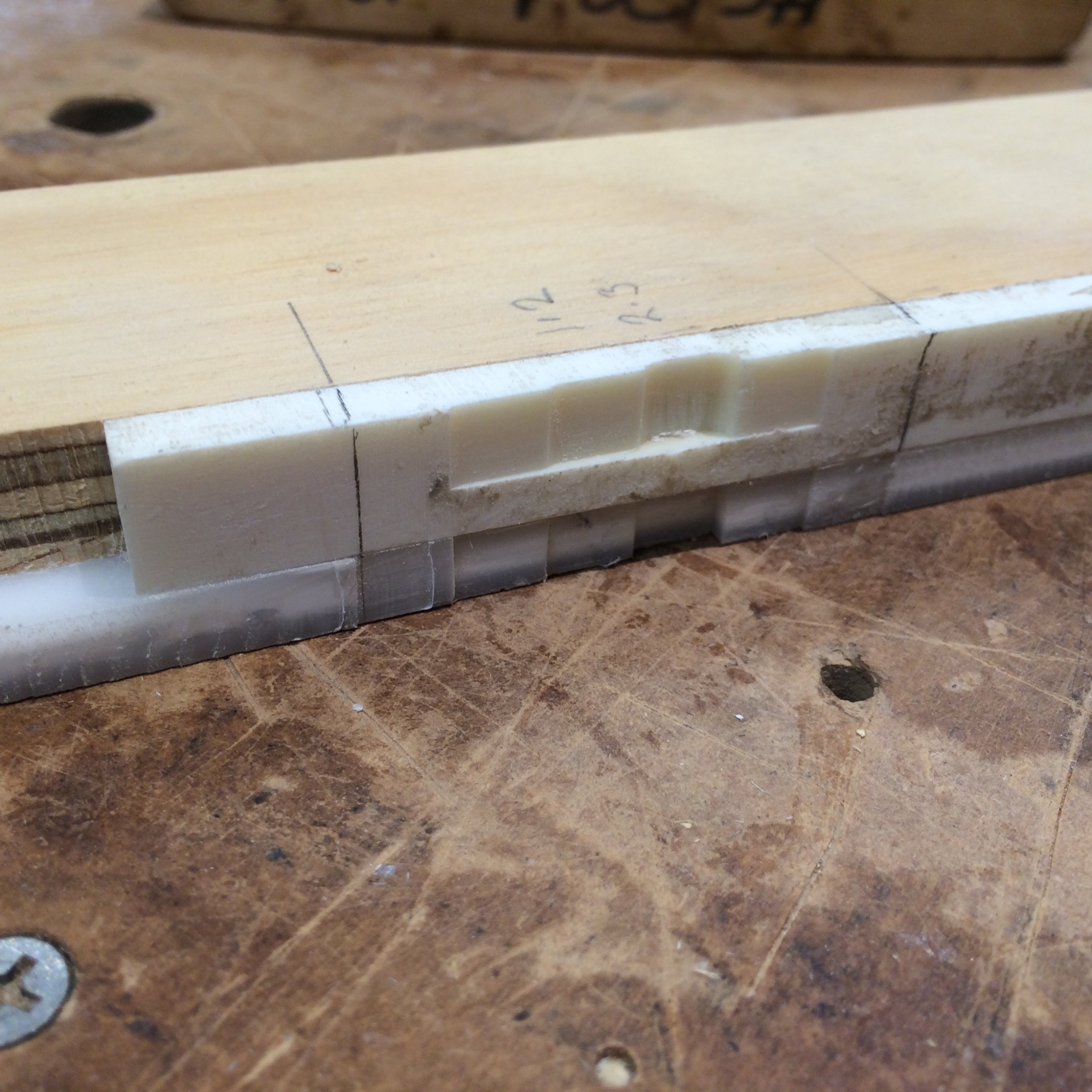

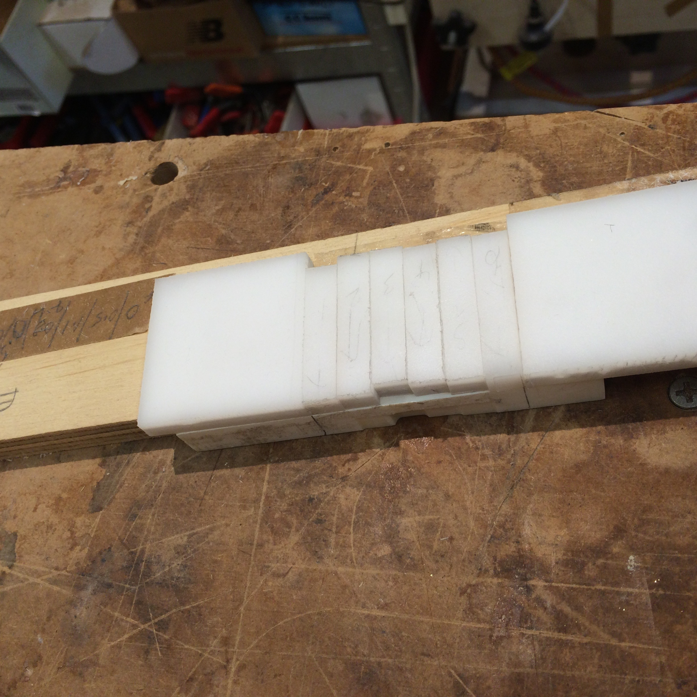

1. The jig everything is held together with double sided tape. Note the nut blank in the jig is a recycled blank from an earlier test run.

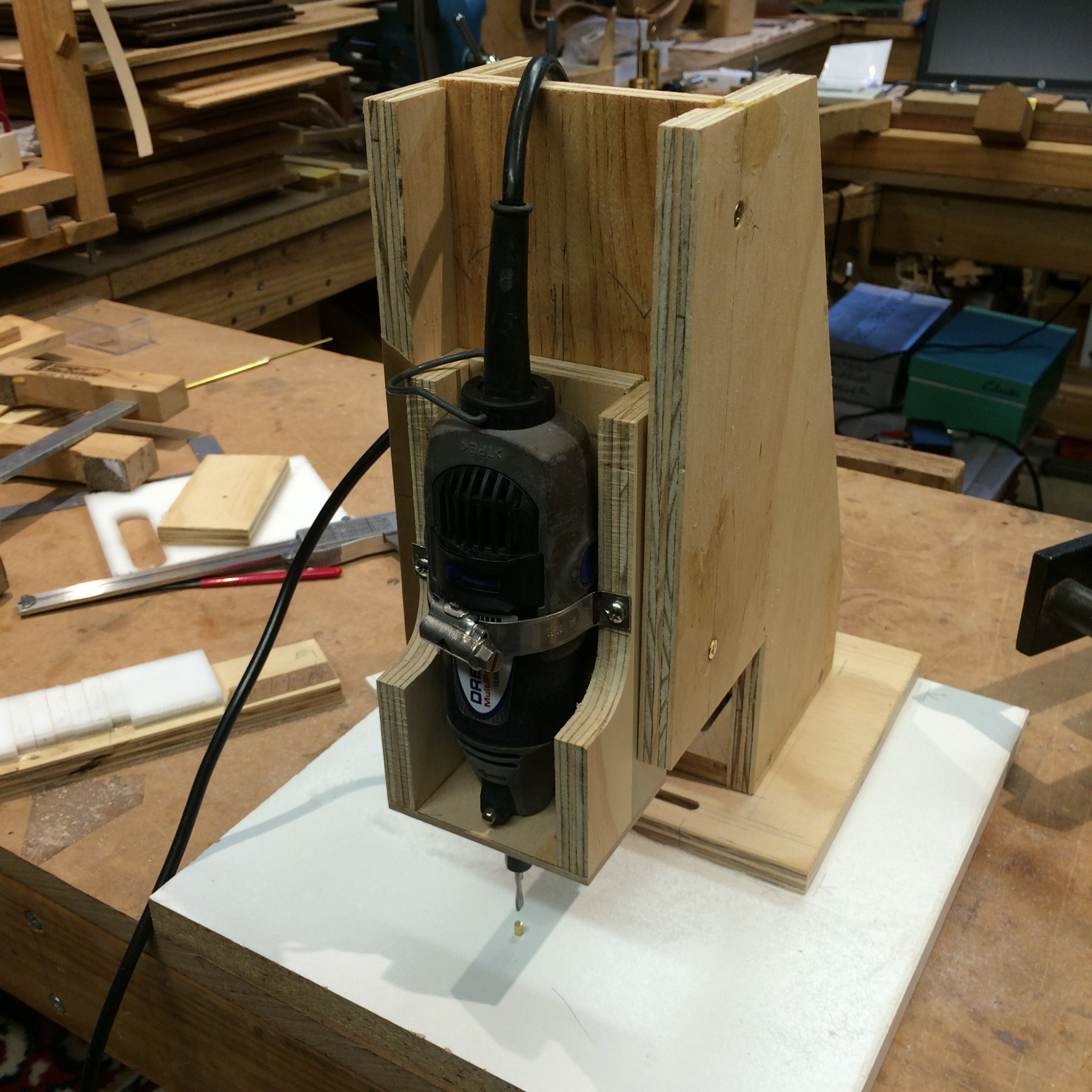

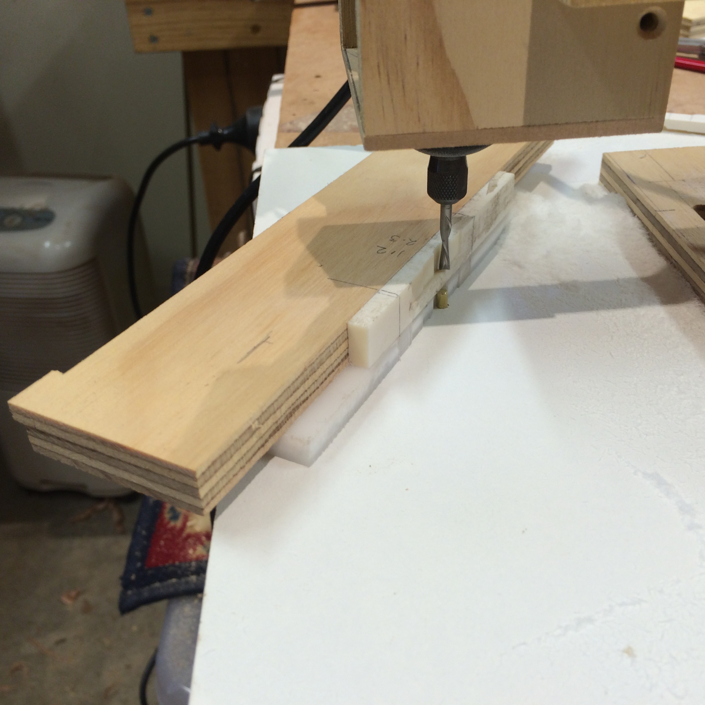

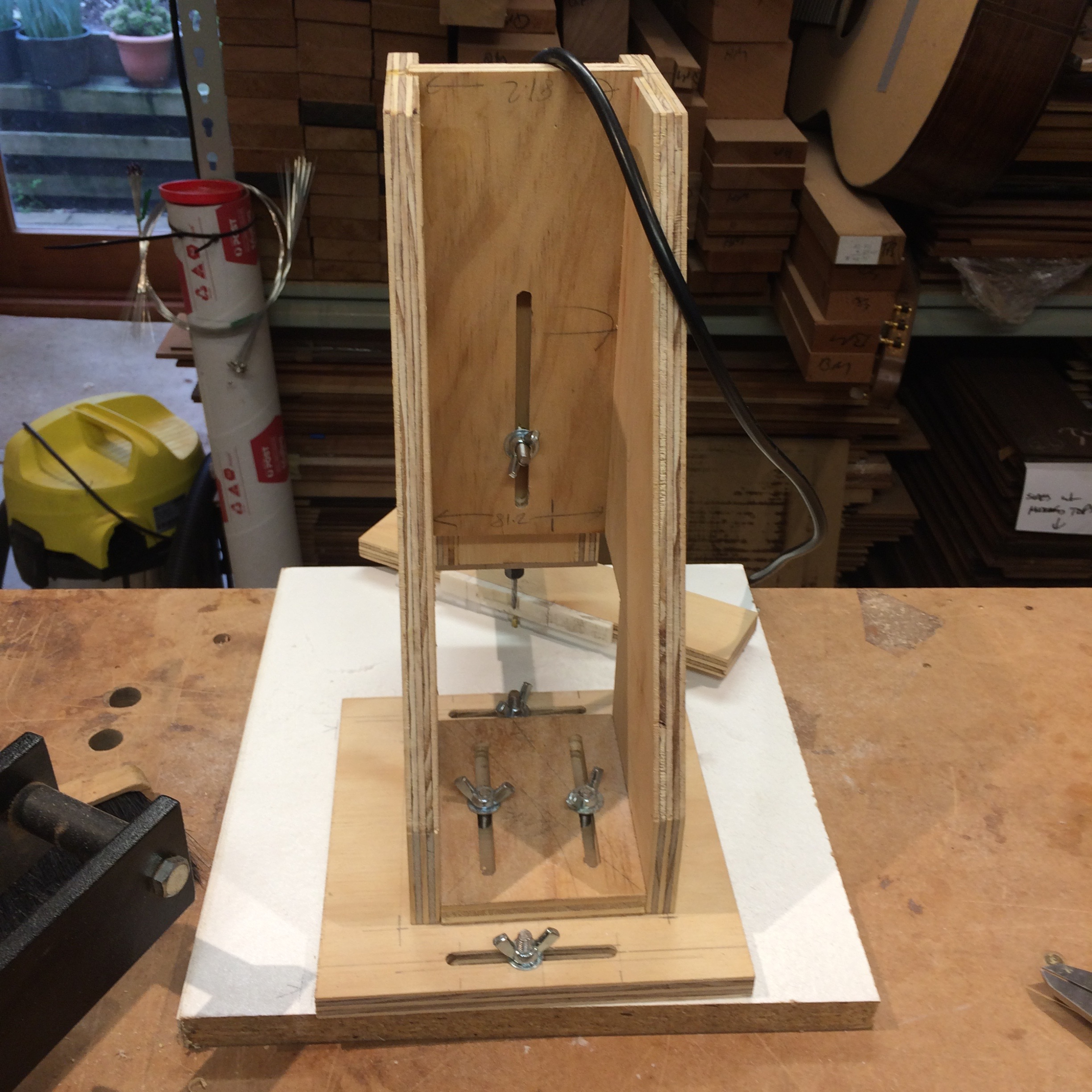

2. The mini pin router. The cutter is a 1/8" spiral downcut bit.

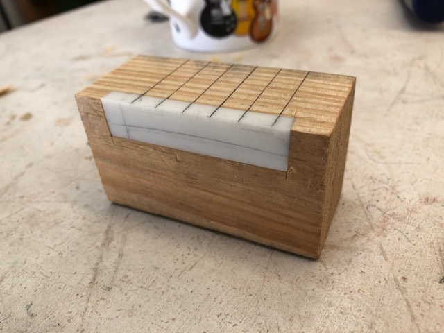

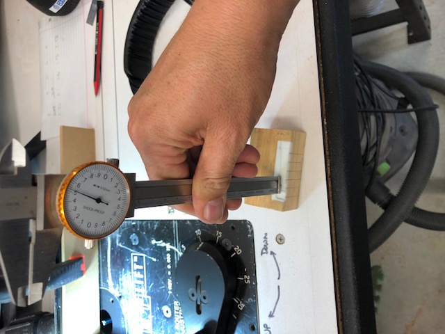

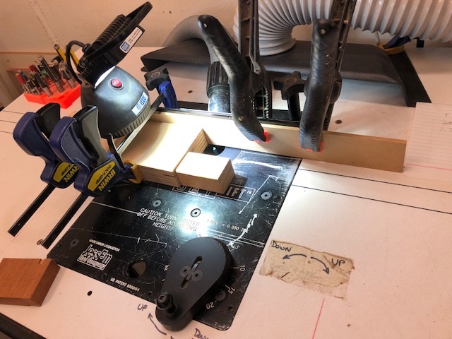

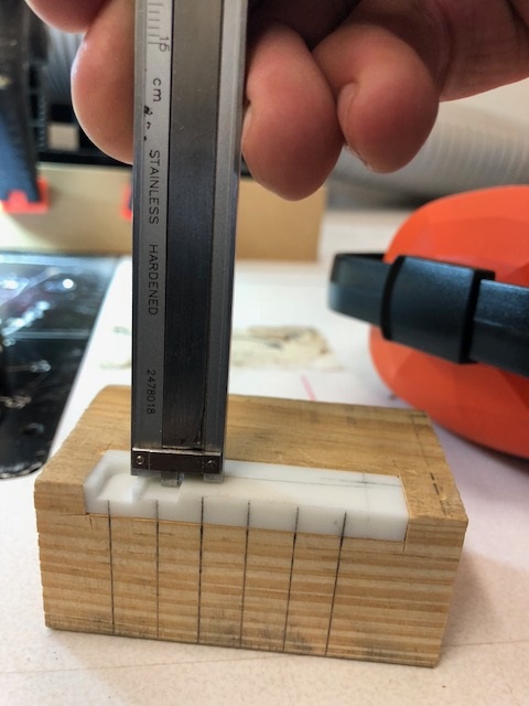

I have been frequently looking at this thread and the jig described in the book and then I've been procrastinating making a pin router jig using either drill press or dremel for a while now. But I have finally figured out a different method
The most accurate machine in the shop is the table router on which the height adjustment is 50 thou per revolution of winder. So I chiselled a relief the size of the nut blank in some scrap wood and marked the string spread. Then the first fence I set the cut to the fretboard height and the second to have the cut over the string, and simply wound up the bit until I got the right height.
I think I will make an adjustable jig to take nut blanks of all sizes, but I pretty happy with the proof of concept and the results which are now as accurate as my callipers allow...
