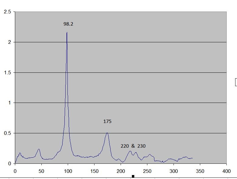

I recently finished my 1st build following as closely as my developing skills will allow the principle and practices in Trevor's book/s. I'll attempt to add a pic or two to the gallery.
I'm attaching a copy of the VA results from the completed guitar and would appreciate any help interpreting them.
1. What would make the main Air Freq so much larger than the Top Main? I've determined that I've likely made the sound hole too large, but I don't think that's what's contributing to the amplitude.
2. It appears that the coupled Freq has 2 peaks ?? Am I reading this correctly? and if so is there a likely cause or remedy that can be applied so that the 2 converge into one.

What's the scaling on the Y axis.......? I think this is why the T(1,1)1 peak amplitude looks so high. If you're using VA then plot with Y axis using dB and x axis using Hertz. Note that you shouldn't read too much into the amplitude of the peaks as you're tapping the top manually with a rubber tipped mallet and striking force for each stroke wont be exactly the same.

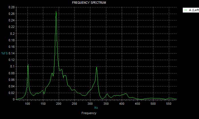

Here's one I just took direct from VA with the instrument strung up.Trevor Gore wrote:Deems, see if you can post a shot directly out of VA rather than via Excel. To convert from the .wmf file type (which the forum doesn't support) to .jpg (which it does) use a program such as Irfanview.
- Capture#1.JPG (50.21 KiB) Viewed 20617 times

It still looks like you have a linear Y-axis scaling. Choose log. (dB) as Martin suggested (check box in the bottom right of the VA window) and post another pic. Keep the linear X-axis scaling.

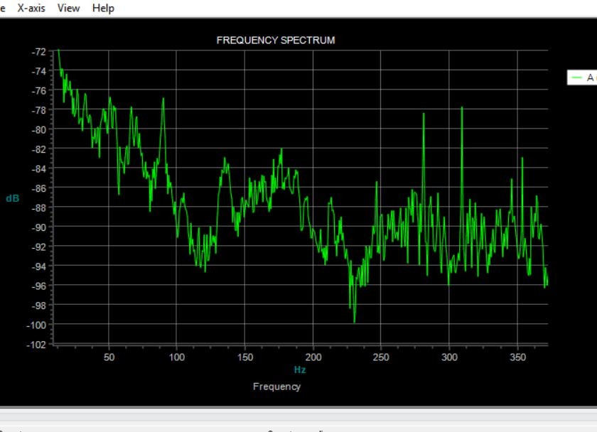

Re: Double Peak Coupled Freq Resp ?
hmmmm made the changes and repeated a 10 tap average, the results don't look anything like what I was getting before??? I must be missing something.Trevor Gore wrote:It still looks like you have a linear Y-axis scaling. Choose log. (dB) as Martin suggested (check box in the bottom right of the VA window) and post another pic. Keep the linear X-axis scaling.
- Posts: 1642
Now it looks like a signal level problem.
In the lower of your pics, move the Y-axis slider to one mark down from the top of the scale. If you then can't see the signal displayed, mouse over the Y-axis scale and move it around until you can. Where it says "Average", select 1. On the settings menu, go to the "Capture Scope/Spectrum" tab and set "Capture Spectrum" to 10 buffers. Then see what you get. You want just one tap captured per buffer, so take care with how you time your taps. If you still don't get something that looks more sensible, try reducing the input level from your mic. If that doesn't work, try increasing it. Post your best looking effort and how you got it.

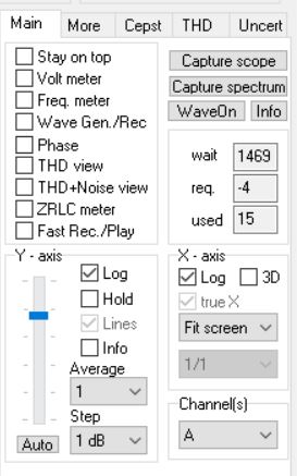

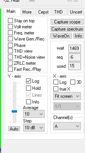

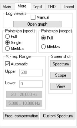

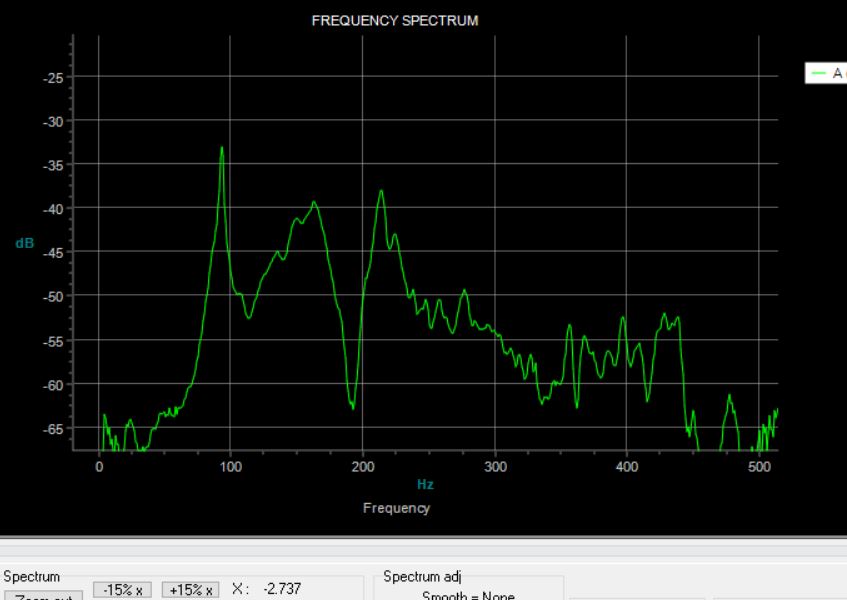

Here's another sample. Settings are as noted in the snips below Capture Spectrum buffers = 10.Trevor Gore wrote:Now it looks like a signal level problem.
Input gain adjusted from ho to low ( didn't seem to have significant effect). 10 taps on center of bridge using dowel with eraser. held aprox 2 ft from microphone. Mic is a USB " Blue" brand. After last tap click on Capture Spectrum button, wait for graph to build, zoom in on Freq's 0 - 350 hz and snip.
The graph appear to me to be VERY 'noisy' I'm wondering if this might be due to the mic I'm using.

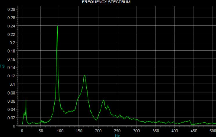

Ah ha.
I went through this, it was infuriating. Click on capture THEN start tapping at just over 1 sec intervals. When done VA will give you a new window with the captured spectrum and a phase spectrum. You can get rid of the latter by unclicking in view. Then select your region with the mouse. Also you can expand either axis to give clearer view.

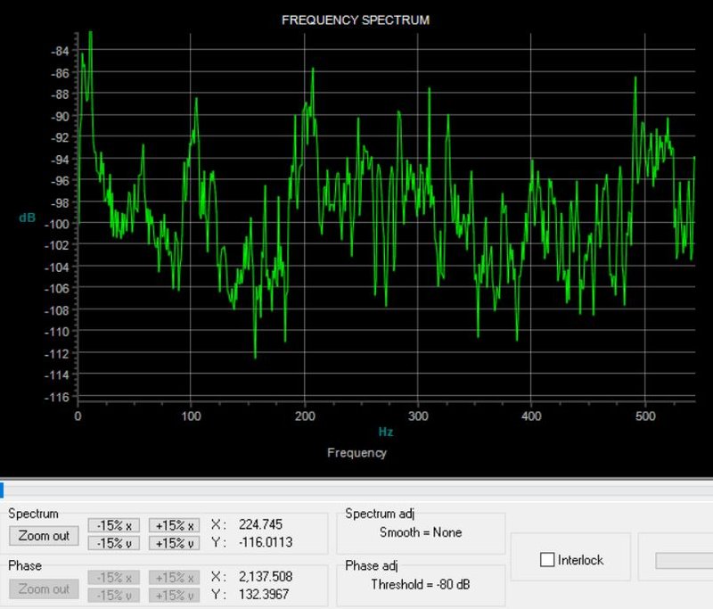

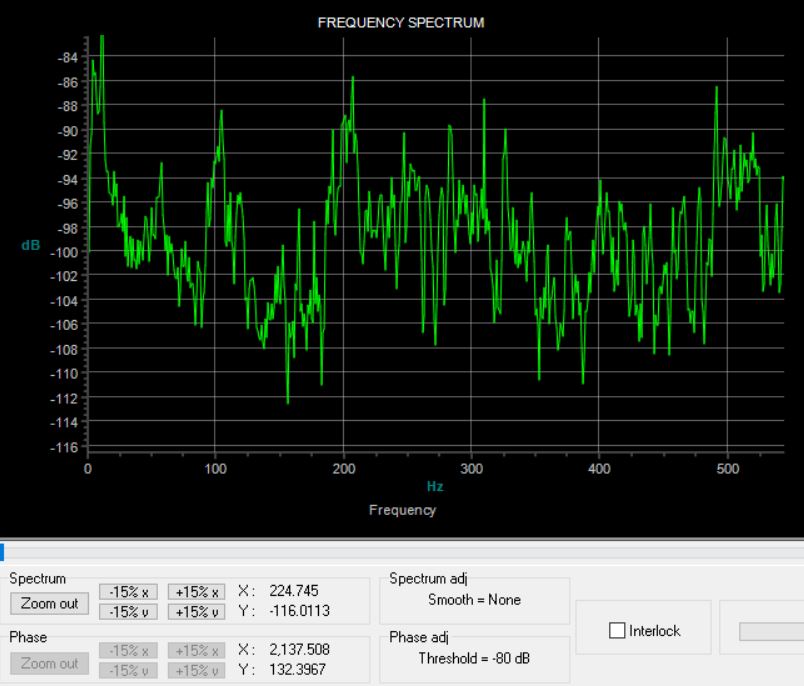

I prepared these before I saw all the other stuff from Martin and Trevor so I'll throw them up anyway. The first two are with y axis set to linear, one with mic pointing generally at the top about half a metre away. The second closer and pointing directly at the soundhole. You can see how this sort of thing affects the result. The third is with y set to log and shows the sort of spectrum you would hope to see. (this is a classical with falcate bracing.
The images are in reverse order - still haven't really cracked adding pics to posts.
- 02 log y axis.JPG (79.61 KiB) Viewed 20587 times
- 02 linear y 2.JPG (61.86 KiB) Viewed 20587 times
- 02 linear y.JPG (75.33 KiB) Viewed 20587 times

Deems Davis wrote:After last tap click on Capture Spectrum button, wait for graph to build, zoom in on Freq's 0 - 350 hz and snip.
Yep. Has to be like Dave says, otherwise you are recording nothing, which is what your signal looks like. When you click Capture Spectrum, you will see the display flicker about every 1.5 seconds (if you have the FFT and sampling sizes right (see Appendix 1, Design) and Dave's post above). You need one (and only one) tap per buffer, i.e. about every 1.5 secs. If the display doesn't refresh every 1.5 secs, you should see the blue capture spectrum bar increment every 1.5 secs. After 10 buffers (15 secs) the capture window should pop up with a display, hopefully one that makes some sense!Dave M wrote:Click on capture THEN start tapping at just over 1 sec intervals. When done VA will give you a new window with the captured spectrum and a phase spectrum. You can get rid of the latter by unclicking in view. Then select your region with the mouse. Also you can expand either axis to give clearer view.
Click on where you want the image in the message (insertion point), then click "place in line". Re-select an insertion point each time you want to hit "place in line".Dave M wrote: The images are in reverse order - still haven't really cracked adding pics to posts.

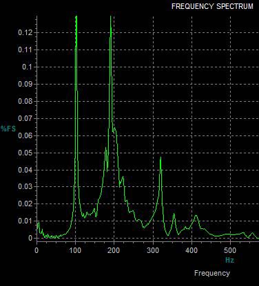

Yep. Has to be like Dave says, otherwise you are recording nothing, which is what your signal looks like. When you click Capture Spectrum, you will see the display flicker about every 1.5 seconds (if you have the FFT and sampling sizes right (see Appendix 1, Design) and Dave's post above). You need one (and only one) tap per buffer, i.e. about every 1.5 secs. If the display doesn't refresh every 1.5 secs, you should see the blue capture spectrum bar increment every 1.5 secs. After 10 buffers (15 secs) the capture window should pop up with a display, hopefully one that makes some sense!Trevor Gore wrote:Deems Davis wrote:After last tap click on Capture Spectrum button, wait for graph to build, zoom in on Freq's 0 - 350 hz and snip.Dave M wrote:Click on capture THEN start tapping at just over 1 sec intervals. When done VA will give you a new window with the captured spectrum and a phase spectrum. You can get rid of the latter by unclicking in view. Then select your region with the mouse. Also you can expand either axis to give clearer view.
Dave M wrote:

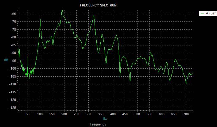

Dave, Trevor... Thanks for walking me through this. I'm consistently getting results like this: BTW what is the rationale for the preference to create the y axis using LOG? Now that I have some credible figures I need to digest these and see what it means to my build. At 1st blush T(1,1)2 @ 163 seems a bit on the low side.
Deems
- Posts: 1642
Well done, Deems. That looks like credible data, at least.
Basically, because we hear in log. The range of loudness over which we can hear is massive, so best expressed logarithmicaly. More here. (See the last table in the piece).Deems Davis wrote:BTW what is the rationale for the preference to create the y axis using LOG?
Yes. The normal ranges are in the book, of course. Tell us a bit more about the type of guitar and its construction.Deems Davis wrote:Now that I have some credible figures I need to digest these and see what it means to my build. At 1st blush T(1,1)2 @ 163 seems a bit on the low side.
