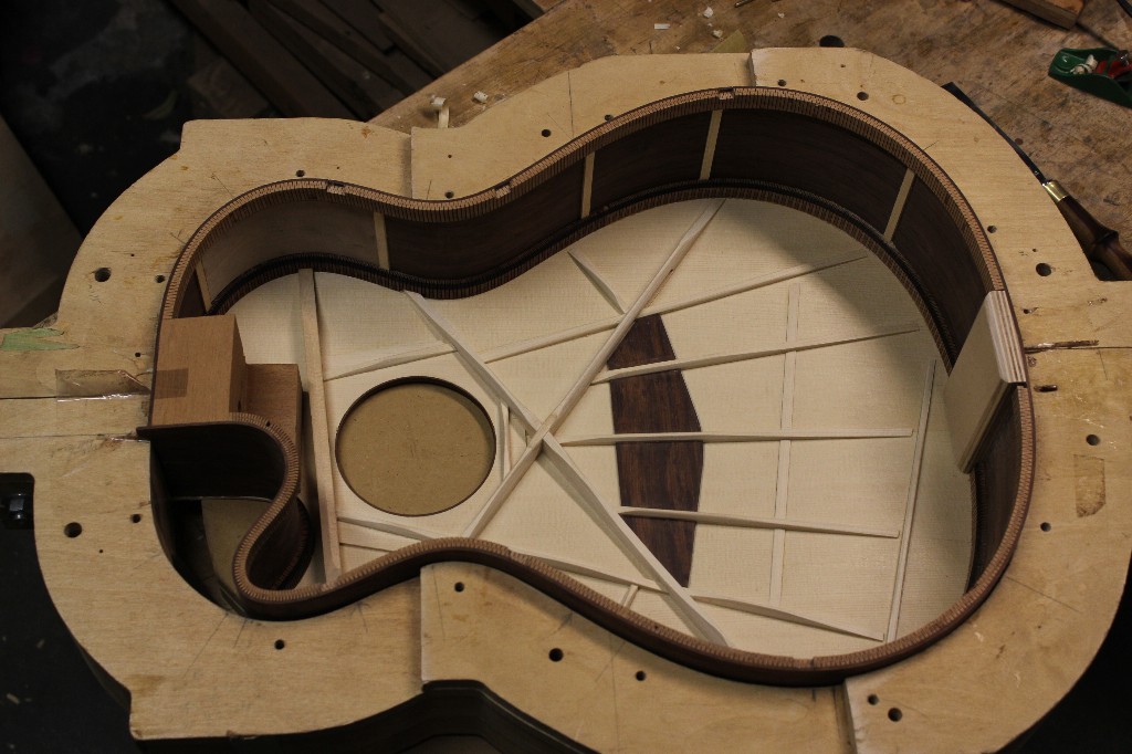

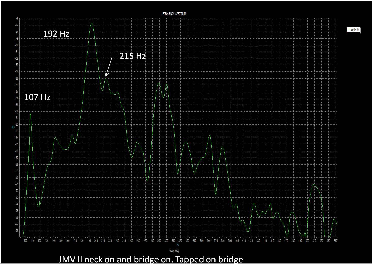

I recently closed up this guitar and it's just a few days from putting strings on. I thought I post a spectra and the bracing pattern for reference/feedback.
The bracing is modeled after Jeff Elliott's work. I've built quite a few of these and they seem to work well.
Any thoughts on the spectra are appreciated.
I used Trevor's book as guide on this one and the top came in where I was hoping. I wish the back was little stronger, but I'm afraid to mess with it as I think I'd lower it some. I believe it's at 215 but that may be something else.

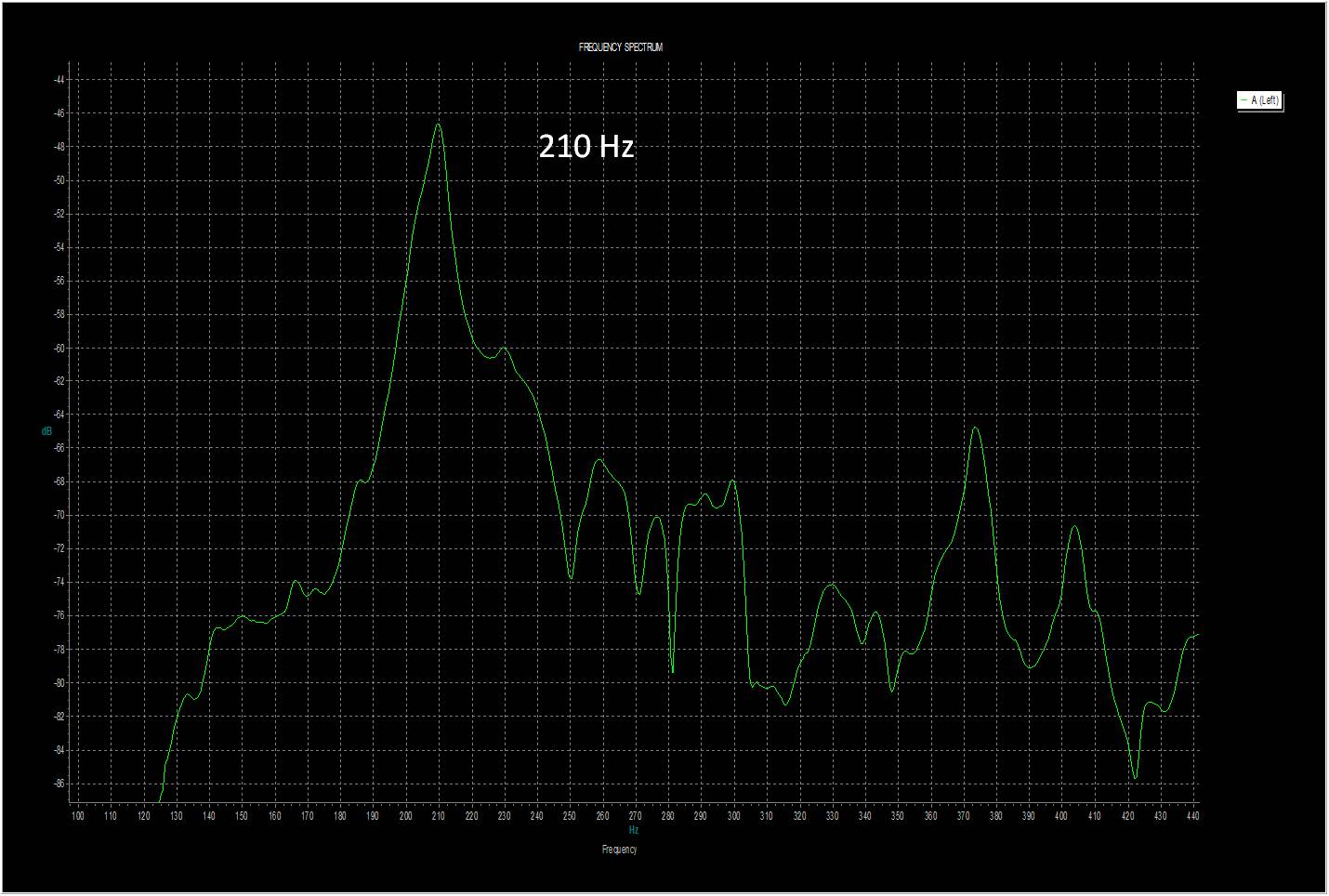

Martin, Here's it is. Tapped on the back with the sound hole blocked.

Trevor Gore
Posts: 1643
Re: recently closed box
Post by Trevor Gore » Fri Dec 11, 2015 10:54 pm
It looks like you've got a live back guitar, Jim.
Ideally, I'd be wanting more separation between the T(1,1)2 and the T(1,1)3, because in my experience that gives greater clarity and separation. But if you like the sound (and having built a few, you should know!) why mess with it?
If you do want to mess with it, I'd approach it by reducing the T(1,1)2 frequency because that's fairly high and you have a goodly amount of bracing in there. If you can get it down to 180Hz (by taking out stiffness) you'd hear a big difference. Whether you'd prefer the sound it is another matter, but you'd get a firmer lower end and greater responsiveness.
