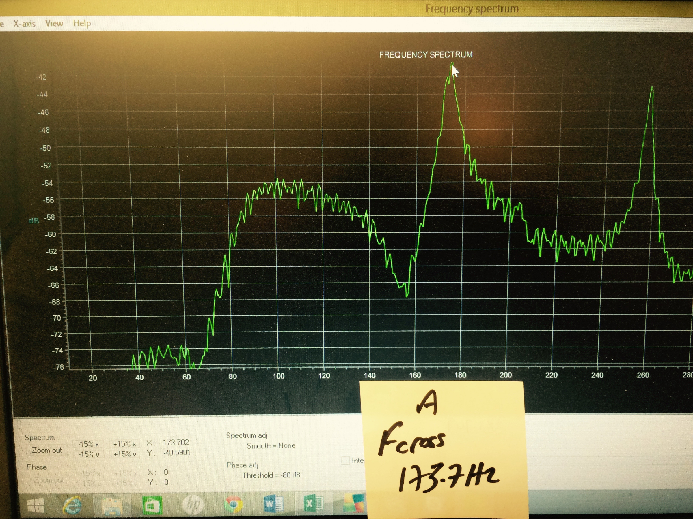

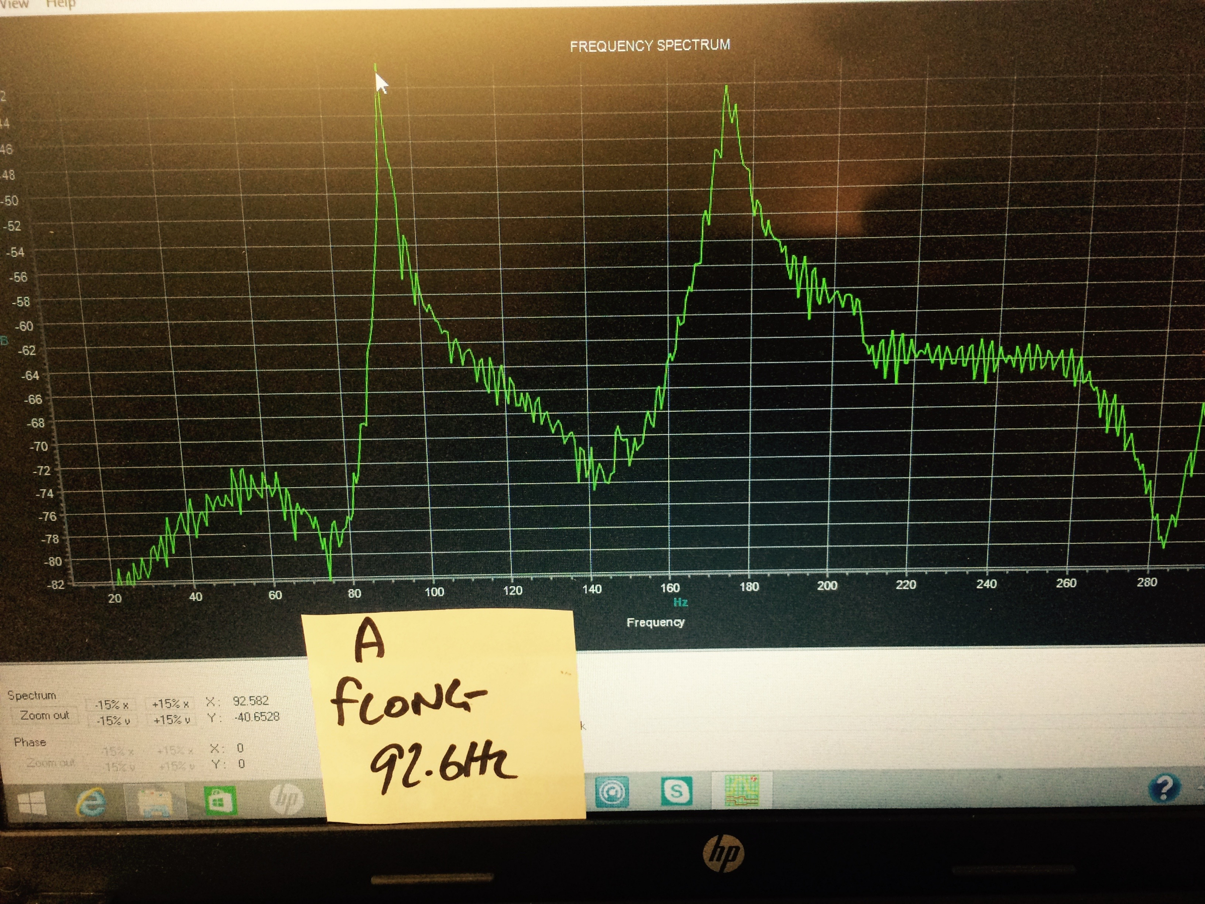

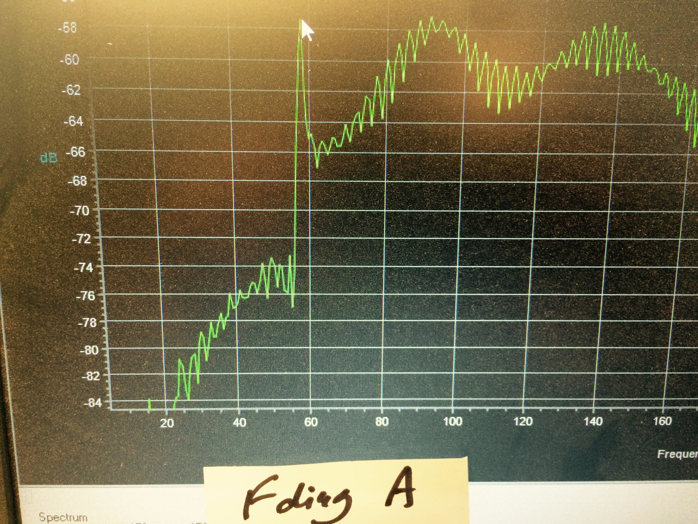

Doug can you post up a VA screen shot of one of your cross grain tests?

I'll post something when I get a spectrum that is a little less grassy. I tried doing one this morning, but the level of background noise was just too much. And I found I had forgotten how to copy a spectrum to post. I needed to get to work so the "Ah, f#@k it. Do it later" impulse won out.

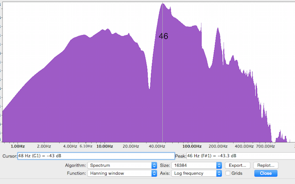

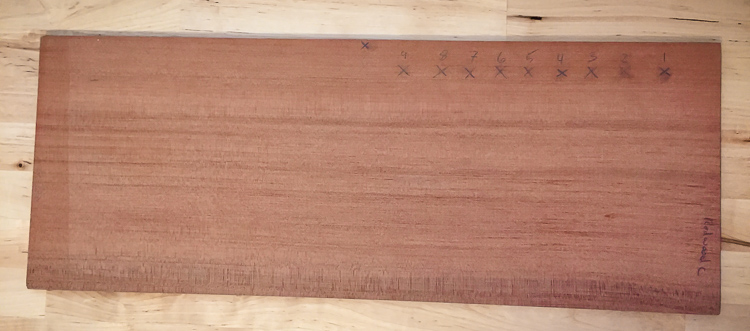

I got a little thorough with this. I wanted you to be able to hear what I'm hearing as I work down the "line" between the Long and Cross nodes. Long Grain and Twisting have always been easy. It's the Cross Grain that I have trouble discerning, which is why I'm thankful this thread was here.
I took a lot of screen shots of the graphed results and recorded the clips of my taps. Hopefully I'm presenting it in a way that's easy to understand. I'll post the Twisting, Long Grain, and Cross Grain results independently of each other, and I'll start by showing you how I set things up.
Here you see the positions where I held the top as I tapped: 1-9, excluding the Twisting node, which you see as the X at top center. Physical data for the piece:

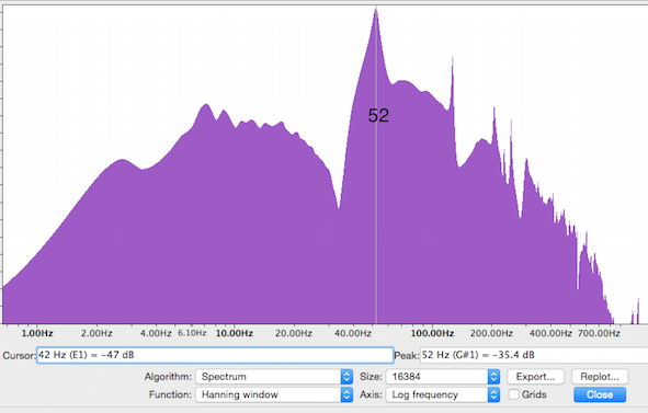

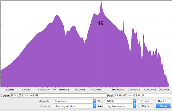

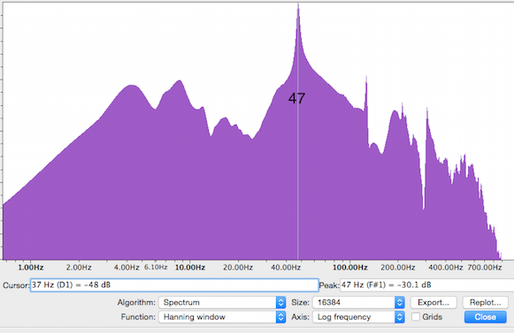

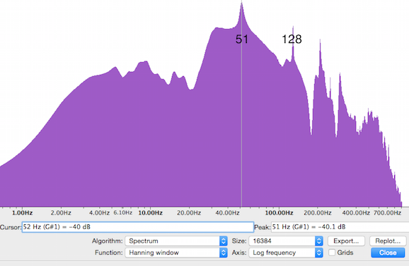

Long has also been straightforward. I get a clear tap, and clear results on the graph. I'm confident saying the long grain on this is 47hz. In the recording, the tapping results seem best in positions 1-5. Positions 1-3 located right around where they should be as seen in the book (Build pg. 6-7).
Long Grain Audio clip on SoundCloud
Results of the long grain taps in positions 1-8

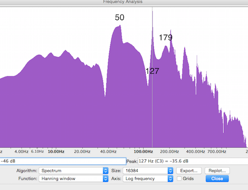

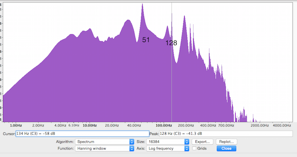

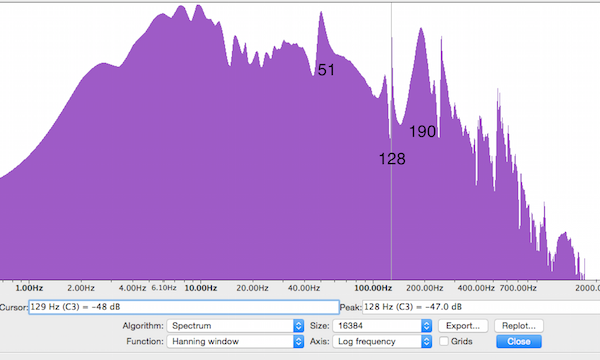

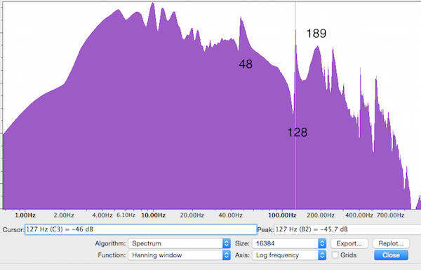

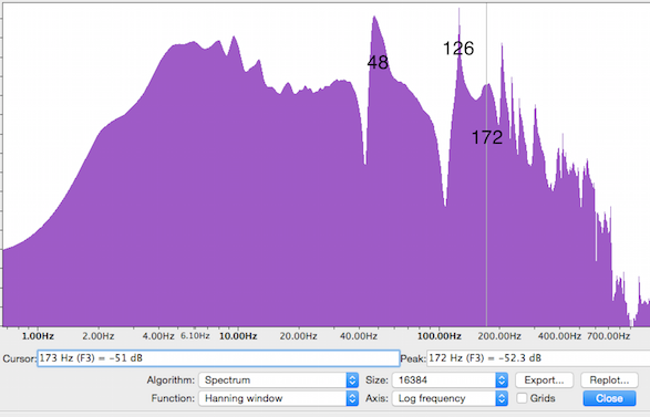

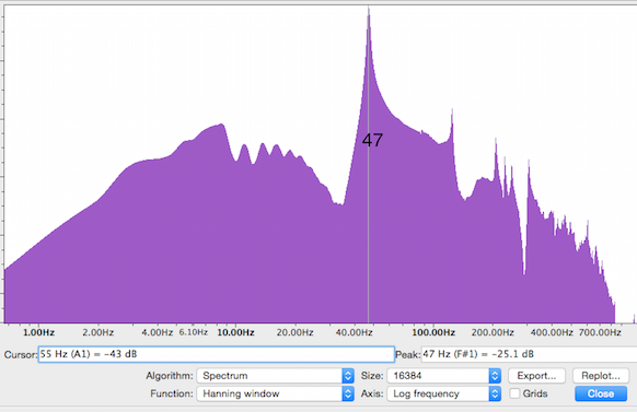

Cross is where I run into trouble. There isn't an obvious peak that jumps out as the leader. It seems like it could be 50-ish, 125-ish, or 175-ish. The clearest audio results were when I held it in positions 5 and 6, which correspond best with where that node should be as pictured in the book (Build pg. 6-7).
Cross Grain Audio Clip on SoundCloud
Results of the cross grain taps in positions 1-8

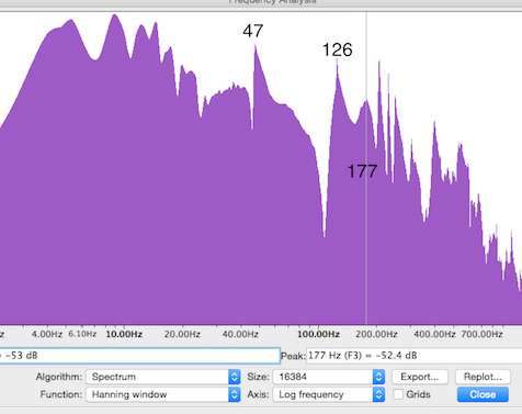

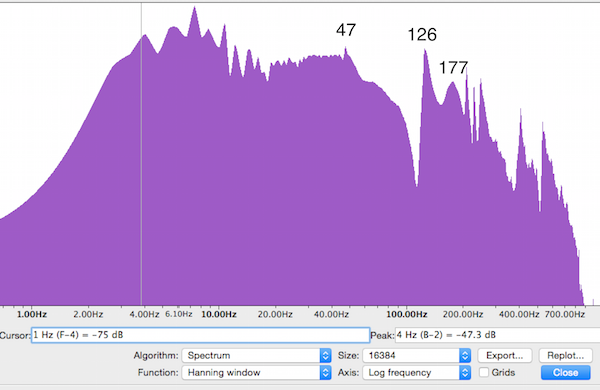

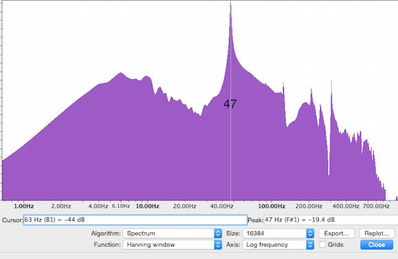

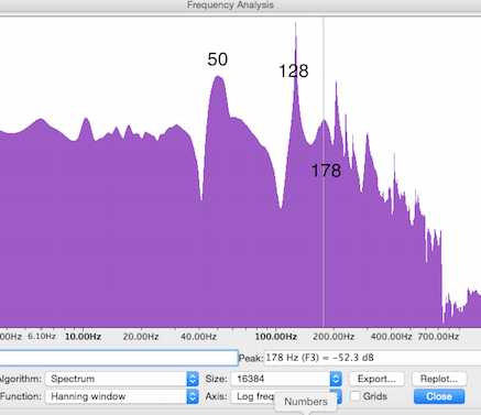

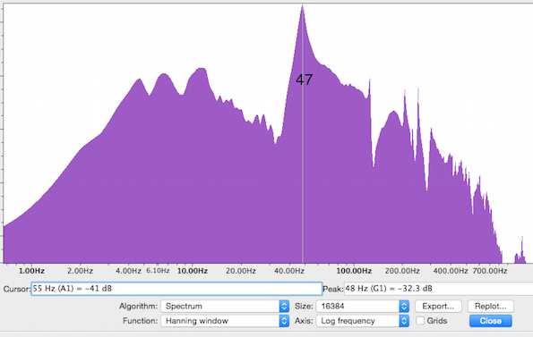

Here are some VA plots for tap testing I recently did on a top set......I think it was Swiss Spruce.
Along grain Across grain Diagonal

I'd like to know how to interpret the graphed results. How do I know which peak is the winner?

Hey Woodsy. I had Build open when I did these today. I marked the X's where the top became the most resonant and rang like a bell. In the book, Cross is further down the board, but I think it looks like it's in line with the Long?Woodsy23 wrote:James,

How do you know which peak is the one? You know roughly where the peak should be (see G and G for typical values) and you're looking for the first clear peak....as in the plots I posted up. Ive done over 100 spruce tops (Sitka, Lutz, Swiss and Engleman) and the visual pattern of the peaks is very consistent. For example the diagonal peak is always a very abrupt sharp peak and the cross grain peak is always preceded by a broad "hump".
Re: Cross-grain tap test advice?

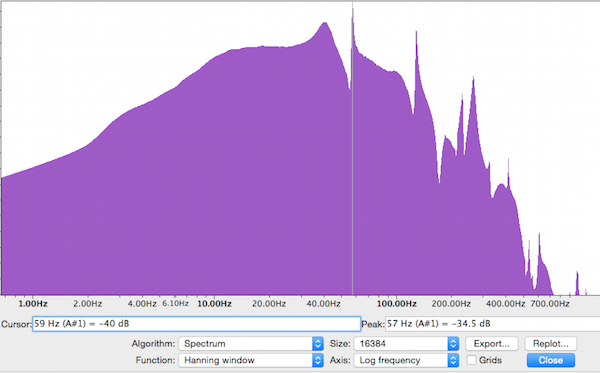

Ok for the diagonal test but you definitely need to move in a bit further for the cross grain test. On your plots it looks like your diagonal is showing up at around 50Hz which confirms youre holding too close to the long edge.Woodsy23 wrote:James,
I haven't got the books with me at the moment so I can't check but my recollection is that the point where you hold the board to generate the cross grain vibration is further from the edge of the board than indicated by your marks. I may be wrong but it's worth checking the books.
Start about 1/3 of the way across the board and then work back to the edge until you get a nice peak.

JamesJamesO wrote:Cross is where I run into trouble. There isn't an obvious peak that jumps out as the leader. It seems like it could be 50-ish, 125-ish, or 175-ish. The clearest audio results were when I held it in positions 5 and 6, which correspond best with where that node should be as pictured in the book (Build pg. 6-7).
There seems to be alot of noise below 50Hz and alot of it is of higher SPL than the tap test peaks.
What sort of plot do you get if you just record with mic open and without tapping the wood? You're in the US arent you? If you were in Australia Id get you to check that the peak at 50Hz isnt AC hum....I pick it up through my pre-amp if its too close to the power pack of the laptop.

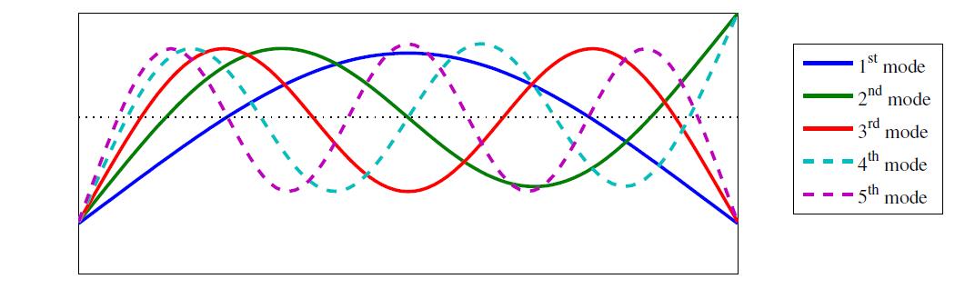

Here is a diagram of the vibration shapes of a free bar. The dark blue is the first vibration mode (what you are tyring to measure). You can see that, in this mode, the point that doesn't move is at about 23% of the length from the end. When trying to measure the cross grain frequency, the trick is to hold the board at a position along its length that eliminates (or at least reduces) the long grain vibration. I think that is at the mid length of the board but check the book.
So, if you have a board that is 650mm long and 200mm wide, you should hold it between your fingers at a point half way along (325mm) and 23% of the width (46mm) from the edge.
