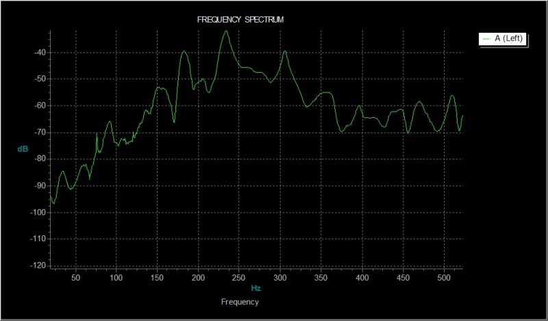

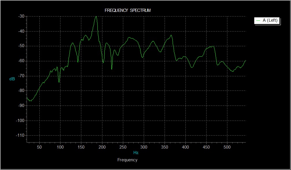

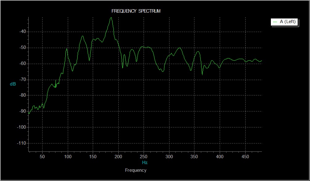

Trevor,

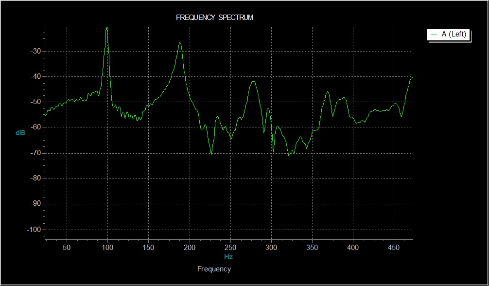

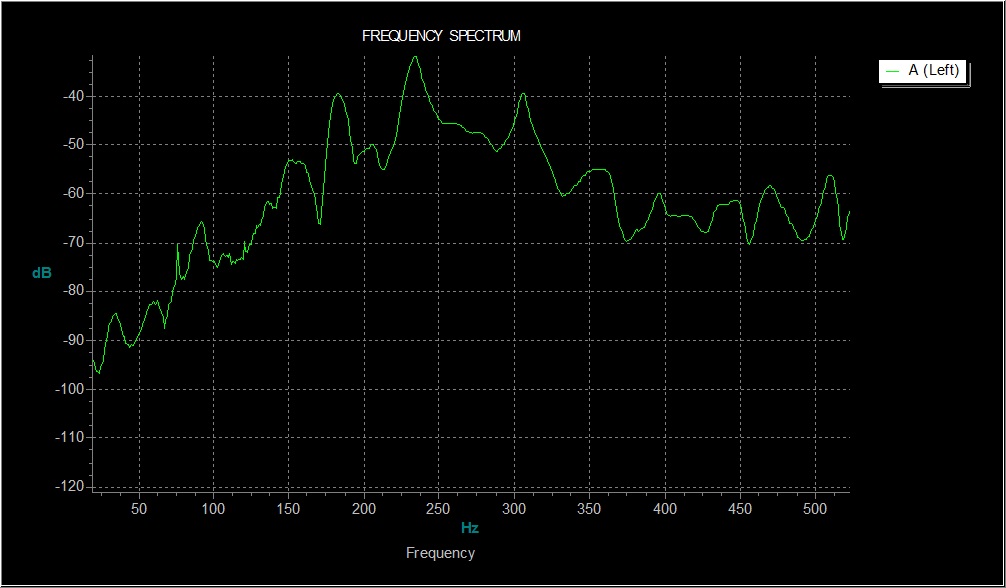

After completing my first acoustic guitar, a 12 string X-braced, I have now jumped in at the deep end and am attempting the falcate braced steel string with cutaway and live back from the plans in your book. The shape/dimensions are pretty close to your plans with just the upper bout and cutaway slightly modified.
The back and sides are East Indian Rosewood, the top is Engelmann Spruce and all the bracing is sitka spruce with the falcate braces 7mm high. You, Peter Coombe and others have already helped me out with a problem I had gluing the EIR back join. viewtopic.php?f=1&t=6622 and you have provided useful advice on top stiffness viewtopic.php?f=33&t=6596
It is all going reasonably well and I am now I have closed the box and done some initial tap testing to determine the current resonances without the bridge and neck.
This plot is for tapping the top with the top facing the microphone This plot is for tapping the front with the back facing the microphone This plot is for tapping the back with the back facing the microphone. I think I am seeing the Helmholtz frequency at 97.5 Hz, the Main Top T(1,1)2 at 185 Hz and possibly the Main Back (T(1,1)3 at 238 Hz. There seems to be some unexpected peaks between the Helmholtz and the Main Top T(1,1)2. The Main Top T(1,1)2 at 185 Hz seems a little low for this stage compared to the values in Table 12-1.
The main thing I need to decide now is whether to thin the edges of the top and by how much. I am worried that, with a low Main Top T(1,1)2, thinning may make it too low.
Your thoughts would be appreciated.

With regard to the extra peaks, this looked like my plot when I was over driving the microphone input; to much gain. Like yours I had the correct peaks with bunches of others.
- Posts: 1643
Re: First Gore Steel String - Resonances
I think John is on the money. Have a go at cleaning up the signal before you make any decisions. There is no reason that you shouldn't be able to get them looking clean, like in the book. One way of checking levels is to look at a tuning fork signal on the oscilloscope in VA. You should get smooth sine waves when everything is set correctly.

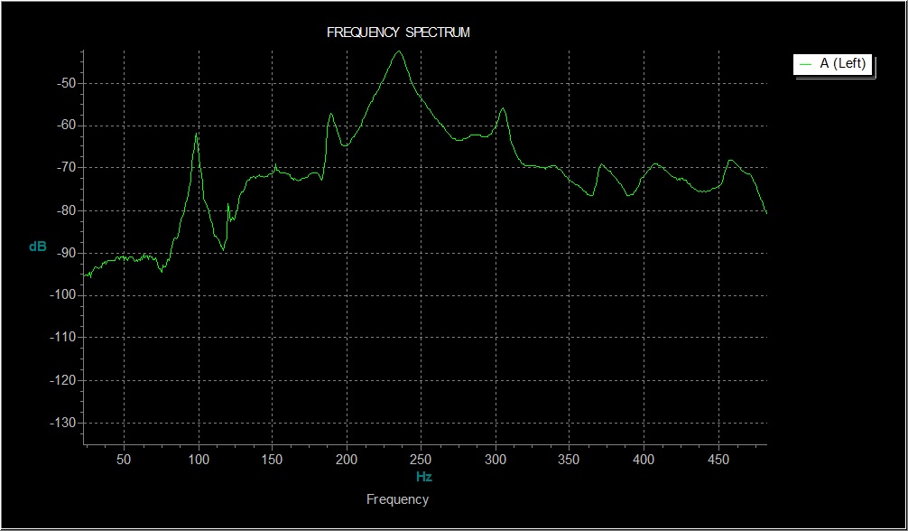

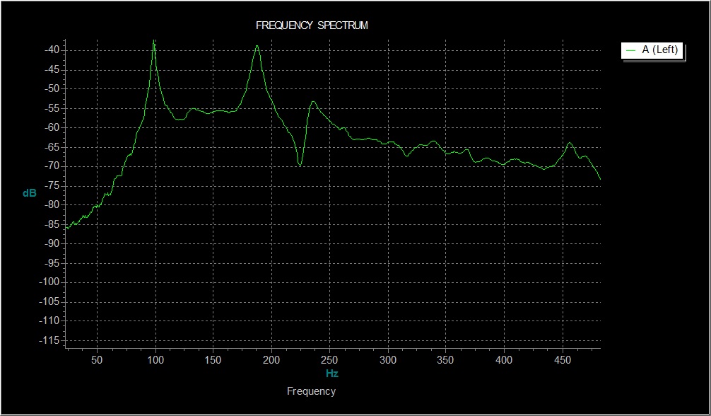

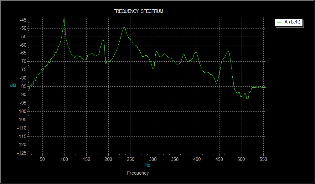

Trevor and John,
You were both correct in that there was a problem with the signal being fed into VA but it was not the signal level. I have a Line 6 Audio interface so I could see that the levels weren't peaking. However I had forgotten to turn off the amplifier simulation so VA was hearing a steel string guitar played through a Marshall Stack. Doh!
The new spectrum plots are below. The odd peaks have gone but the resonant frequencies are similar to my previous tests.
This plot is for tapping the top with the top facing the microphone. This plot is also for tapping the top but recorded from the K&K Pure Minis I have installed. I forgot to mention that I had installed these in my original post. I assume the mass of the PUs only affects the Main Top T(1,1)2 slightly. There is a peak at 275 Hz which is not in any of the other plots. This plot is for tapping the back with the back facing the microphone. This plot is for tapping the front with the back facing the microphone. I am seeing the Helmholtz frequency at 98.2 Hz, the Main Top T(1,1)2 at 187.4 Hz and possibly the Main Back (T(1,1)3 at 235 Hz.
Should I thin the top at the edges? Should I target 180 Hz or 170 Hz for the Main Top frequency?
Your advice would be appreciated.

I can not really answer your questions about what you should do. But building a few of falcate braced guitars, including a copy of the Medium sized one you are building, I am finding that my top resonances are dropping around 10 Hz from where you are just closed to when the guitar is strung up. I made my bridge out of walnut as shown in the book.
That's useful information John. I will also be making a walnut bridge as shown in the book.johnparchem wrote: I am finding that my top resonances are dropping around 10 Hz from where you are just closed to when the guitar is strung up. I made my bridge out of walnut as shown in the book.
Did you thin the top around the edges of the lower bout? If so, by how much?
Thanks.
- Posts: 1643
Page 4-68 in Design has a table for T(1,1)2 drop in frequency per gram of bridge mass. You don't really want to end up lower than 170Hz, so I'd say by the time you have the bindings on and cleaned up, finish on etc. you'll be in reach of 170Hz, maybe with a little side mass, without any extra edge thinning.

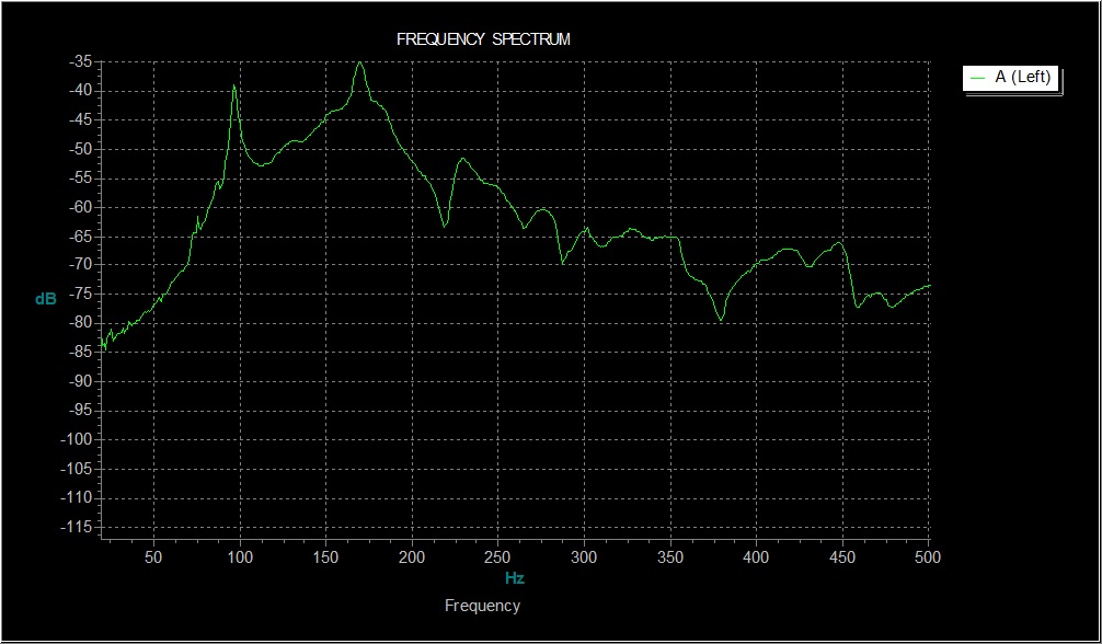

How time flies. It's been three months since I closed the box and did the initial tap testing. Well, the guitar is now complete except for trimming body resonances. There's no rattles or buzzes and the compensated saddle seems to do the job.
I have just done a tap test with the guitar strung and set up. Here's the result. I am seeing the Helmholtz frequency at 96.5 Hz, the Main Top T(1,1)2 at 169.6 Hz and the Main Back T(1,1)3 at 229.5 Hz. So, looking at Table 22-1 of the white book, my top T(1,1)2 is about right. The Helmholtz is 6.5 Hz higher than in the table and the main back T(1,1)3 is just over 5 semitones above the main top. I can't hear any problems with any notes but that may be because I am not experienced in looking (listening) for them. Anyway, there's no major clunkers and I am very pleased with the sound (with crappy strings on). It might sound even better with the set of Elixer Nanowebs I have to put on.
Trevor, it seems that is was a good call not to thin the edges of the top. Do you suggest doing (or trying) anything about the Helmholtz or Main Back resonance? I'm worried that if I try to lower these, the Main Top might also drop too far below 170 Hz because of coupling/repulsion. You said I wouldn't want to go below 170 Hz. I could try adding some mass to the back to lower the T(1,1)3main back and see how much it affects the main top and Helmholtz.
Any other comments on the spectrum?

Put the new strings on it and play it for a while, Richard. If there are no problem notes, stick with what you have.Woodsy23 wrote:Do you suggest doing (or trying) anything about the Helmholtz or Main Back resonance?
A good set of numbers would be 95, 170, 214. Dropping the back stiffness will drop all the frequencies. So if you really need to, reduce the back stiffness a touch to drop the main air resonance a little, but not so far as to drop the T(1,1)2 very much.
