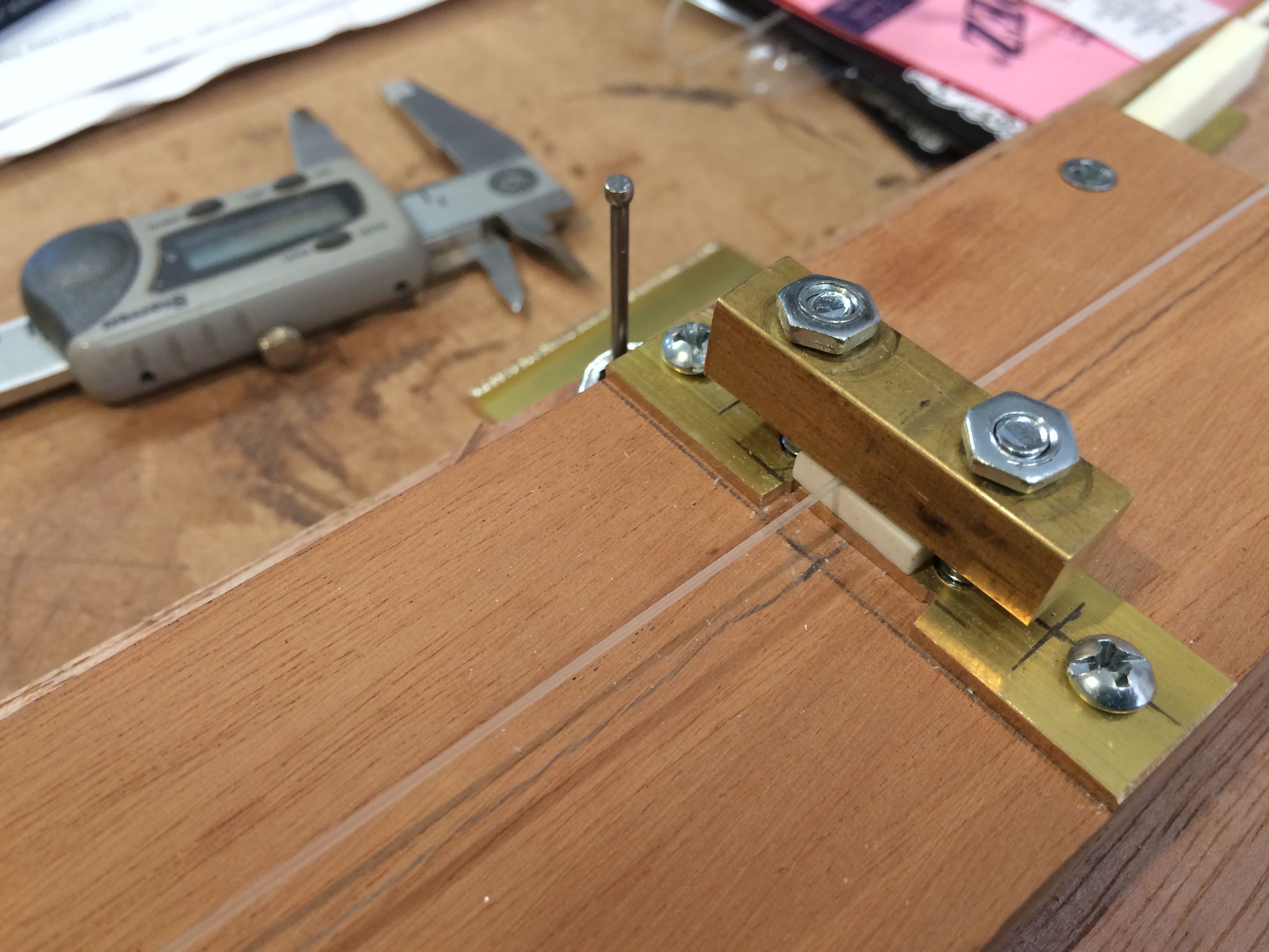

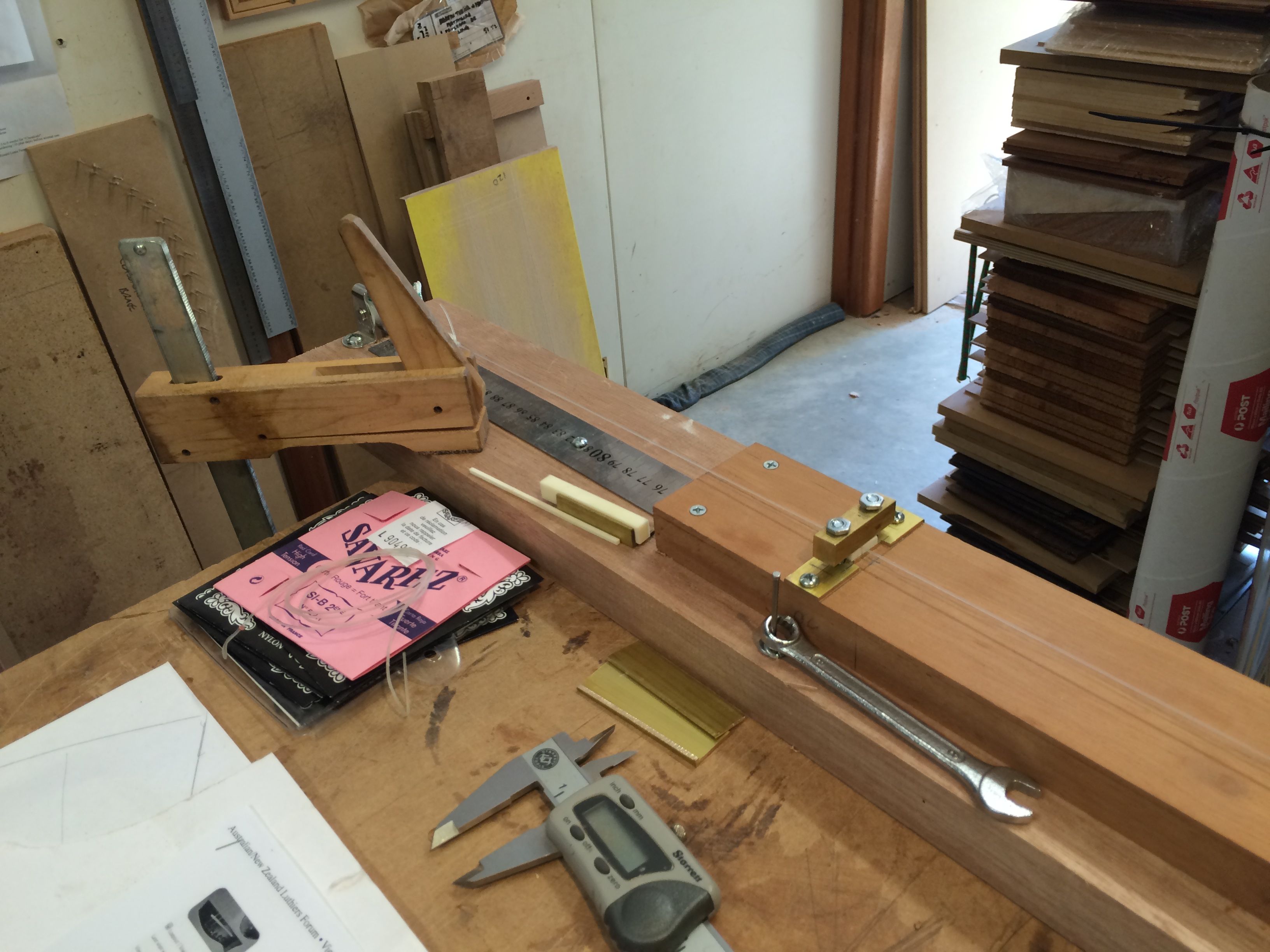

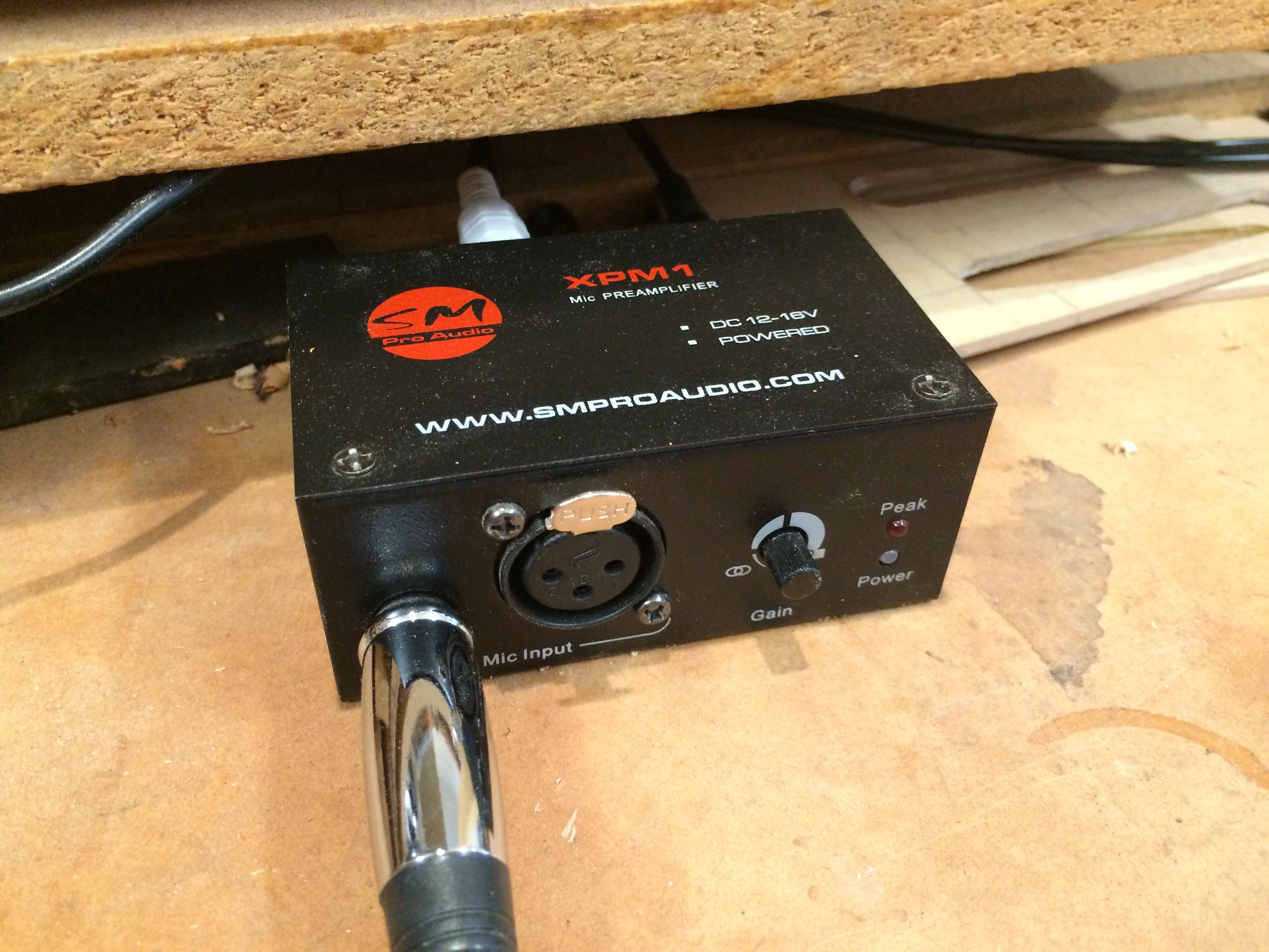

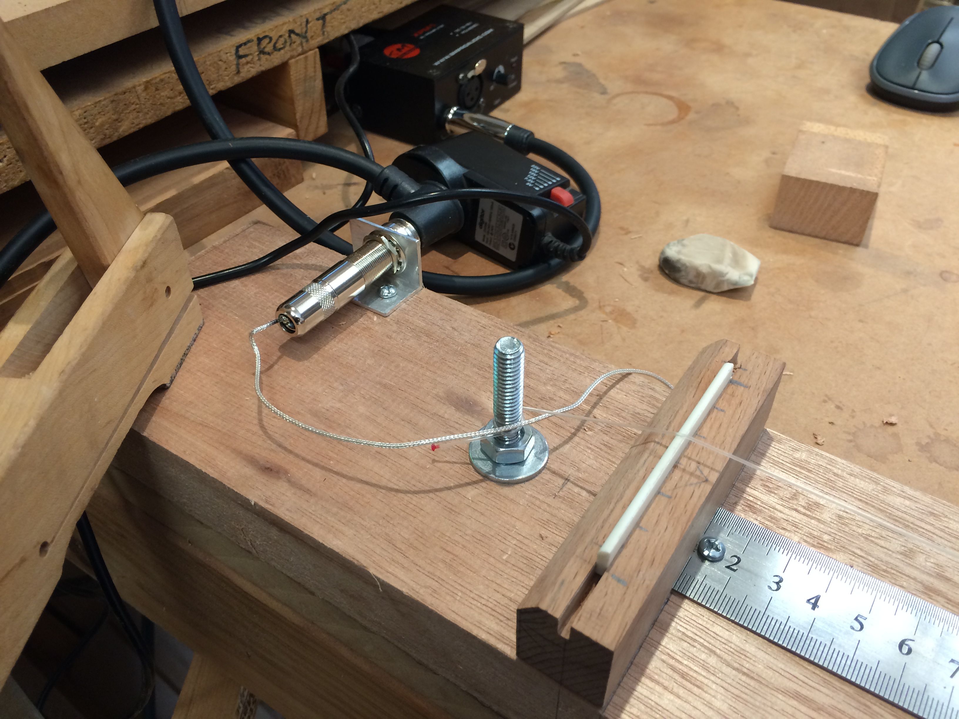

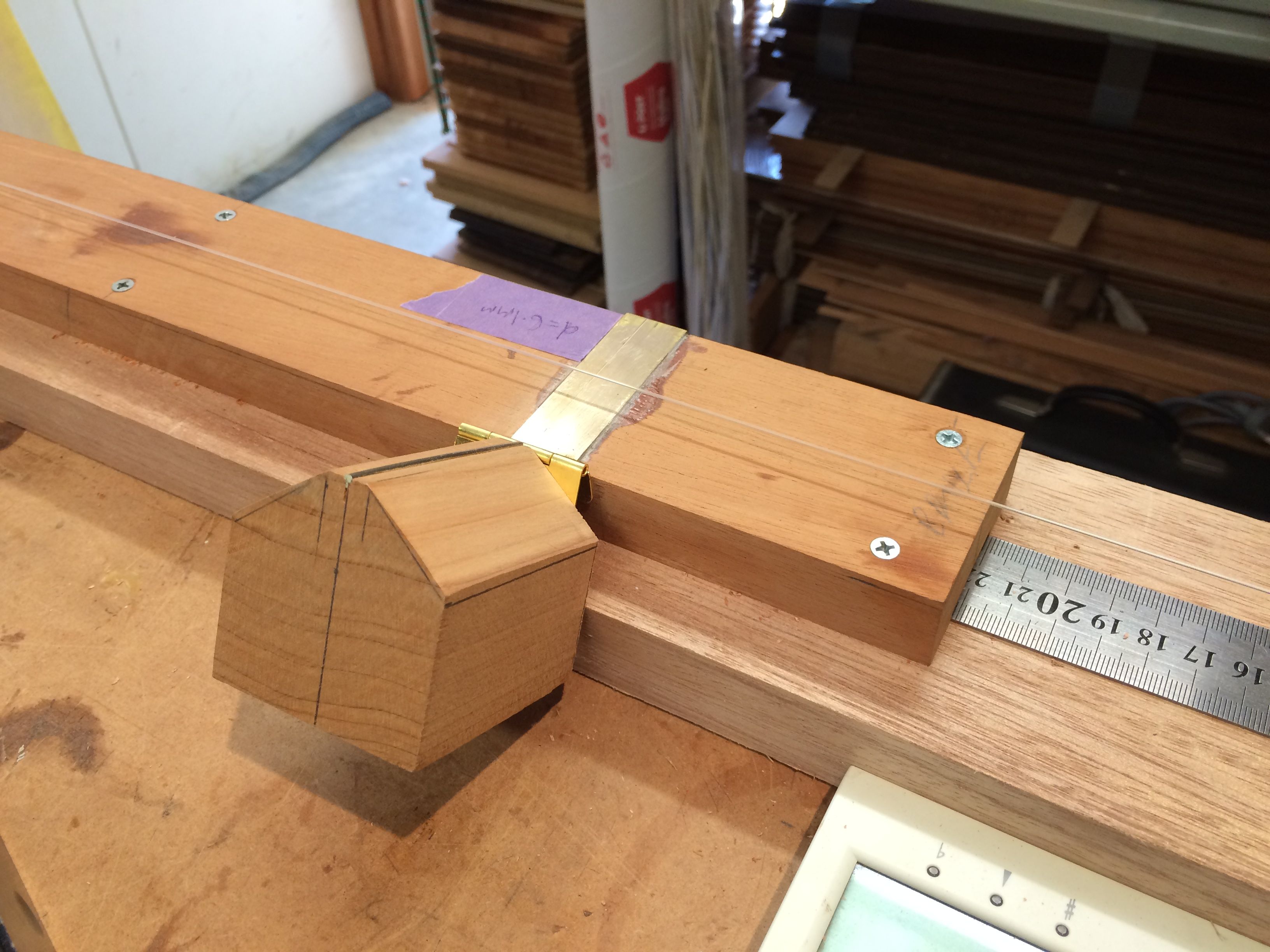

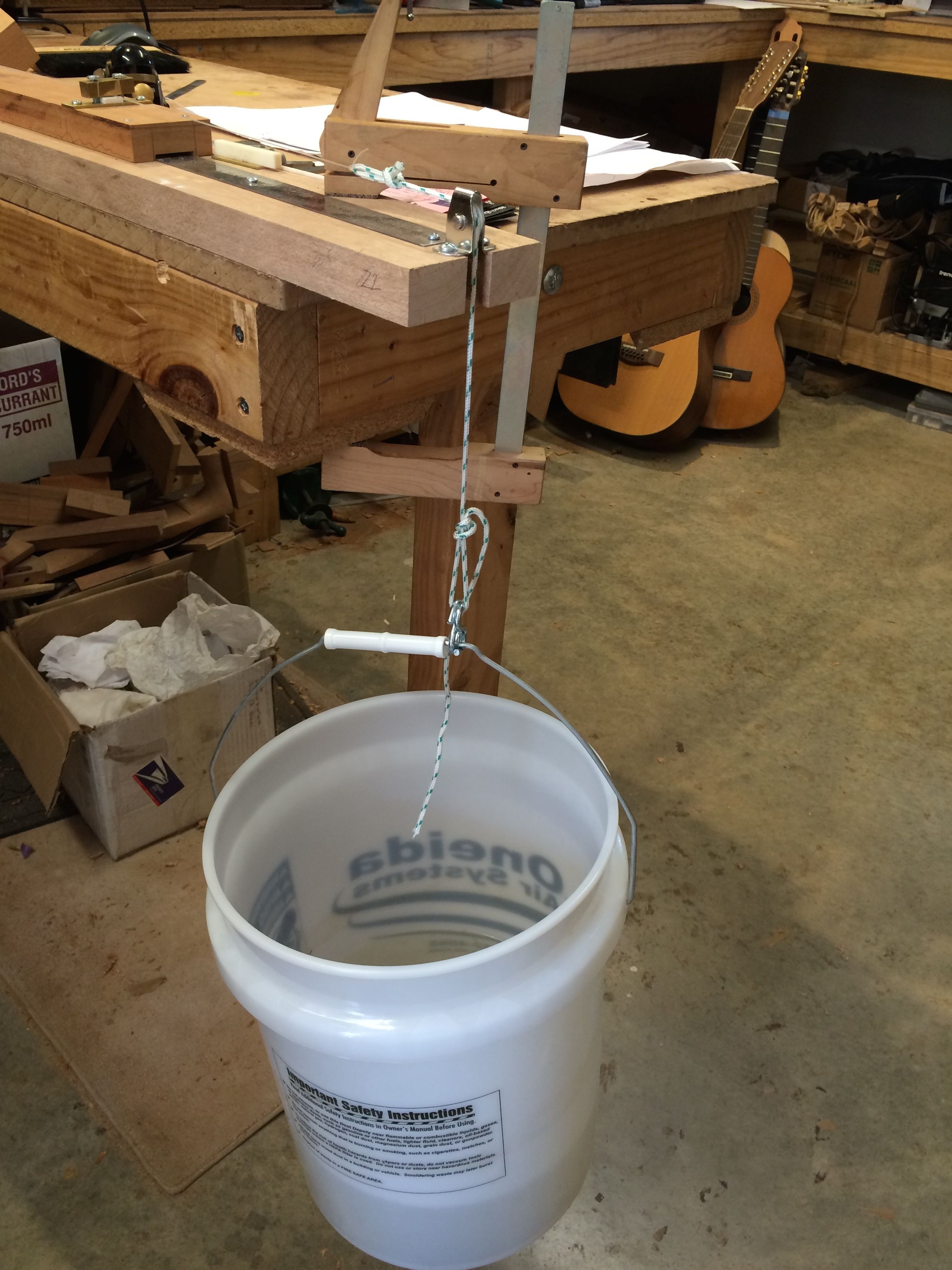

Here's the completed jig. Ive got a Savarez high tension in the jig at present. There's about 6Kg tension on the string to get it close to target pitch.
Notes:
1. I have a K and K undersaddle pickup installed and its going into the laptop via a pre-amp to match impedance and boost the signal. The K and K comes with a 1/4" female socket so I wired that up and ran into the 1/4" input on the preamp.
2. I'm using the frequency counter feature on VA but Ive also got Peterson Strobosoft running as a check along with a manual tuner sitting next to the jig.
3. Ive found that plucking the string close to the anvil gives the best result on the freq counter. If you pluck too hard the counter will measure one of the harmonics rather than the fundamental.
4. Ive used a bucket of water as a weight. This allows easy fine tuning of weight. The downside....I have mozzies in he workshop and today I noticed a few wrigglers in the bucket. Might have to add some frogs.
5. The locking nut assembly has a piece of bone saddle inserted to bring the string action at the anvil up to around 6mm.

- Posts: 1643
Re: Questions re string stiffness jig
That all looks pretty good, Martin!
