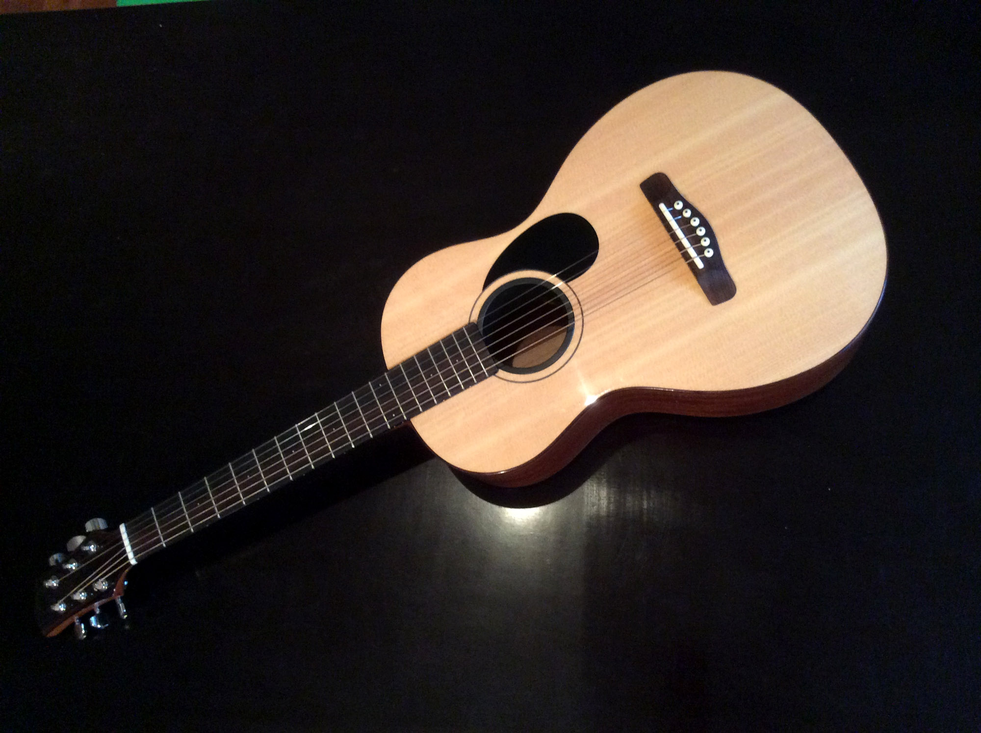

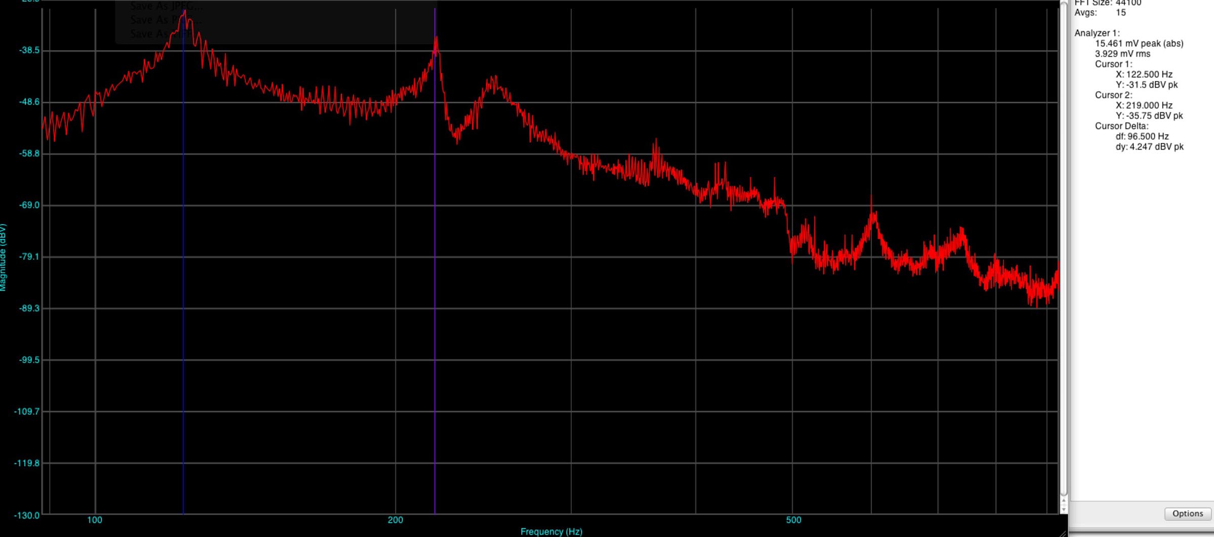

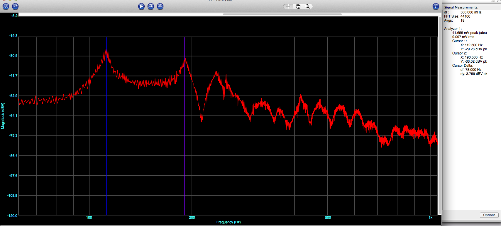

I posted some photos of a falcate parlor in the gallerie.
Here is the spectro of the finished guitar 113 190 238
Here it is with the box freshly closed. 122 219
Sorry there not the same size/sacale but it still gives you an idea how things developed. Good luck
Frank
Frank

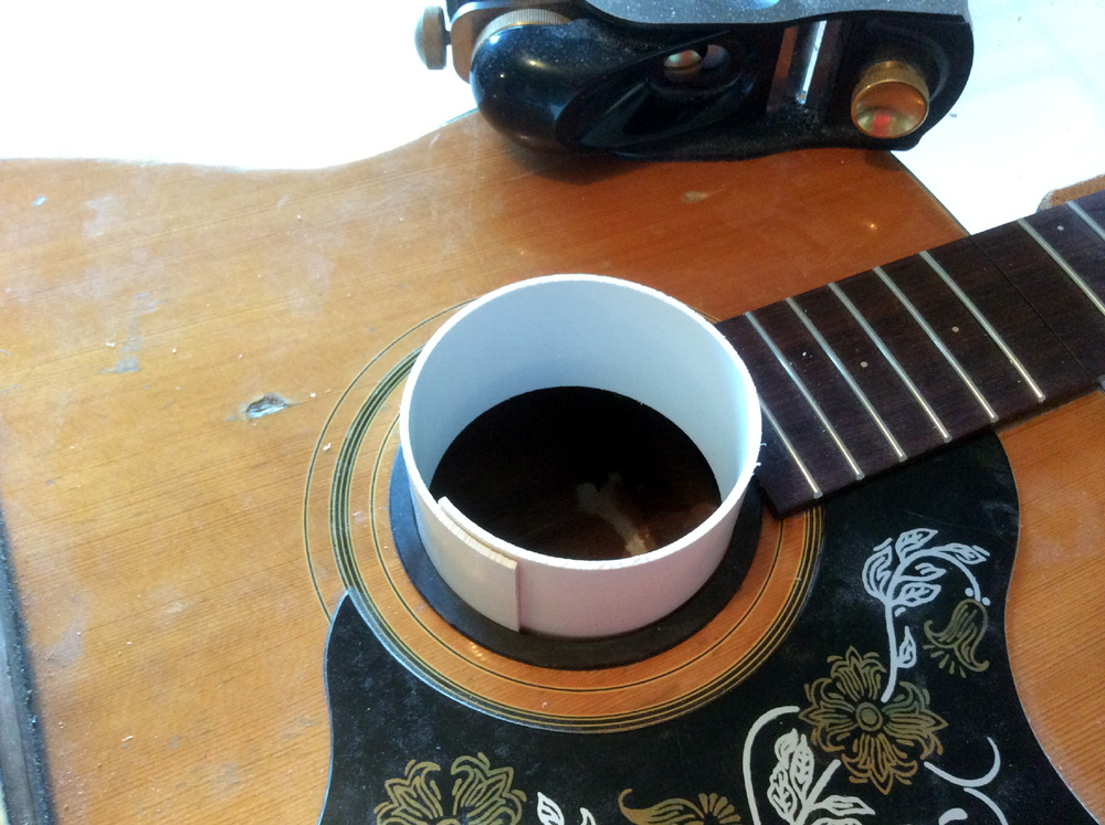

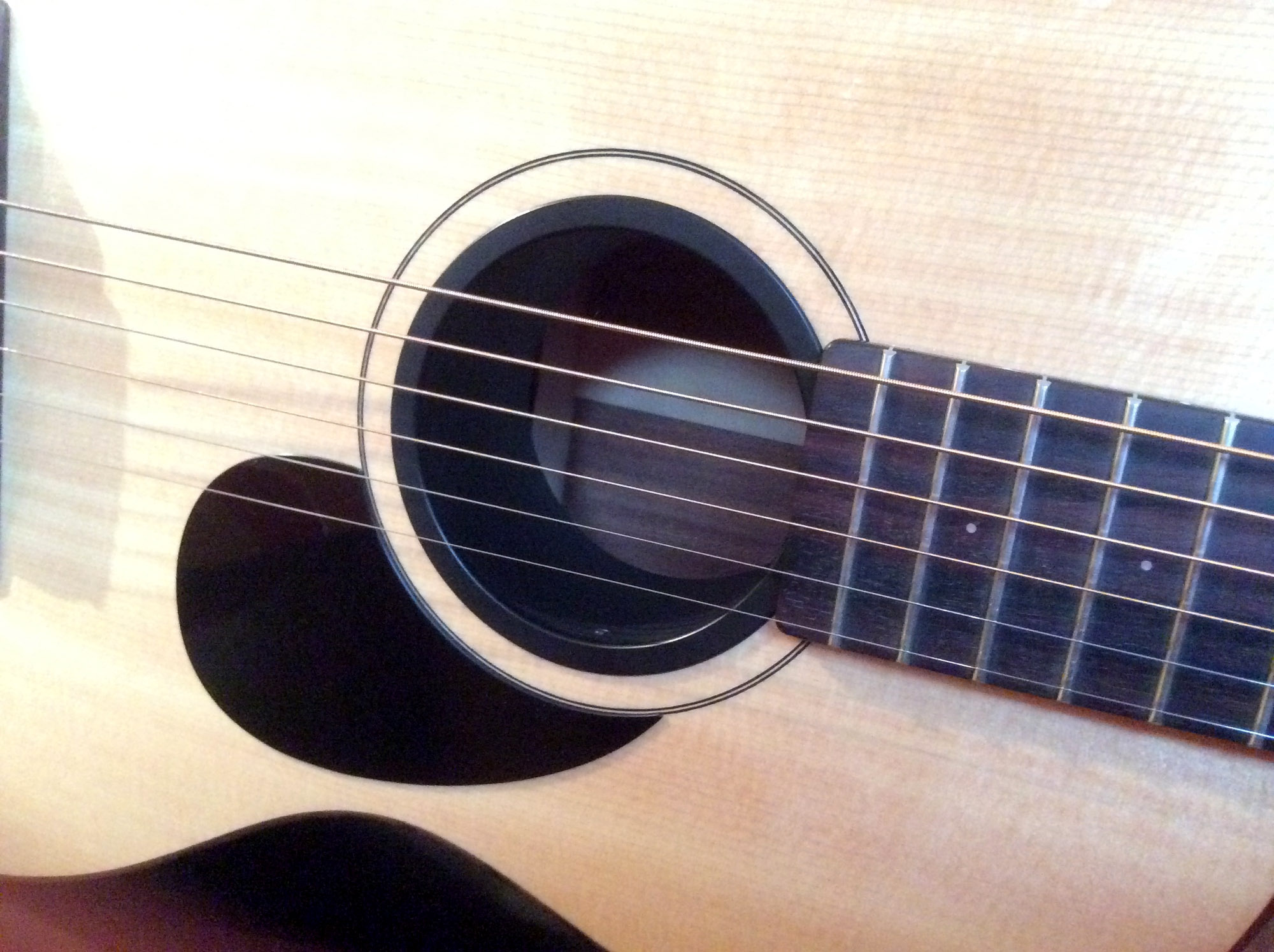

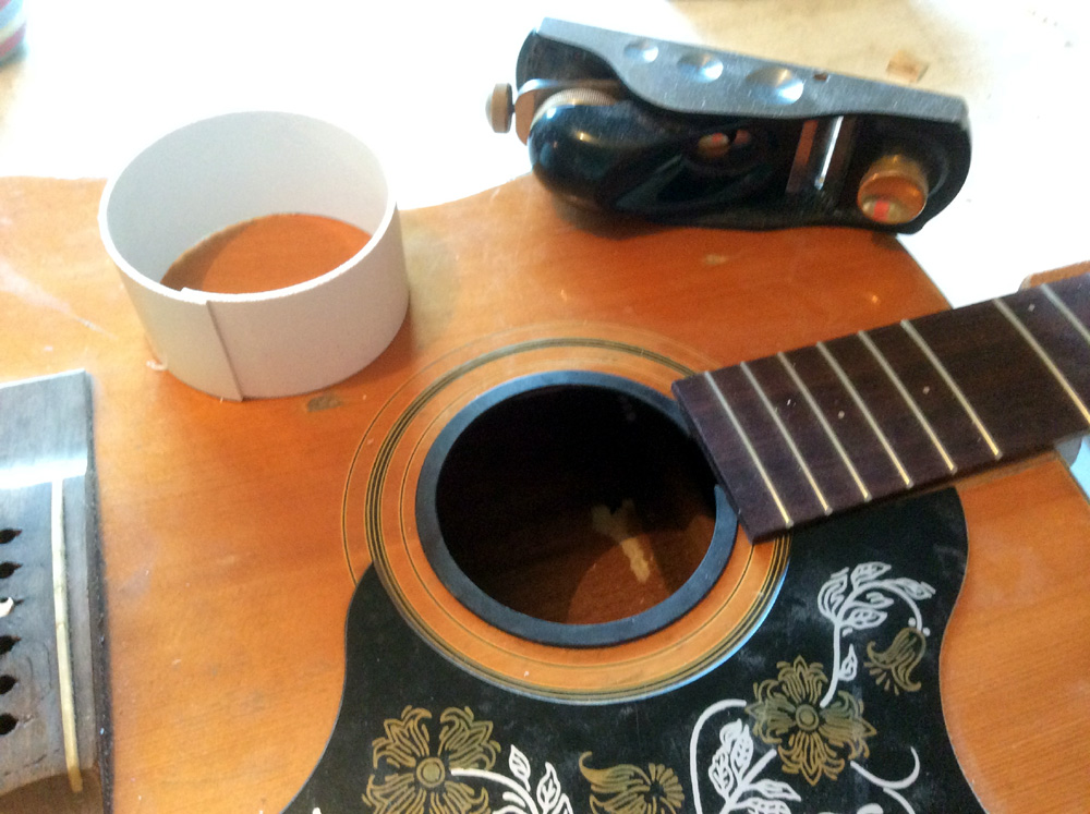

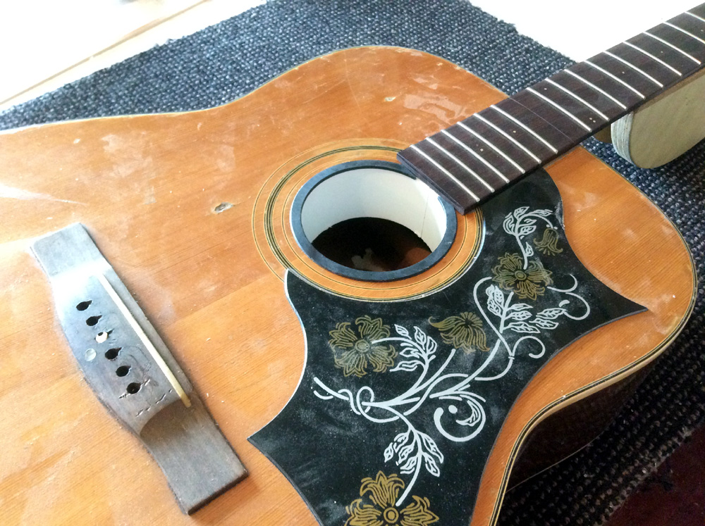

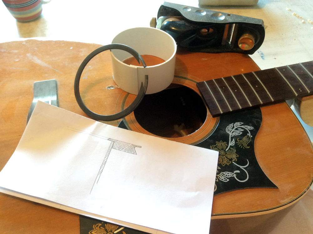

I made my tornavoz out of ply, laminate and PVC pipe it has two parts and I sprayed it black.
I took some photos of the prototype to show how it is made/installed.
Photo 1 is the two parts and a sketch/section to see the profile of the outer ring.
Photo 2 is the outer ring install
Photo 3 is the inner tube sliding through the soundhole, I used the length of this to adjust/tune the frequency drop of T1 which also changed T2.
Photo 4 is the inner tube in its final position, a rebate in the outer ring helps locate the inner tube. On the final tornavoz I used some small dowels to hold the inner tube in position.
