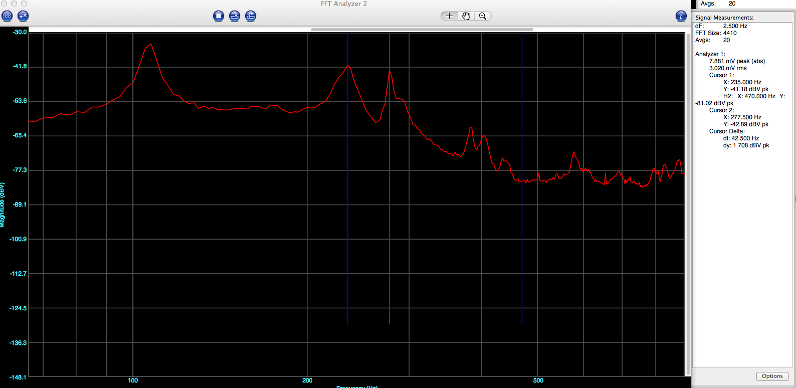

I just closed the box on a Fleta style classical. My first Fleta and guitar #4. I was expecting to see the "close space top and asymmetrical cross dipole" signiture. If I tap near the were the antinode might be I can excite a peek that I believe is the cross dipole pole but the frequency seems quite high and and difficult to excite. Is this something that develops once the bridge is on or is there some way to encourage the asymmetrical dipole through further thinning?

It looks like you have all the right things going on, but everything looks a bit high. Being on a log scale it's hard to read exactly what the numbers are.
As you add mass (the bridge) and loose stiffness (edge thinning, taking the tops off the braces) the spectrogram will tend to horizontally compress, so the peaks tend to get closer together. As the back is stiff in this design (four ladder braces) the top has to be pretty compliant to get the main air resonance down. With lots of bracing inside, you can survive with quite a thin top.
I'm assuming you thicknessed according to material properties and left the lower diagonal "flying".
What to do next? Add the bridge mass and see how far the resonances drop. Edge thinning will bring the main air down as well as the main top. Sanding the tops off the braces should also compress the peak spacing.

Hi Trevor, Thanks. I already have done some edge thinning. I used some low density Engelmann for bracing, so I added .5mm to all the bracing. Also the back and sides were made from EIR 3mm thick. I experimented with the deep hard maple kirfing by CF re-enforcing. Between light brace material, the heavy sides and stiff kirfing I thought the .5 would be justified but maybe I over did it. I was hoping for a higher voiced instrument so it seems it is going work to out with some brace thinning. I'll experiment with the scale on the spectrograph. Good thing to know thing compress some. Thanks

Re: Fleta Tap
I ended up reducing my brace height. I took quite a bit off the braces to get to my target. Maybe to 3mm . The guitar did sound quite nice. I've just boxed one now and instead of using an "f" of 60 I think it was 55 Maybe even 50. (away from the shop right now so I don't know for sure.) About 1.87 mm for a light strong engelmann top. It looks like I won't have to touch the bracing at all on this one.

Re: Fleta Tap
Sorry
Last Fleta (reduced brace hight) 98.5 190 235
1.98mm thickness of revised box. f=55 looks like I'm about right. but i'll let you know what happens
