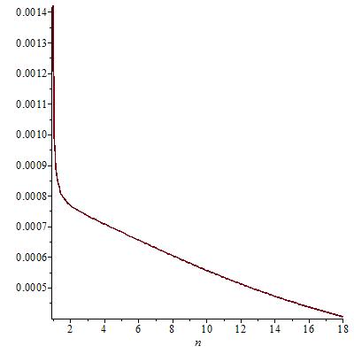

I've been crunching the equations from 4.7.3.2 in Maplesoft Maple, and am getting somewhere. Problem is I'm not getting plausible results and have stared myself blind looking for errors. I wonder if any of you can see where I went wrong?
Attaching an image of the plot of the Intonation error length vs the fret# with no nut or saddle compensation, and also a pdf of the calculations. The calculations should have a similar looking format to those in the book.

Hmmm. I've never plotted it out like that before. But, if I'm reading this right, if you shorten the nut to first fret distance by ~0.6mm, you should have a straight-ish line, intercept at 0.0008 (i.e 0.8mm if you're working in SI. Perhaps you should dimension your axes :D ). Then saddle compensation should reduce the slope of the line, but I'd be checking your sign convention (+ vs -) for movements of the nut and saddle closer/further from the sound hole . So, if I'm reading this right, you seem to be heading in the right direction. Too late to look at maths tonight...

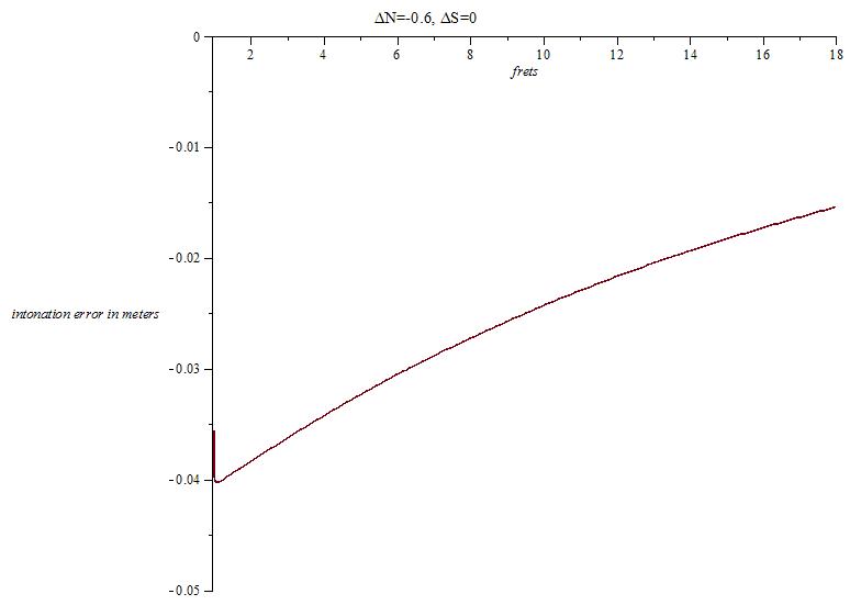

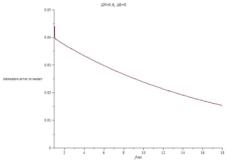

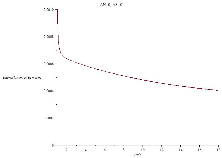

I think the last plot might have been misleading since it didn't really start at 0. So here it comes again along with two plots shifting the nut 0.6mm in either direction. Definitely something funky going on here. I'll get some rest and go through it all again.

Amongst other things that may be wrong ( :( ), you appear to have lost some zeros somewhere. If you take 0.6mm off the nut to first fret length, the graph should come down 0.0006m to start at ~0.0004m not from ~0.04m on your "intonation" scale (which should actually be compensation; intonation error is measured in tonal units, usually cents).
Your delta N reads as 0.6. Best be sure what units that is (mm, cm, m etc.) to check for any lost zeros.
The intonation part of the calc is relatively easy in this thing. The difficult bit is modelling the curvature of the neck in a way that gives the relief and action accurately and that also corresponds to the way builders/guitarists actually measure and refer to relief and action. So, to get the intonation part sorted, first model zero relief in the neck (straight line geometry) to make the action-per-fret geometry simple, and work on the pitch rise/intonation error part until you've ironed out the issues there. Then address the curved neck geometry.
