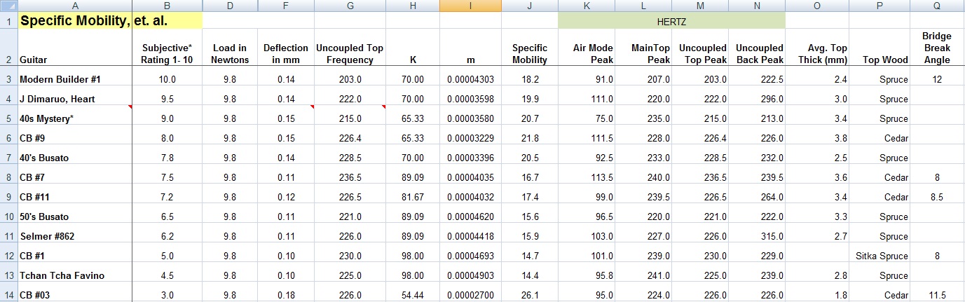

Post by Craig Bumgarner » Thu Jul 04, 2013 1:53 am
Okay, here is most of what I collected on twelve Selmer style guitars at the recent Django in June festival in Northampton, Mass. Five of these were guitars I had built (CB) and brought to the festival.
Some notes:
My subjective rating, first column, is indeed very subjective and is based solely on what I think about the way the guitar sounds in relation to the requirements of the style: Loud, responsive, cutting, tight woody bass, never muddy. The emphasis is more on the fundamental than the harmonic. These guitars do not sound pretty, they are acoustic swing jazz instruments. Guitars rated in the 9-10 range are among the very best vintage or modern. Guitars below 5 are either common, failures or played out. Most players are very happy with a guitar that rates 6 or more, 9-10 usually induces a fair amount of jaw dropping.
The rest of the columns are pretty self explanatory. If anyone would like to see the FRCs on any of this, let me know, I have them all. JeffHigh, Trevor & I have been talking about measuring Monopole (Specific) Mobility and there is some agreement that my MM numbers generally run higher than Trevor's, so comparison to guitars other than what is listed above is not really fair.
It appears to me that the best guitars have the best mobility numbers. Other than that, it is hard for me to make conclusions. I welcome any and all interpretations. My main interest in doing this was to establish some base lines for Selmer style guitars and it seems this is a start.
Regards the guitars, the seven that are not mine are truly an interesting bunch. The modern builder #1 not a household name, but he is both a great builder and player for Holland. He could have sold this guitar five times at the festival but in the end a friend of mine bought it and so I got to measure it some. This guitar is close in sound of Django's Selmer 503 that we hear on the recordings from the early 1940s than any I've ever heard.
The 40s Mystery (my name for it) is possibly a Busato or a Joseph Dimauro, no label, but clearly from Paris in the late 40s. I have pictures of both George Brassens and Felix Leclerc playing this same model. This guitar weighs just a little over 3 lbs. and is a cannon. I recently put a new fingerboard on for the owner and delivered it to him at the festival.
Busatos are amongst the most desired gypsy guitars. The 1940s Busato Gran Model was very good, but I was not that impressed with either the 1950s Bustato or Selmer #862 (yes, a real Henri Selmer, one of the last built, 1952, rosewood neck, five braces) . Both seemed heavy, overbuilt and perhaps played out.
You might also take a look at my CB #03, last in the line. This guitar is one of my earliest builds. It was okay at the time and is probably better than a 3, but I wanted to put it at the bottom of the list because of the oddly high mobility number. It was so high that I redid the measurements, but this seemed okay. What you will notice is the particularly high deflection. That is quite so and is likely because the cedar top on this guitar is much thinner than most and this deflection is what is driving the high mobility number. Problem is, it doesn't sound like it. It just average in response, bass is strong as one would expect with the thin top, but FRCs are in the middle with all the rest. I'm perplexed. Is it possible that there is an upper limit to MM where going over gives no improvement?

Posts: 1536
Re: Testing good examples
Post by jeffhigh » Thu Jul 04, 2013 7:12 am
Very interesting Craig
A couple of questions
Were they all small mouth long scale?
The Grand Busato has a wider body? any others non standard width?
Were you able to observe any variations to the top and back bracing?
Jeff

Sound holes: The Joseph DiMauro (the elder) guitar has what is referred to as a heart shaped hole, more of a triangle with curved sides, about as large as a hole in a standard flatop, ~ 100mm across. It was one of his trademarks, I don't think anyone else used this, even his brother Antoine or his brother's son Joseph the younger who both used many of his other ideas. My #7 & 9 have a middle size horizontal "D" hole, patterned after J. Castelluccia guitars from the 1950's. You can see these on my blog, I love the shape. The size is nice as it gives the player a little more volume to hear himself without getting tubby like the large D holes. The rest are small oval (ellipses actually) holes. Most are the standard 54mm x 70mm. The 40s Mystery sound hole is 60 x 83 and my #11 is 60 x 76.
Scales: all 670mm except for the Busatos and Favino which are 675mm. I originally measured the Mystery guitar at a sloppy 660mm but this was not right. It was actually 670mm spacing everywhere except at the zero fret which was too close to the first fret by 4mm! Similar fret spacing issues happen all the time on these old guitars, even the good ones.
All were 14 fret to the body joint. All with floating bridges and tailpieces.
Yes, both the Busato Grand Models and the DiMaruo are 410mm wide at the lower bout The Favino is 420mm. The rest are standard Selmer size, 400mm. Body depths are all around 95 to 100mm.
Braces & Backs:
  • Modern builder #1: very Selmer 503 all the way. Four major ladder braces, four minor ones (2 under bridge, 2 alone side fingerboard on angle. Solid mahogany back and sides, back has three 10mm x 16mm braces, just like Selmer
  • DiMauro: four ladder braces, with the little cross braces under the bridge. Back is molded into an carved archtop shape, no braces, pretty stiff.
  • 40s Mystery: Three braces, bridge sits about 30 uphill of the bottom brace. Molded, arched back, no braces.
  • Busatos: Five braces ala Selmer, but lighter. Backs both molded into archtop shapes
  • Selmer 862: If you know Francois Charle's plans of Selmer 807, this one is just like it. Five major braces, four minor, laminated back and sides.
  • Favino: Four braces on the top with the little cross braces under the bridge, larger body, otherewise pretty much like Selmer 503.
Top braces on almost all the guitars I have looked at are usually 5, 4 or 3 braces on the top, always ladder braces. The backs are usually laminated, either as flat plates pulled into an arch by braces or molded into a curved arch or an archtop guitar or violin back shape. The molded back often have very little bracing and range from scary flexible like on the 40s Mystery guitar to rock solid like the Busatos. It is hard to say whether one bracing system or back configuration makes a better guitar. In general, the guitars I tend to like have three or four braces and that is what I use. My #9 is three braces, #3, 7 and 11 are four and #1 (my first, which I still have, its my gig guitar) has five ala Selmer.

Trevor Gore
Posts: 1638
Post by Trevor Gore » Fri Jul 05, 2013 12:00 am
Great work, Craig. Thanks for sharing.
I think we might have discussed this before, regarding the zero count for K and m. K should be 70,071 newtons per metre and m should be 0.043 kg to be in SI units. As you have it, the "errors" cancel and you end up with 18.2 milliseconds per kilogram (18.2 * 10^-3 s/kg) for the monopole mobility.

Post by Craig Bumgarner » Fri Nov 08, 2013 6:22 am
Craig Bumgarner wrote:........ You might also take a look at my CB #03, last in the line. This guitar is one of my earliest builds. It was okay at the time and is probably better than a 3, but I wanted to put it at the bottom of the list because of the oddly high mobility number. It was so high that I redid the measurements, but this seemed okay. What you will notice is the particularly high deflection. That is quite so and is likely because the cedar top on this guitar is much thinner than most and this deflection is what is driving the high mobility number. Problem is, it doesn't sound like it. It just average in response, bass is strong as one would expect with the thin top, but FRCs are in the middle with all the rest. I'm perplexed. Is it possible that there is an upper limit to MM where going over gives no improvement?
Just to close the loop on this..... I have this CB#3 guitar back in my shop today. It is being sold and the buyer wanted me to look it over before fully committing to it. I redid the deflection and the top FRCs. The FRCs are the same as was tested last summer, but the deflection is half of what I measured earlier.
My guess is I didn't have the load squarely seated on the bridge. Selmer guitars have archtop like bridges with very narrow edges where the strings go across. Unlike a fixed bridge, there is nowhere else to take the deflection measurement. I set a narrow block of plex across the strings, on the edge to land my dial indicator shaft. My guess is the block was off center and the deflection load was partially being taken by the strings. My bad! I need to cook up a little adapter that will self center on the edge.
I have been "calibrating" my thumb pressure on guitar tops and the first thing I did when I took this one out of the case was to push down on the top. .18mm deflection? No way!
The .09mm deflection measured today yields a mobility of 13.1, much more in keeping with the way this guitar sounds. This confirms its position at the bottom of my list posted earlier, both in subjective assessment and in mobility. Glad to have that little discrepancy cleared up.
I had mentioned the cedar top on this guitar is thin, very thin, 2.0mm and even a bit less in places which is why I initially thought the deflection number seemed reasonable, but in hindsight, it has a overbuilt bracing structure so the assembly is still overly stiff and heavier than need be.
