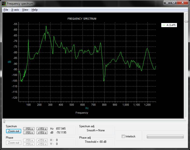

Okay, thanks Trevor. I did some tests taps this morning on one of my older guitars, strings off, strings on. I was a little concerned that with a Selmer type guitar, floating bridge and tailpiece, that I might get significantly different results if I could not tap in the center area of the top made inaccessible by the strings. No big difference though.
I'm just getting started with this, but one things I have noticed so far about the Selmer style guitars I have tested is the main peak which I take to be the monopole resonance is much higher (~ 260-280hz) than the targets in your book (170-180). The coupled Helmholtz is similar at ~ 95-100. But the high monopole made me wonder if my test regime was flawed somehow. So I tapped an old dreadnaught I have and it is right in the range you suggest for dreads in your book.
I've tapped three other Selmer style guitars, one of mine and two by other builders and the FRC are similar for the air and monopole peaks. At this point I have no real idea what the peaks beyond the monopole peak mean. I'm guessing some Chiadni testing will help me identify modes with FRCs, but I'm not set up for that yet.
Here is a FRC of a Selmer body I just boxed last week. No neck, so strings, no bridge. Cedar top, old school ladder bracing (four), small oval sound hole. Fairly typical set up. I go a little heavier on the top and lighter on the bracing than most builders which gives me a slightly lusher tone without diminishing volume or dryness in rhythm chords. The high monopole is, I'm guessing, not really surprising. These are bright punchy guitars which have little use for bassy resonances which tend to only muddy up the chords when being played fast and furious. I'm looking forward to applying principals discussed in the book to making mine better.
Re: Collecting data on good examples
The peaks beyond the main top resonance are a combination of monopoles, dipoles and more complex modes. One thing I've noticed is that up towards the high end of the spectrum the modes are more heavily influenced by minor components of the bracing under the top.

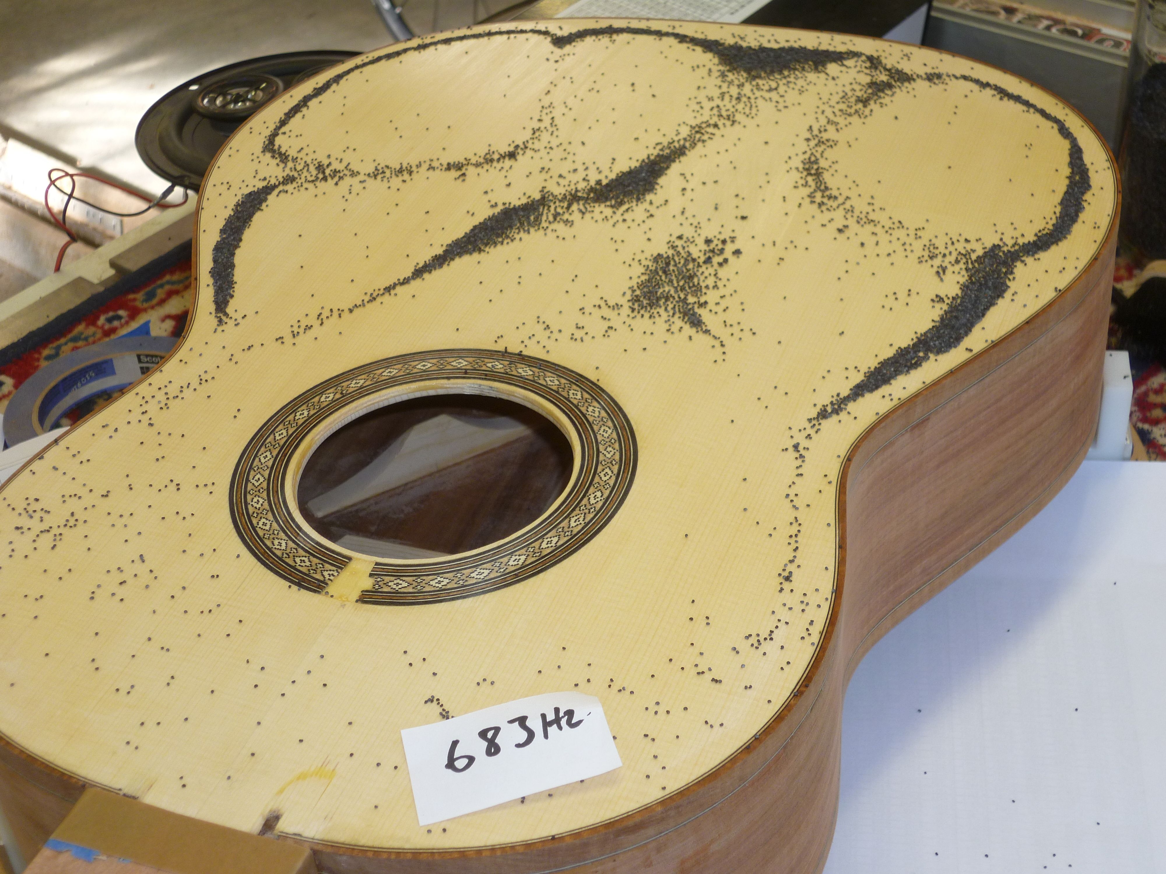

Photo is of a falcate braced classical built Spanish method. Top is Englemann and its being excited at 683Hz.

Yes, that would be correct. The Selmer style guitars tend to be very stiff, hence the high pitched main monopole. Other than that, I can't tell you much! I've never built one, but I know a few people who have. I love the music that gets played on them, though. If you haven't come across him yet, check out one of our (ex) locals, Ian Date, http://www.iandate.com/.Craig Bumgarner wrote:...one things I have noticed so far about the Selmer style guitars I have tested is the main peak which I take to be the monopole resonance is much higher (~ 260-280hz) than the targets in your book (170-180).
When you're tapping out other guitars, make sure they're strung, etc. because the bridge mass will be part of the "equation" affecting what you hear.
