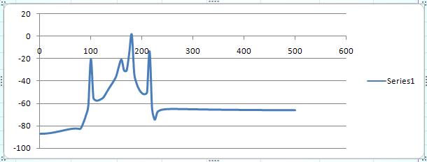

Hi all,
I've been working through the design volume and it's all starting to make some sense but I've hit a brick wall with the 4 DOF model. I've implemented it in Excel and using the model parameters from table 2.4-1 but it bears little resemblance to Fig 2.3-4.
There are a couple of items that I'm not sure that I've implemented correctly.
1/ The omega and omega squared value in the displacement denominator I assumed to be 2 Pi F where F is the model's input frequency.
2/ The denominator (Dt, Ds, Db and Da) is in the form z=x+jy and the solution is z=sqrt(x2+y2) where x = miwi2-miw2 and y=Riw
I hope that makes sense, it looks horrible without superscript and subscript.
The plot I get is below and I can upload an image of the sheet with the intermediate values if somebody has successfully tackled this using the same parameters and can compare them and point me in the right direction.
Any help would be greatly appreciated.
Os
Os

Re: 4 DOF Model
Hi Os,
Well done for having a go at the 4-DOF model!
Re: the plot, if you're getting what you have, you must be getting pretty close. It looks like you have an extra oscillator switched on, because of the 4th peak, or you have misplaced a decimal point, maybe on the side mass oscillator. If you check all the numbers (again!) and they seem OK, maybe you have another case of Excel ill-conditioning. The only way to check that is to re-code the spreadsheet breaking down cells with long formulas into smaller ones and see if you get the same answer.
Correct.johnosb wrote:1/ The omega and omega squared value in the displacement denominator I assumed to be 2 Pi F where F is the model's input frequency.
Not sure where you're going with this one. I didn't go looking for a solution to the D's here, I just evaluated them for each value of ω, iirc.johnosb wrote:2/ The denominator (Dt, Ds, Db and Da) is in the form z=x+jy and the solution is z=sqrt(x2+y2) where x = miwi2-miw2 and y=Riw

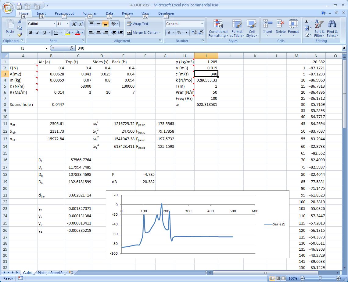

Re: 4 DOF Model
Another couple of hours going over the equations. I recoded the Dbar into several chunks as that was the longest calculation but no difference. I'm convinced it's my method and my misinterpretation of that denominator issue and how I'm handling equations AII 2-25 though AII 2-28. Oops, just looked at my previous post and realised I screwed up on the imaginary argument theta should have been theta = atan(y/x) not that I think it's used anyway.
Trevor I'm not sure I understand when you say you just solve for omega (how did you get the greek font in your post??), iirc - I don't know what iirc is. The equations on p2-35, 2.4-5 through 2.4-8 and Dbar all require a value for the Di variables and they are defined in Appendix, section 2 as the denominators of Aii 2-25 through AII 2-28. Am I missing something??
Os.

Re: 4 DOF Model
I just nested the imsums and imsubs because I was trying save space to keep everything on the same page so that I could try to keep up with it. I broke it down today and broke them up into logical groups and put them on separate sheets. Found 3 or 4 oopsies in the process and it moves closer to resolution. See attached plot. Given that the resultant air pressure is still in a complex form (rectangular x+jy - for 100Hz it is about 3.3E-7 + j1.34E-6) so still the only way I can think of to to resolve it is sqrt(x^2+y^2) before feeding it into the sp(Db) calculation.
Os

As I was taught j is the square root of a negative number, no two numbers squared can give a negative result as the result of negative numbers squared is positive (-2 X -2 = 4) it is imaginary. But j^2 = -1 so traditionally j = sqrt -1. interestingly, sqrt j9 for example can be either -3 or +3. Whole bunches of rules to learn! I think Euler is to blame or was it Gauss, maybe both had a finger in the pie. It's useful to electrical and electronic engineers in AC circuit analysis and I think I remember that there are some obscure polynomials that require imaginary numbers to reach a solution. For the rest of us it's just designed to confound and frustrate!Dominic wrote: I was just reading up on imaginary numbers and this site did not say j = sqrt(-1). But it did say the j is the answer to sqrt(-1). Credible? This stuff is hard enough without learning the wrong stuff at the same time. Its still cool though.
i is normally used to represent the imaginary component but j is used by engineers as i denotes current - just to add another layer of confusion. I passed some of my questions to a maths Phd (former colleague) and in his response he changed all the j's into i's with a snide comment about electronic engineers! I didn't get a straight answer but 3 pages of nonsensical derivations where I ended up with a real denominator but an imaginary numerator with a note saying "this should help", yeah right!
Os
- Posts: 1639
Re: 4 DOF Model
I put it all on one sheet, but was out to column DG!johnosb wrote:I just nested the imsums and imsubs because I was trying save space to keep everything on the same page so that I could try to keep up with it.
Try that and post what you get.johnosb wrote:Given that the resultant air pressure is still in a complex form (rectangular x+jy - for 100Hz it is about 3.3E-7 + j1.34E-6) so still the only way I can think of to to resolve it is sqrt(x^2+y^2) before feeding it into the sp(Db) calculation.
