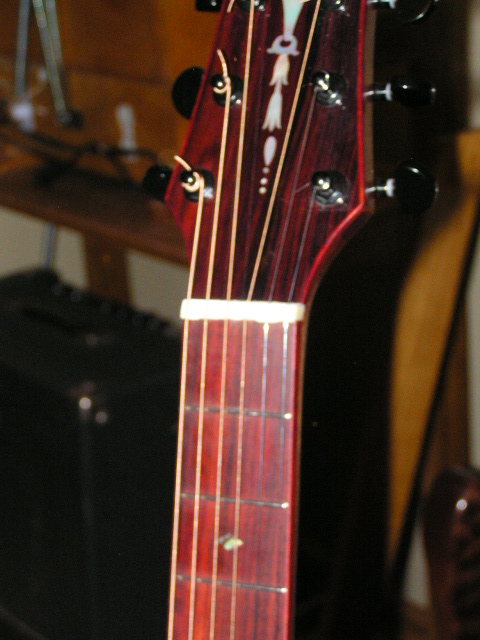

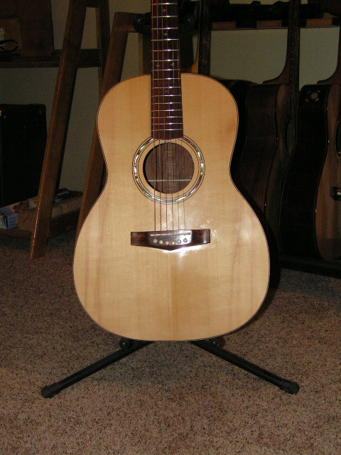

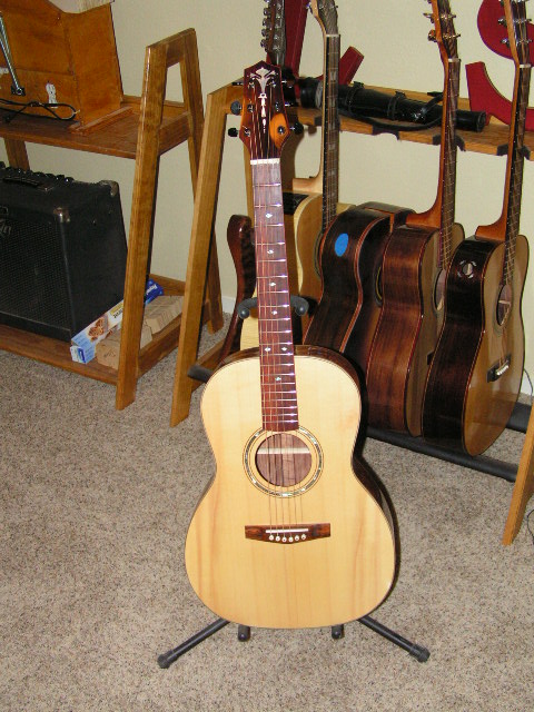

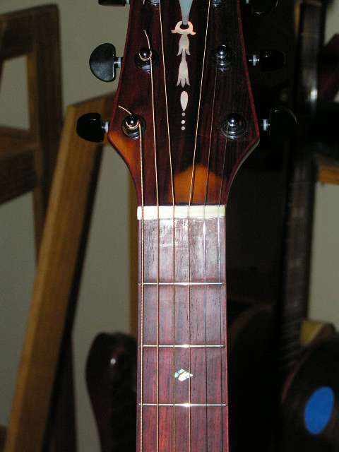

I just strung this up tonight..I started this guitar a long time ago, its been sort of a test guitar. I used your numbers to compensate the nut and saddle...worked fantastic!!! the 3rd , 5th and 7th frets are almost dead on ...within a couple of cents, setup is close but not done, I am letting it set for a few days then do the final setup.....
Pictures aren't too great but using the end of the fretboard as the zero fret position , I added a shim to the front of the nut then carefully measured with calipers and filed it.. the saddle is 1/8 inch wide and using my stewmac bridge locater adjusted to the zero fret position I set the front of the saddle .036..to allow for slight compression , which left me room to compensate the saddle for all strings...
