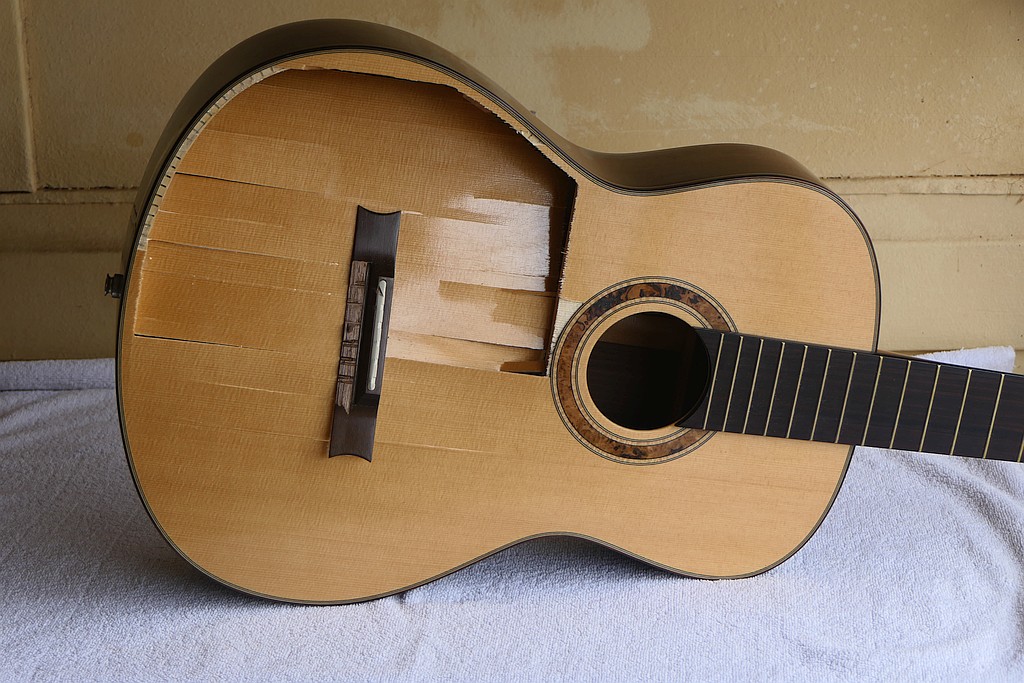

This one didn't survive a bar room fight. It got stood on (accidentally). The guy was heart broken.
Whilst braces were broken, they cracked along their length or split away from the top, rather than snapped in two. None of them detached from the ends.
The thing that prevents that is that they are tapered down to nothing, so preventing a stress concentration at the ends (a "corner" where the brace end stops) and where cracks would propagate from. That's the reasoning behind "fish-tailing" the CF, too. If the CF hadn't been there and the braces were tapered to zero, they still wouldn't have popped from their ends.
Fortunately, only the top suffered any damage. I fixed the guitar using the "drop-in re-top" method, saving the bindings and not having to re-finish the rest of the body.
Good as new!

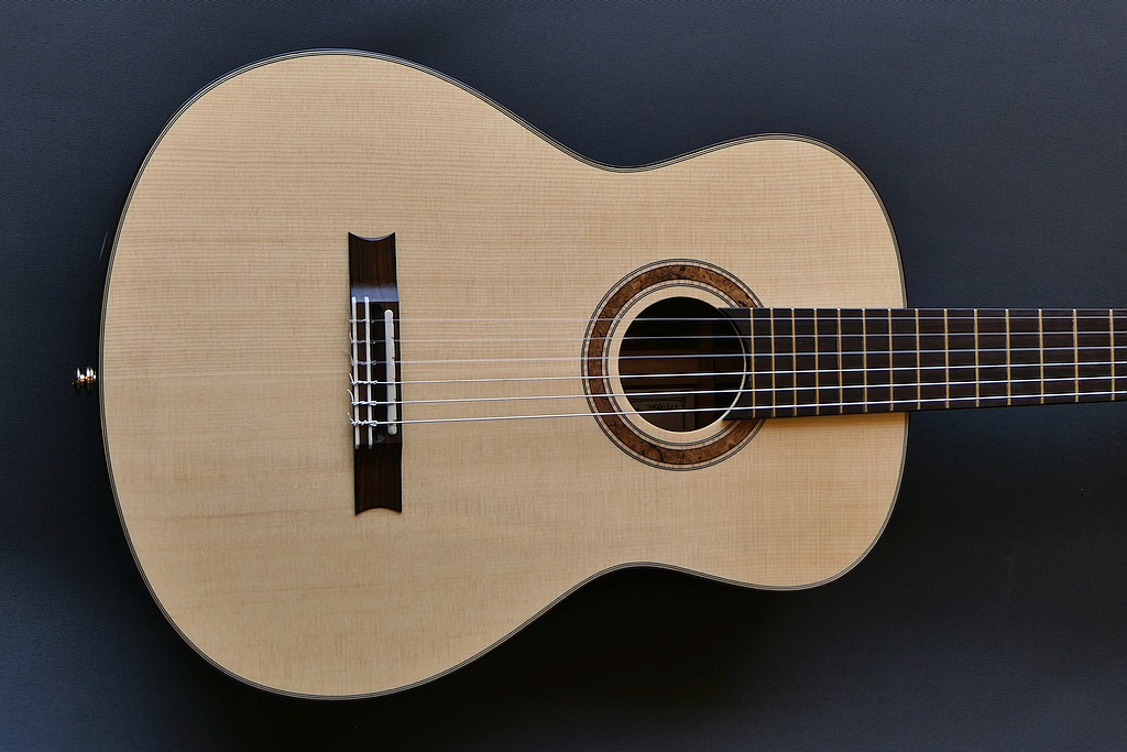

Actually, probably better. He said he didn't use the original pick-up (a "just-in-case" installation) so I left it out and the second top was made with a higher monopole mobility (which needs to be reduced when a pick-up is fitted to avoid perennial feedback).
