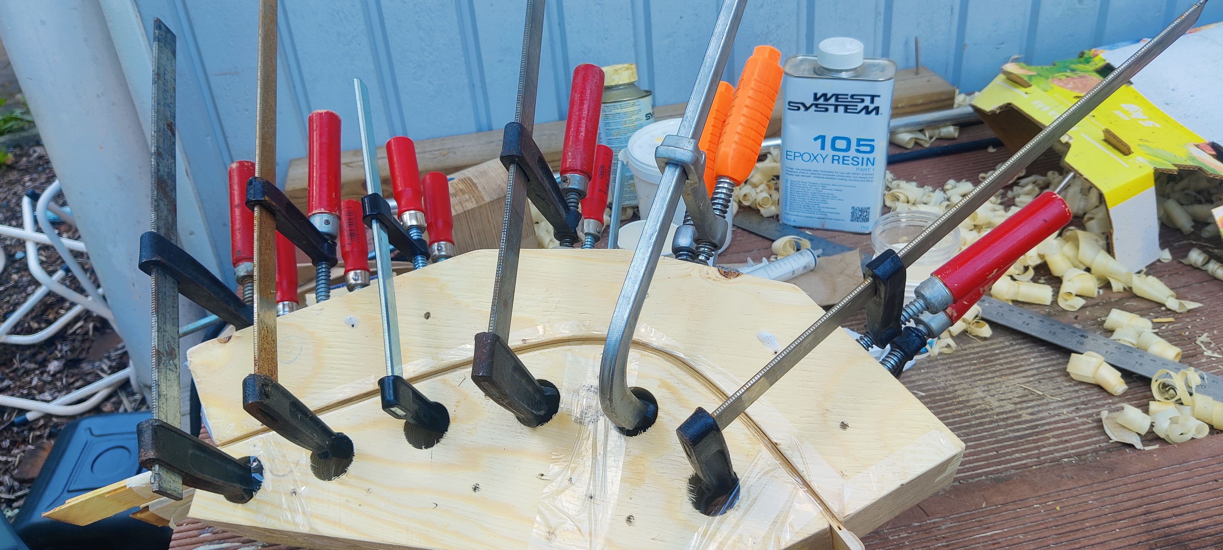

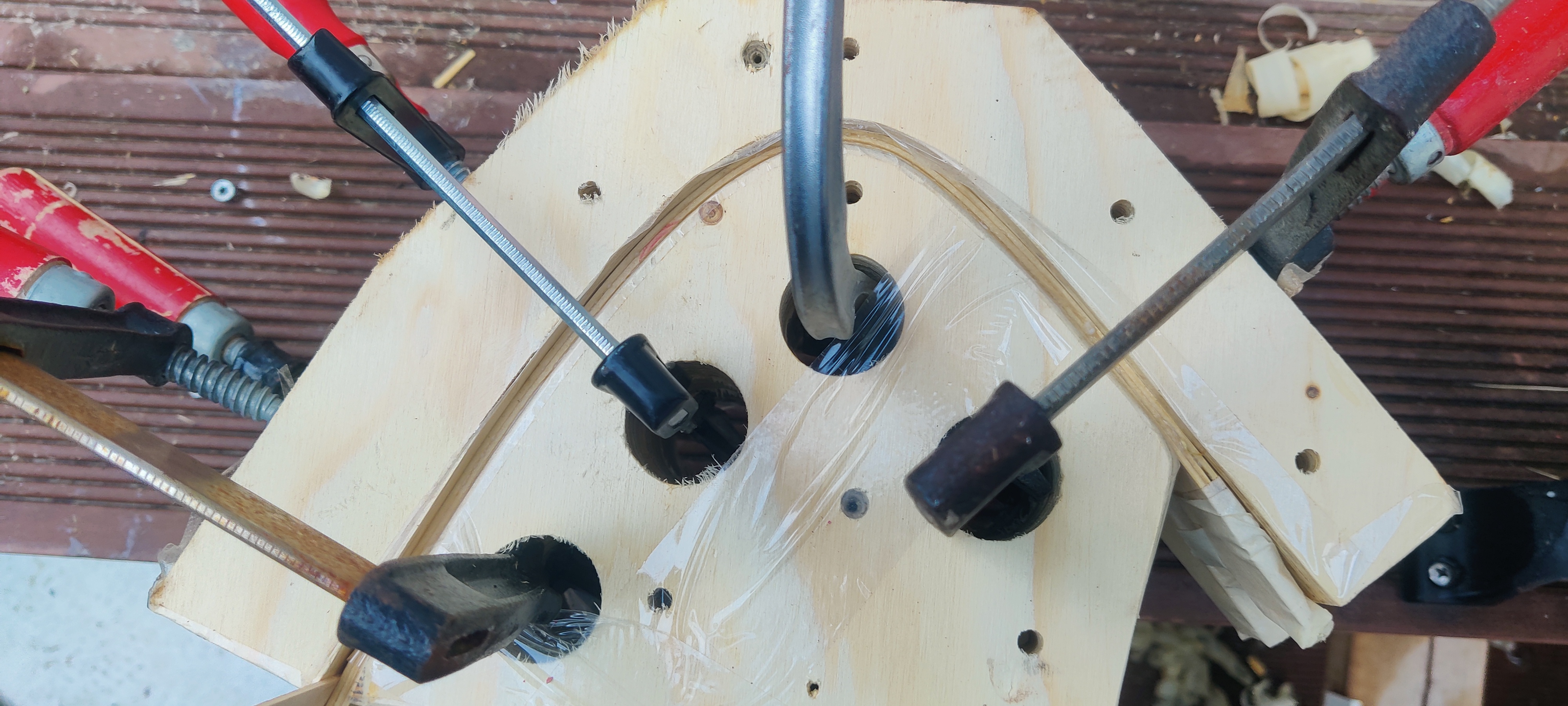

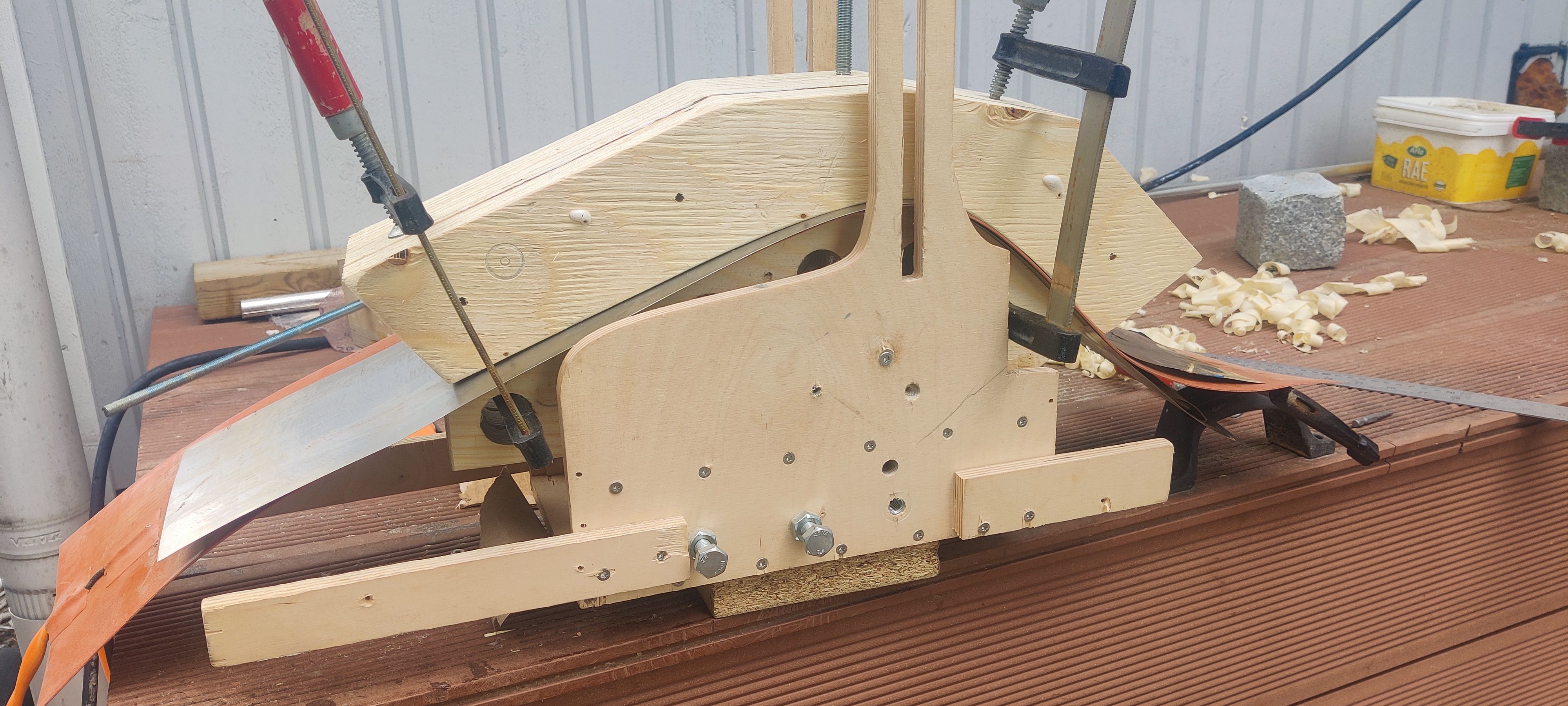

I had some difficulties to persuade my tight grain Carpathian (=European) spruce to bend with traditional bending iron. After few trials, I decided to use the CNC to make bending form a bit wider to be used in my bending machine. The form is ~80mm wide so it accepts 2 pcs of braces 35mm wide in parallel.
I bend the spruce with following setup: 0.3mm steel, 1.7mm spruce, silicone heat blanket, 0.,3mm steel. So far have got 0 failed bendings.
After being encouraged more, I will try to stack the wood to test if I can make the bend at once meaning I would make only one bend to get braces for 3 guitars.
Following the bend, I use the same forms to laminate the 3 spruces together. 2 x 35mm in parallel. This way I can minimize the waiting time and glue curing time and produce enough braces for one year build cycle (at my pace) .

Greg, I bent first pair topping to 150C. That was obviously too much, I have now a brace set with thermo treated spruce to experiment with :-)
Next batches were bent 130C and turned out perfect.
I did find out that Trevor's lamination method with band clamp may be better than the mold I tested: I found some braces having slight gap between laminates (gap filled with epoxy so it should not matter stiffness point of view. )

I also tried molds but found the band clamp method worked better.
