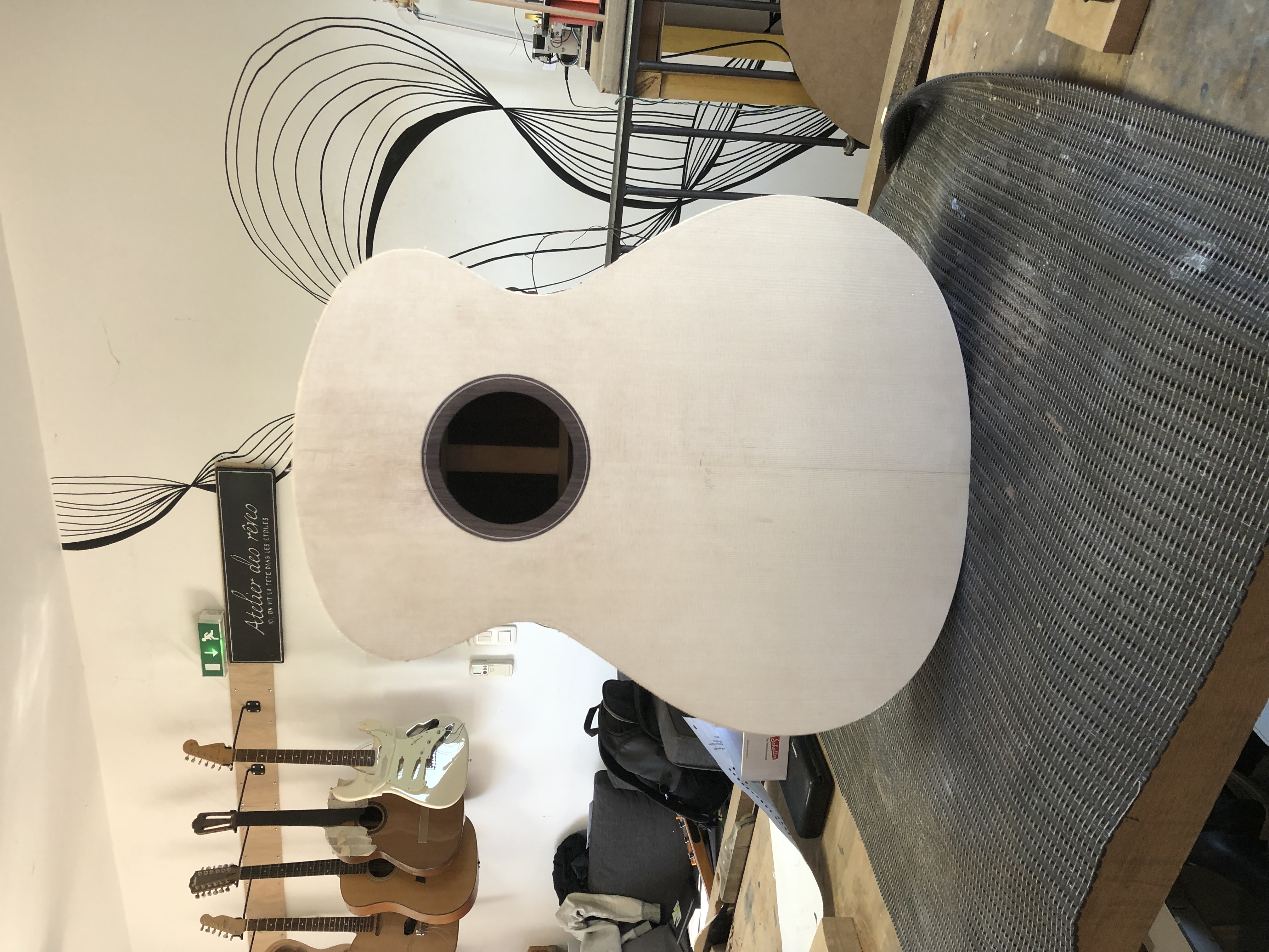

By the way, here is the guitar currently being built.
I’ll keep this feed updated when the guitar is complete. :)
