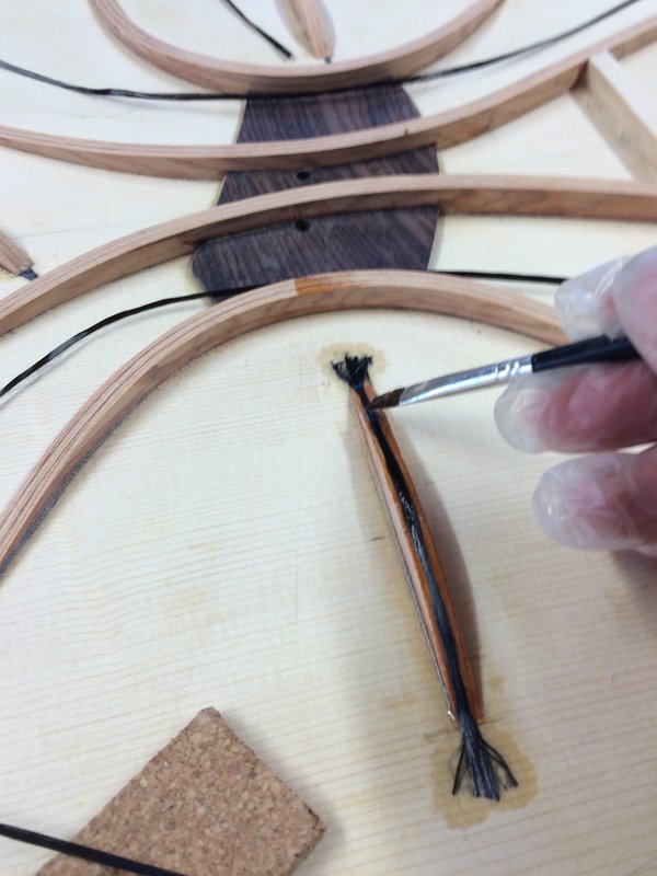

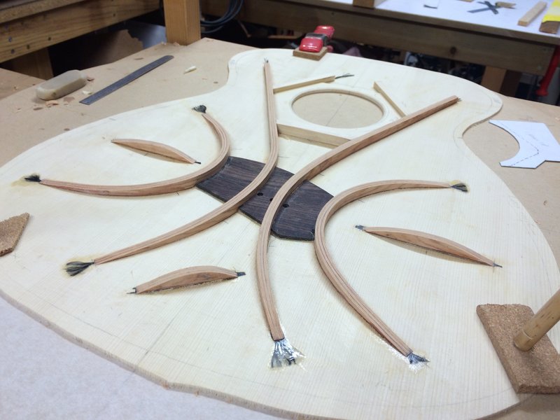

You mean the Smith wedgeMark McLean wrote: ↑Tue Feb 12, 2019 7:17 pmWhat about combining a Manzer wedge with a Gore rest, to reduce the overall width?
I'd put the extra one to one side, rather than spread the bracing. Probably not much in it either way, though. Other issues may force your hand when you tilt the bridge and bracing array.Mark McLean wrote: ↑Tue Feb 12, 2019 7:17 pmCan I ask your thoughts about how to space 7 bridge pins with falcate bracing?
Re: Adapting the method to multiscale and 7-strings?
Forgive a forum newbie inquiry. I've come to the fountain of falcate knowledge looking for some answers. I'm building my fourth falcate guitar and considering making it a multiscale. I'm wondering whether it's best to shift the falcate bracing pattern to account for the angled bridge in a multiscale, and if so, how best to go about it. I suspect this has been covered here before, but my attempts to search the forum brought up only the current thread. Any input/guidance would be most appreciated. I would also be interested in Trevor's thoughts regarding multiscale guitars in general. Thanks!
Simply offset the short tertiary braces to suit bridge wing ends and adjust arc of secondary braces so there is roughly equal areas of top between braces. My multiscale Gore build is documented here on the forum.tvanevery wrote: ↑Thu Feb 28, 2019 11:52 pmForgive a forum newbie inquiry. I've come to the fountain of falcate knowledge looking for some answers. I'm building my fourth falcate guitar and considering making it a multiscale. I'm wondering whether it's best to shift the falcate bracing pattern to account for the angled bridge in a multiscale, and if so, how best to go about it. I suspect this has been covered here before, but my attempts to search the forum brought up only the current thread. Any input/guidance would be most appreciated. I would also be interested in Trevor's thoughts regarding multiscale guitars in general. Thanks!
