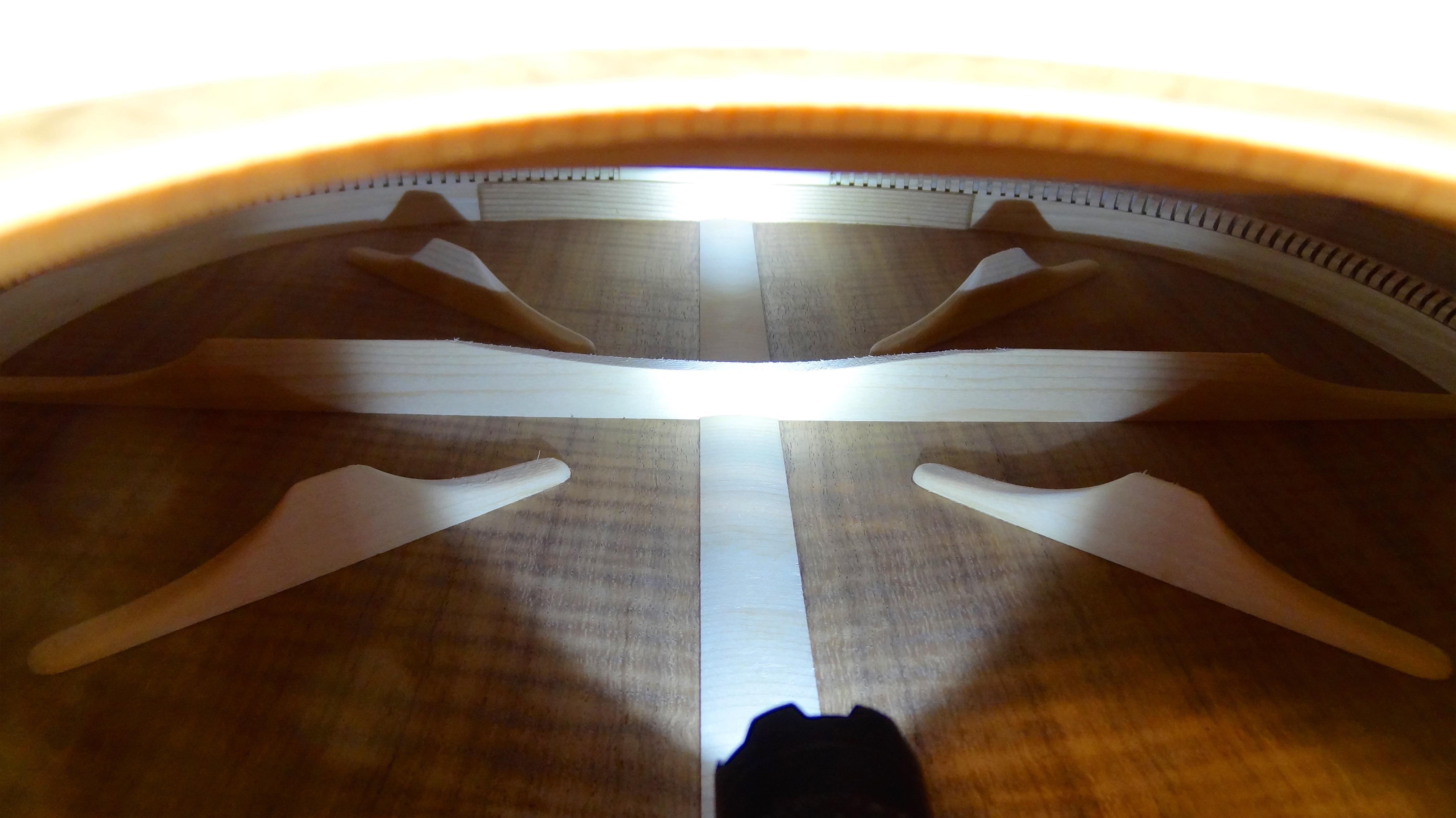

I have completed the box of my first falcate braced guitar and would be grateful to you all for some input/advice on the resonances it has at this point.
Some details:
OM sized medium body.
14 fret body join.
Tzalam back and sides (752 Kg/m3).
Sitka top with a bit of bear claw figure (382 Kg/m3).
Sitka falcate braces. Primary & secondary max height of 6.5mm over the bridge plate.
Planning on a live back.
Can add side mass if needed.
Frequencies measured with no bridge or saddle.

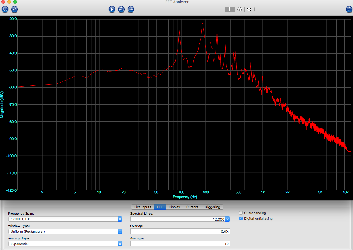

Target for finished guitar T(1,1)1 = 90 Hz. …..............Measured at 95 Hz.
Target for finished guitar T(1,1)2 = 170 Hz. ….............Measured at 187 Hz.
Target for finished guitar T(1,1)3 = Not really sure?…..Measured at 235 Hz.
I have included the spectrum analysis for people to judge. Is it close to looking like it should?
The T(1,1)2 seems a little low for this stage of the game. Is this correct?
It seems like the T(1,1)3 is a little high, but I can't seem to find a reference to what it should end up at. I have not relieved the primary lower bout back brace too much at this point (see photo) and can do more as required. My feeling is that more needs to be taken out and the back and top are not fully coupled at this point; the back is not truly 'live' yet.
I would love some help on how to proceed in attaining my target frequencies.
Thanks,
Eric

Eric, check out Fig. 4.6-3 in the Design book, Section 2.4.1.2 and Appendix VI.

Thank you Trevor,
Those references help considerably. I'm going to dive back into the books in more detail to proceed, but in your opinion, would you continue to relieve the back brace at this time, or wait until the bridge and saddle are attached? It's not nearly relieved as the books suggest to start with, but I want to proceed with caution so as to not go too far.
Thank you again.
Eric
Thank you again.
Eric
- Posts: 1642
Re: Help with my spectrum
I'd leave it at the moment. It gives you more options later.
