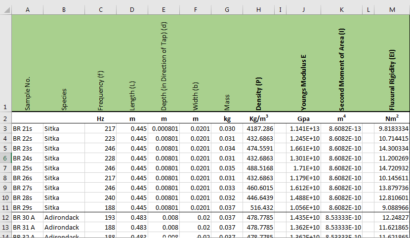

I'm just figuring this out as well. I just made this little chart and I think it looks ok though I'm not sure if 14 Nm2 is too high for spruce of these dimensions. Any thoughts?
- Posts: 1642
Re: Calculation of brace Young's Modulus (eq. 4.4-4)
You have too many zero in your first row of data, column E.
