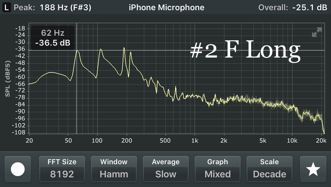

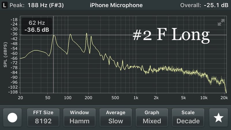

Hello everyone!

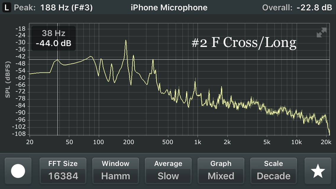

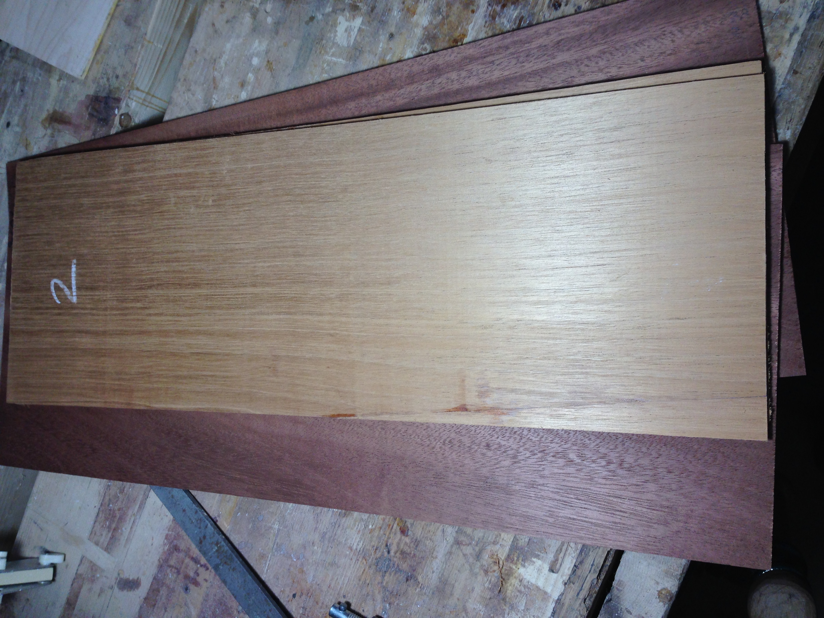

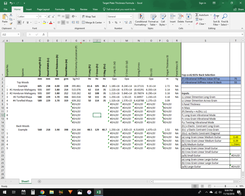

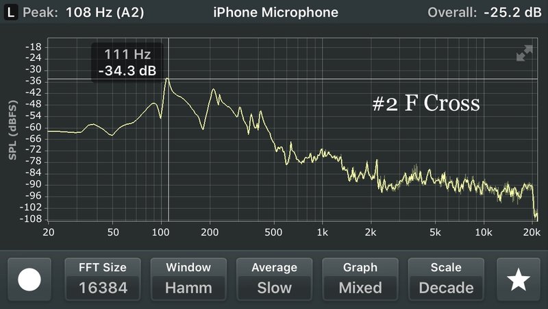

Can someone look over my data and see if I'm doing everything right. I have attached photos of the board (#2 Honduran Mahogany) the FRC's for the frequencies and the excel sheet. I am not sure if I am reading the FRCs correctly. Basically I am just referencing the elastic constraints excel sheet and finding the peaks that match around that frequency. Any comments would be greatly appreciated!
John from Canada!
John from Canada!

John,
Your frequency measurements look about right. Check out Table 6.1 in the white book. Mahogany will fall between spruce and rosewood.
Your elastic constants are incorrect, though. Your numbers for E long (for example) should be ~ 10 GPa, which is 1.0E+10, not 1.xxE+16 as you have. Check your zero count, e.g. millimeters are 10^-3 meters etc. Mass should be in kgs not grams. Target thickness in SI units would be in meters but are x 1000 to give millimeters in Table 4.5-3.

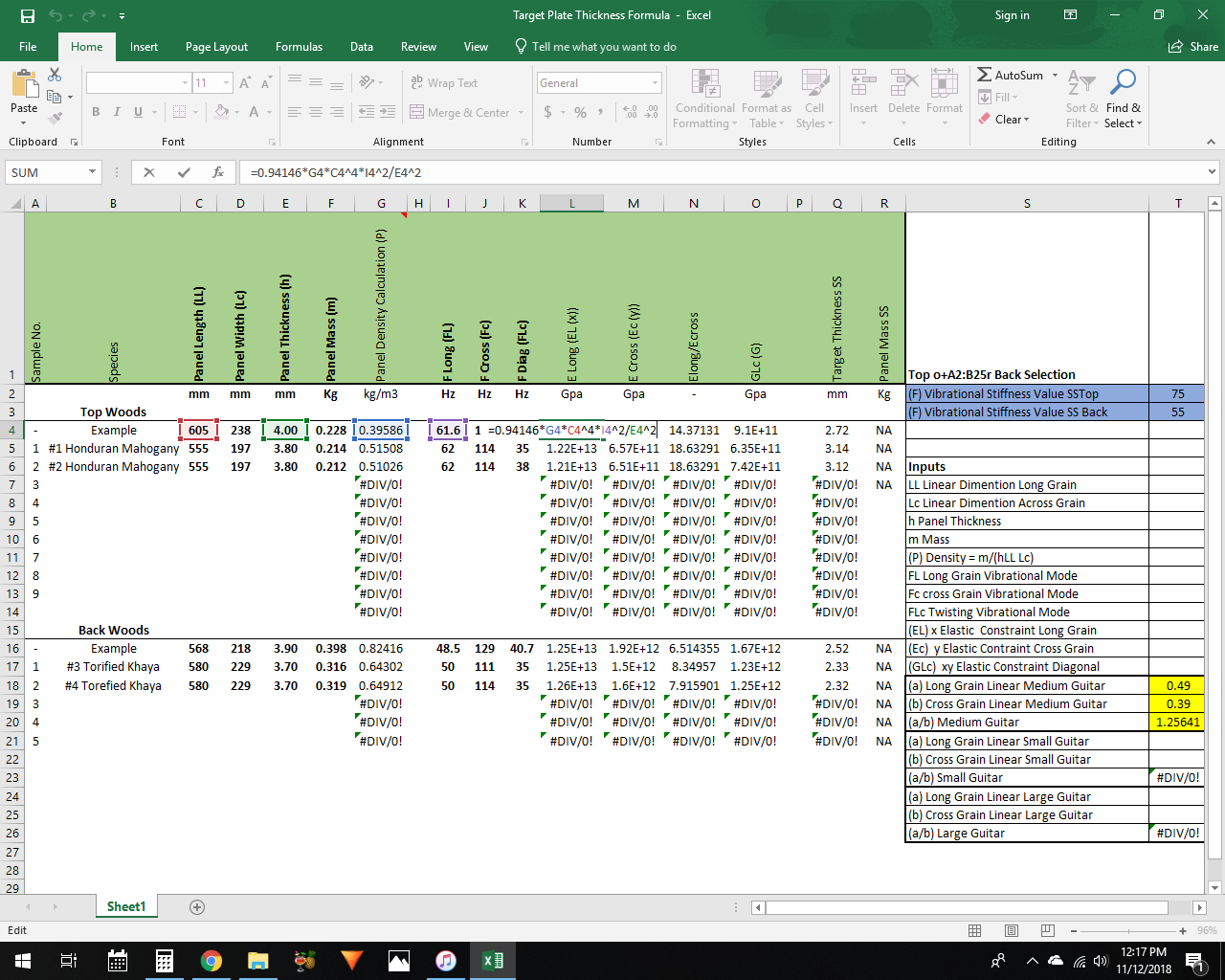

Thankyou for looking over these calculations! I changed the grams to kilograms. I attempted to change the calculations for F long but when I reduce the power to equal 1.0E+10 it changes the target thickness. How did you set up the formula in excel to calculate F long? I have attached a screenshot of the formula that I used on "Example" for top woods.

Re: Measuring Elastic Constraints - Lookover
John,
Carefully check Table 4.5-3 in the black book, especially the density numbers. You're showing 0.395 Kg/m^3. Should be 1000 times that.
Also check out these threads:
viewtopic.php?f=33&t=4019
viewtopic.php?f=33&t=3626
The 2nd edition of the books has everything fixed.

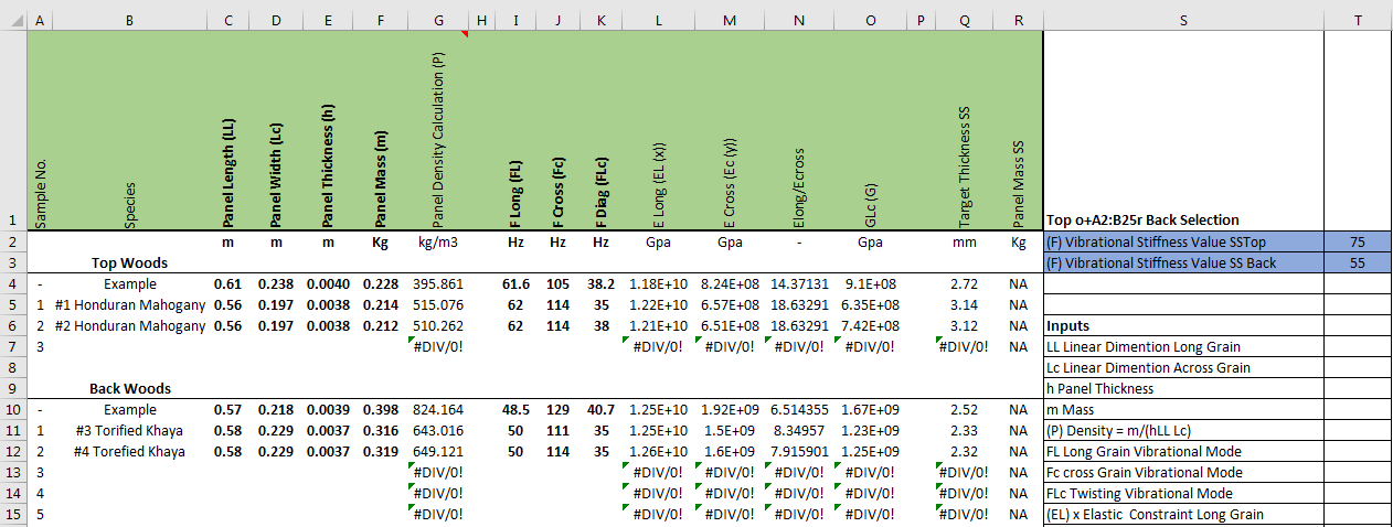

Hello everyone!
I think I got the equation! It was mostly keeping all the numbers in meters and kg. Can someone confirm with me that this all looks correct? Now to calculate the predicted mass! Exciting!!!! Yeahoo!!!
John from Canada!!! eh!!!!
- Posts: 1642
That looks about right, John. You seem to have replicated the Table 4.5-3 results.
