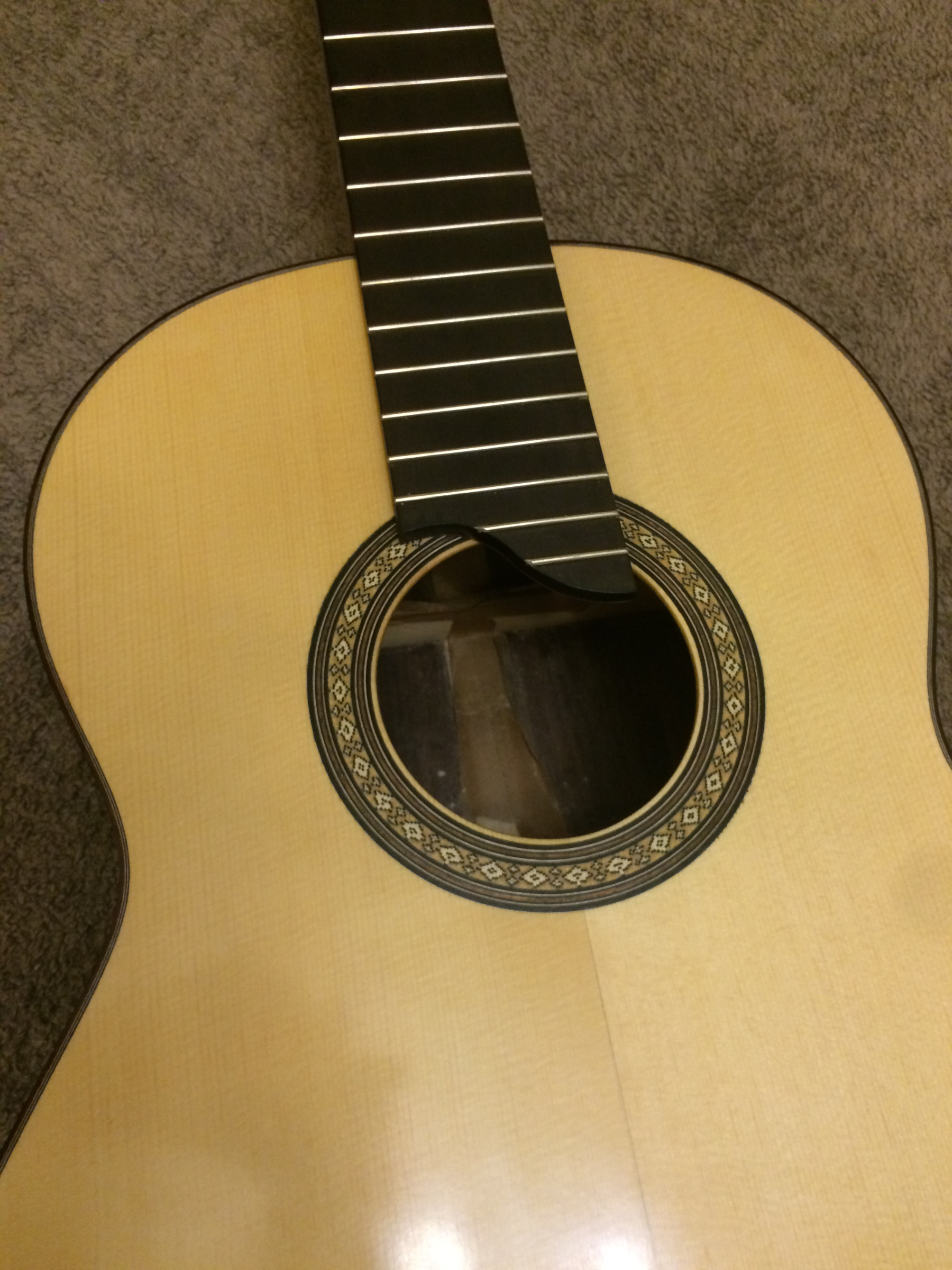

If you want to keep with the look of the Fleta then fretboard end is best flush around the soundhole. If you want the best practical option then go Gore style with the end of the fretboard protruding into the soundhole.jonwallace wrote:Do I cut the fretboard off square at the sound hole, or cut it around the sound hole with or without a 20th fret? Or overhang the sound hole like some of your other examples?
I think I'll quickly draw it out and do what looks best to me.
Thanks
Jon
Here's my current build....a falcate braced classical with bolt on/bolt down neck and treble side of fretboard end (including 20th fret) extending into the soundhole. I can just get my hand in through the soundhole but its a tight fit.

Thanks - a photo always helps.kiwigeo wrote:If you want to keep with the look of the Fleta then fretboard end is best flush around the soundhole. If you want the best practical option then go Gore style with the end of the fretboard protruding into the soundhole.jonwallace wrote:Do I cut the fretboard off square at the sound hole, or cut it around the sound hole with or without a 20th fret? Or overhang the sound hole like some of your other examples?
Thanks
Jon
I think the traditional style (end flush around sound hole) will work but needs a split 20th fret.
The protruding fretboard with a 20th fret will also look fine.
I think I'll sketch out both schemes before deciding.
Thanks for taking the time.

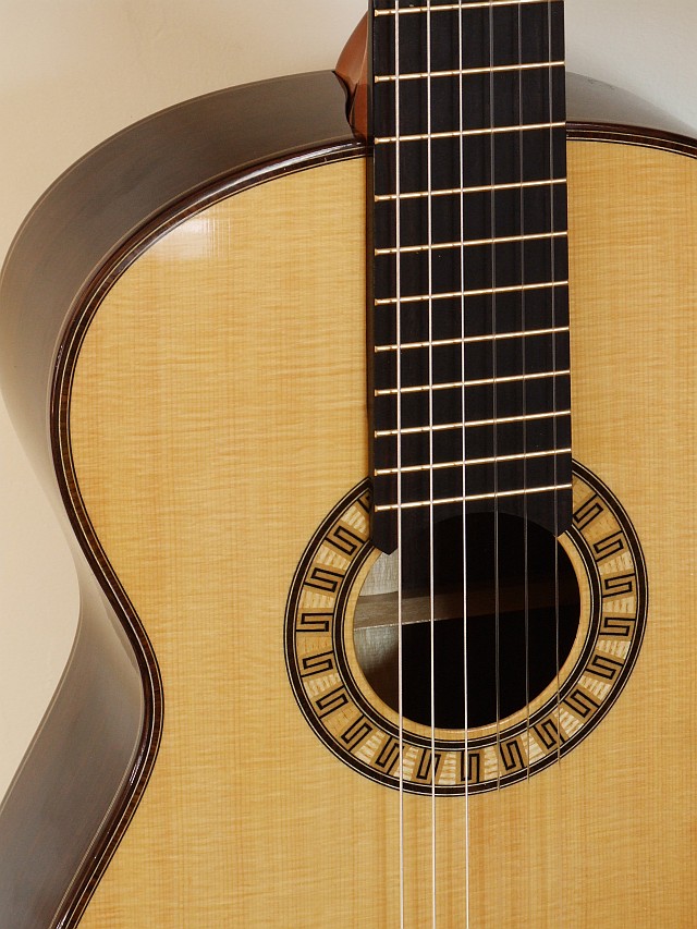

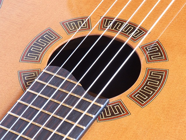

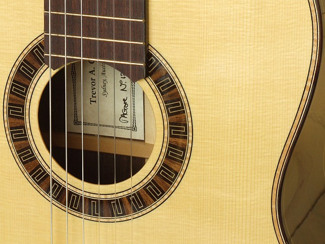

Not necessarily. Here's a treatment of a complete 19th fret:jonwallace wrote:I think the traditional style (end flush around sound hole) will work but needs a split 20th fret.
Here's an overhanging 20th:
Here's a complete 20th on a tilt-neck:
I've also cut the board end off square as per a steel string and I think I've also left the points on without the split fret, though I can't find a pic.
