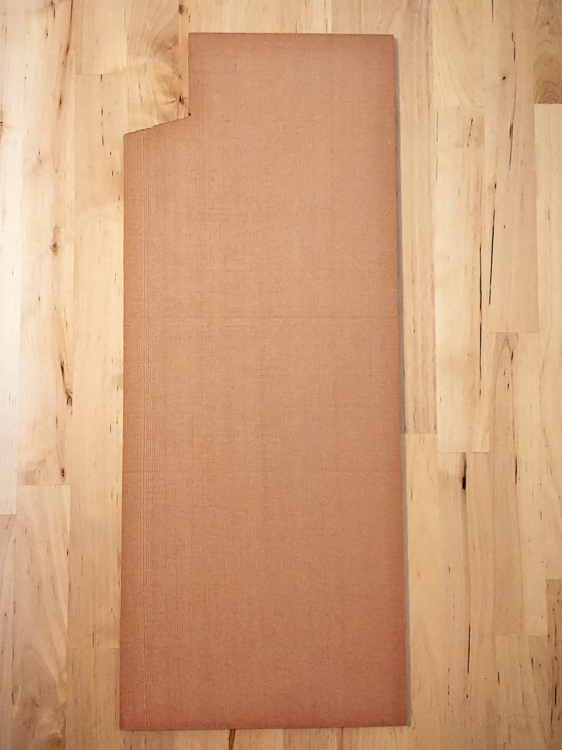

I received a set of LS redwood today, but it's shaped a bit irregularly. I know this can be an issue with some back sets as well. It tapped well enough (an understatement). What do we do in these situations?
Length: 535mm
Width: 214mm
Thickness: 4mm
Weight: 212g
Long: 82 hz
Cross: 42 hz
Twisting: 44 hz

In those circumstances I do a deflection test to derive the elastic constants. Adjust the supports so that the span covers just a regular shaped portion of the board.
