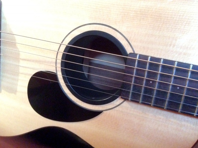

I finished a parlour last year, 480 long and 332 wide lower bout. X braced sitka, non scalloped.
Boxed up I got 117, 232, 279 after thinning the edges i got 114, 226, 278
Finished guitar with bridge 116,203, back not sure.
The frequencies were not where I wanted them and the G note on the bass E string had no sustain.
I added a tornavoz which is removable, it is 58mm deep and got to 90, 193, (260 & 276 split peak) I think it sounds much better for it.
The sound hole diameter was 95mm I think it was too large, I will use a smaller diameter next time.
Hope this helps Luke.

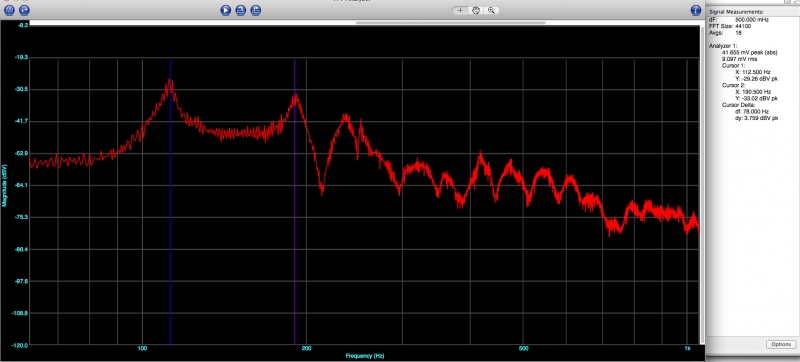

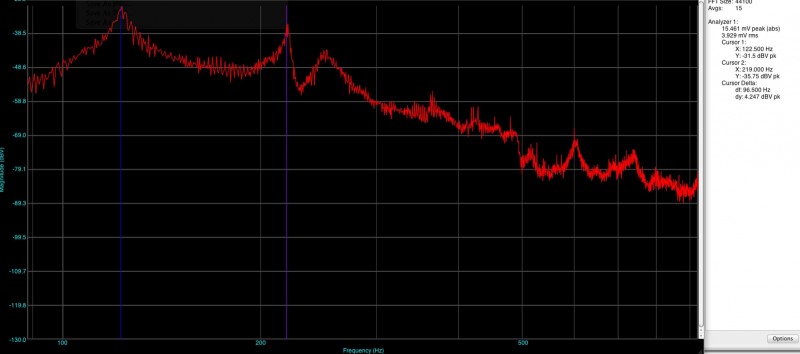

Post by soundshooter » Thu Mar 27, 2014 10:56 am
I posted some photos of a falcate parlor in the gallerie.
Here is the spectro of the finished guitar
113 190 238
Here it is with the box freshly closed.
122 219
Sorry there not the same size/sacale but it still gives you an idea how things developed. Good luck

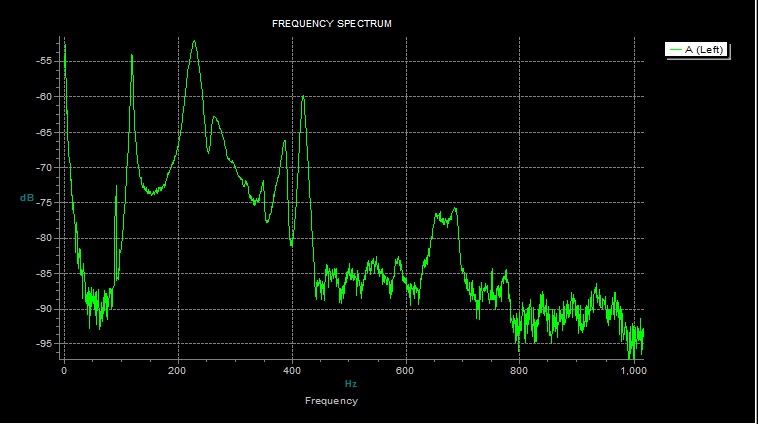

Since my post, I've thinned the top to 2.0 mm at the bridge area and 1.8 mm round the lower bout (it's really stiff and quite heavy Eurospruce) and have fitted the neck to take a few taps
I'm at 117, 227 and 262 Hz, and with the size I don't think I can expect to get down much more.
Parlour Specrogram.jpg (78.78 KiB) Viewed 25287 times
Looks reasonably lively.
X braced, so bridge (ABW, maybe around 25g) should bring the top down to around 217, see how it goes with the rest.
May have to bind the soundhole to bring the body frequency down a bit, as weighting the top and back (experimentally) gives me 115, 214 and 252(?).

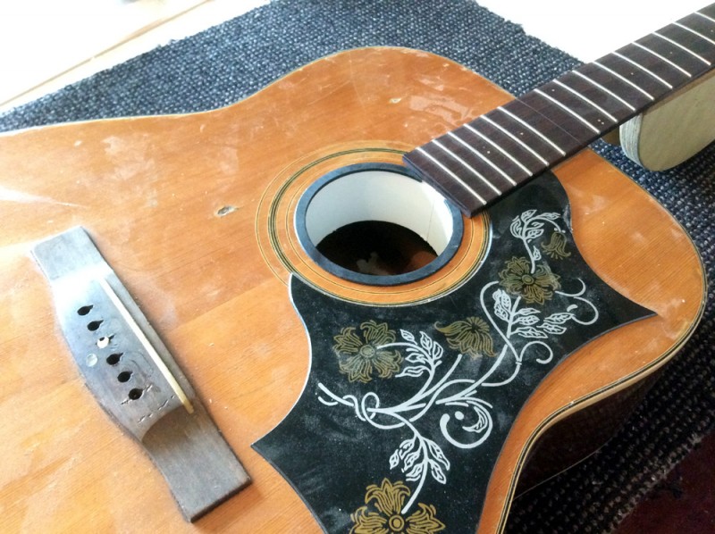

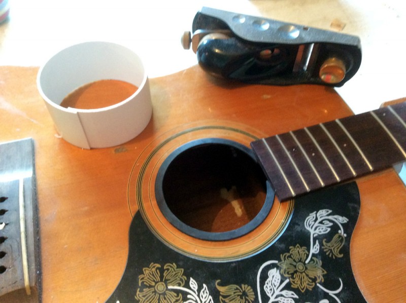

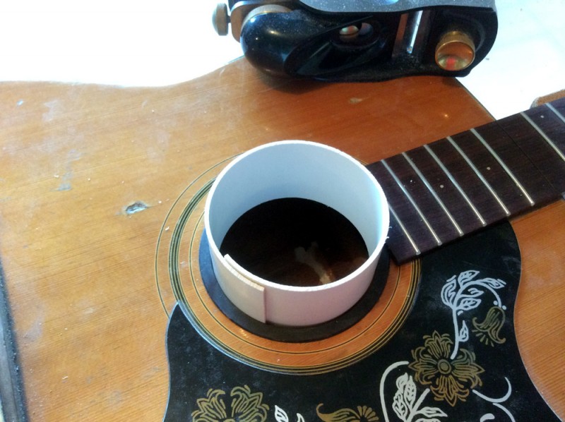

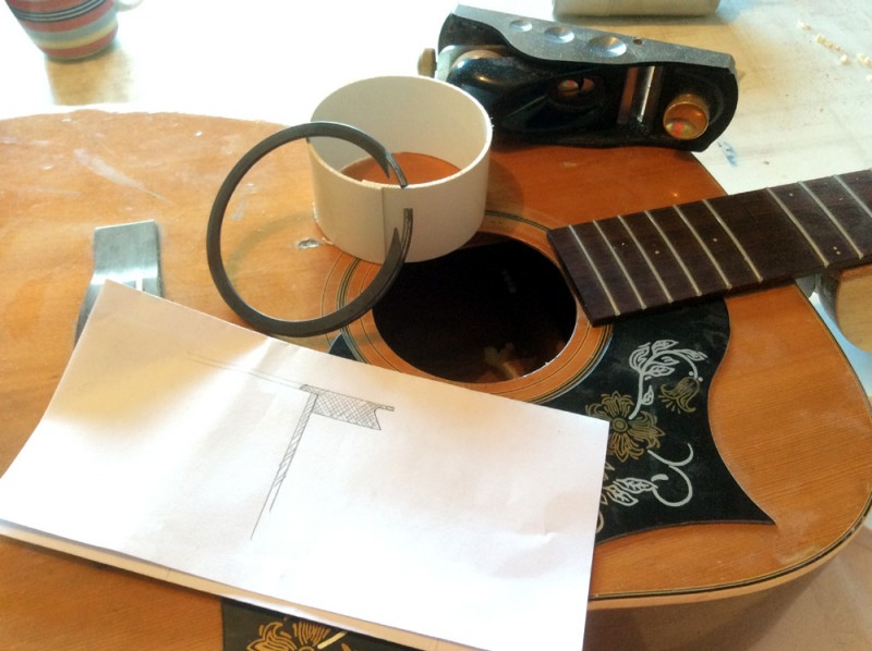

I made my tornavoz out of ply, laminate and PVC pipe it has two parts and I sprayed it black.
I took some photos of the prototype to show how it is made/installed.
Photo 1 is the two parts and a sketch/section to see the profile of the outer ring.
Photo 2 is the outer ring install
Photo 3 is the inner tube sliding through the soundhole, I used the length of this to adjust/tune the frequency drop of T1 which also changed T2.
Photo 4 is the inner tube in its final position, a rebate in the outer ring helps locate the inner tube. On the final tornavoz I used some small dowels to hold the inner tube in position.

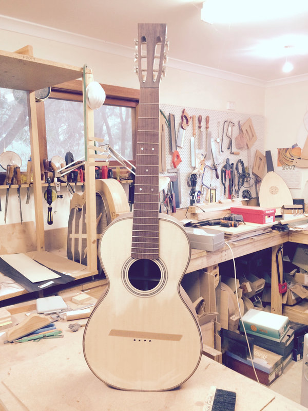

Post by kiwigeo » Thu Jun 11, 2015 11:06 am
Raw boxed up frequencies for my falcate parlour build (Scott Antare plan).
T(1,1)1 - 121Hz
T(1,1)2 - 213Hz
T(1,1)3 - 264Hz
Re: Parlour Build frequencies.
Post by kiwigeo » Thu Aug 06, 2015 8:05 pm
kiwigeo wrote:Raw boxed up frequencies for my falcate parlour build (Scott Antare plan).
T(1,1)1 - 121Hz
T(1,1)2 - 213Hz
T(1,1)3 - 264Hz
Re-did tap testing on the parlour today after thinning of top. Pics of the build will be posted once I get a chance.
T(1,1)1 - 112Hz
T(1,1)2 - 203Hz
T(1,1)3 - 269Hz
Once bridge is on Id expect T(1,1)2 to drop a Hz or two. Final frequencies look theyll be similar to Jims figures.
