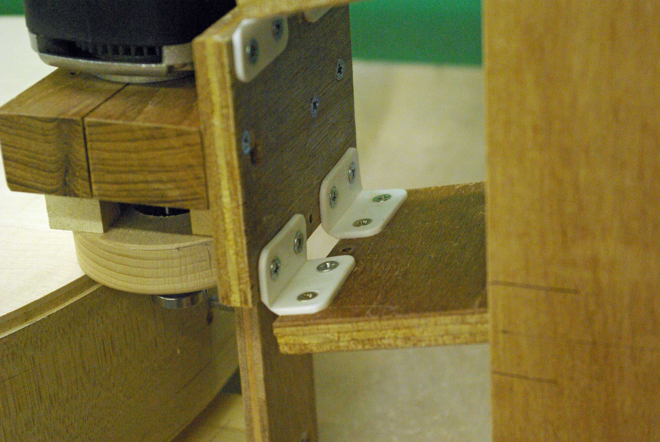

I originally built a binder with brass butt hinges but there was indeed a lot of play. The plastic ones were better but still left some flexing. However it didn't matter. Much to my surprise the Heath Robinson looking device worked really well. Well worth building. I got really clean, regular binding channels.
