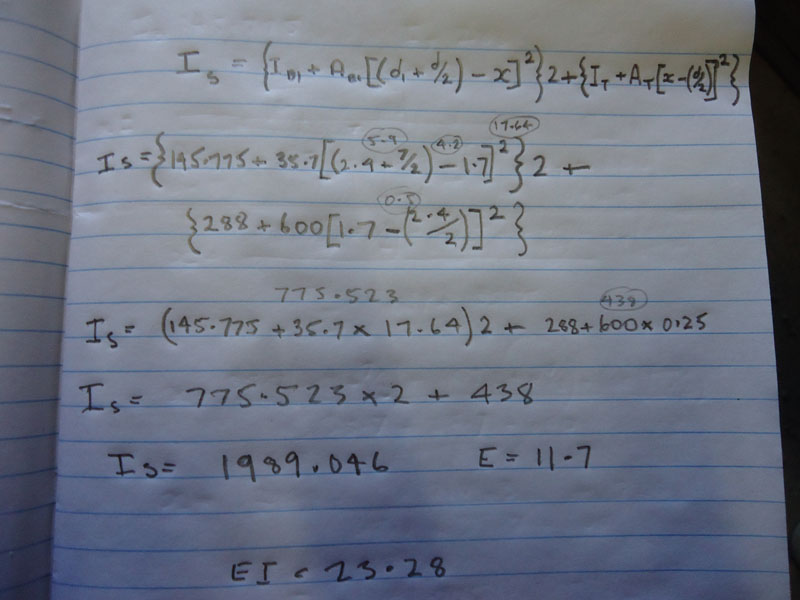

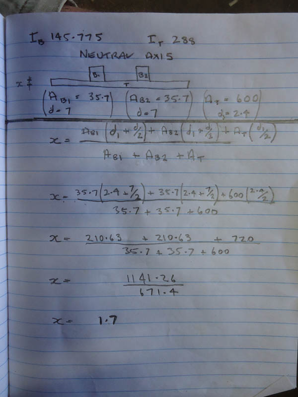

So I have been scribbling on paper, but still not sure if I have a grip.
I decided to try the maths without a thought to the CF tow and see if I got a answer that looked reasonable, still not sure if the answer looks reasonable cause if I increase the answer I got of EI = 23.28 by 26% (from the table on page 4-47) it doesn't get near Trevor's figure of 45-50. With that sized braces, top and E I get about 1.3 degrees of rotation. So am a bit confused still but not finished.
Here is a look at what I did (after a few attempts) and I am not sure if I have worked the formulae properly, I'm doing quite a bit of head scratching so will do a nit comb this evening just in case.

Re: Bridge torque v flexural rigidity
I have Excel Gary and use it for top thickness etc but like the top thickness stuff I like to try to get a grip on the maths by hand before I go to the spread sheets.
When I look at my design the secondary falcates don't really get to the 50mm mark (well maybe there is 0.5 - 1mm of them max at that point) so I just used the two main falcates in my equations.
I am very happy with the results of the two finished guitars so far but they still have room for improvement and I didn't use the flexural rigidity stuff for them so am working the brace size down on each guitar, the last one had 7mm mains and the one I am building now I have gone down to 6.4mm and hope that will get me closer to 2 degrees. The reason I attacked the flexural rigidity stuff is cause I want to make the same guitar in nylon strings and would like to get closer to what I want on the first try.
I use my own design that is a "parlour" (pic and sound clip in the Gallery of the first one) with a 320mm lower bout and 460mm long body and I do use CF tow as removing creep is a objective for me living in high heat and humidity cycling.
I am still a bit unsure of the CF in the equations other than to increase EI by 26% which is Trevor's closest match in that table (for 1 strand of 3K tow)
Sorry to take so long in getting to this, but I think you have sorted it out amongst yourselves. Well done!
For a falcate braced guitar, I do the EI calc. using the soundboard and 4 braces (primaries and secondaries) as the torque resisting structure. The idea of measuring 50mm in front of the bridge is so as to make the calculation tractable without the complexity and expense of using FEA. The method seems to produce meaningful and comparable numbers. For example, the koa guitar I built recently used this method and came out exactly as planned.
The EI calc is about getting in the right structural ballpark so that you avoid a roller-coaster soundboard. Some people people argue that roller-coaster soundboards sound better. For example, this was the motivation behind the Redgate "wave" top, but that, of course, is just someone's preference. There is no doubt that fine sounding guitars can be made without highly distorted tops.
The important things from an acoustical point of view are getting the monopole mobility in the right ball park, as this relates to loudness and responsiveness, and getting the modal resonances in the right places for the type of guitar you are building. The EI numbers I recommend are compatible with that, of course, but the 2 degrees of bridge rotation is just a number for guidance (you don't hear it), whereas you do hear changes in monopole mobility and modal resonances.
