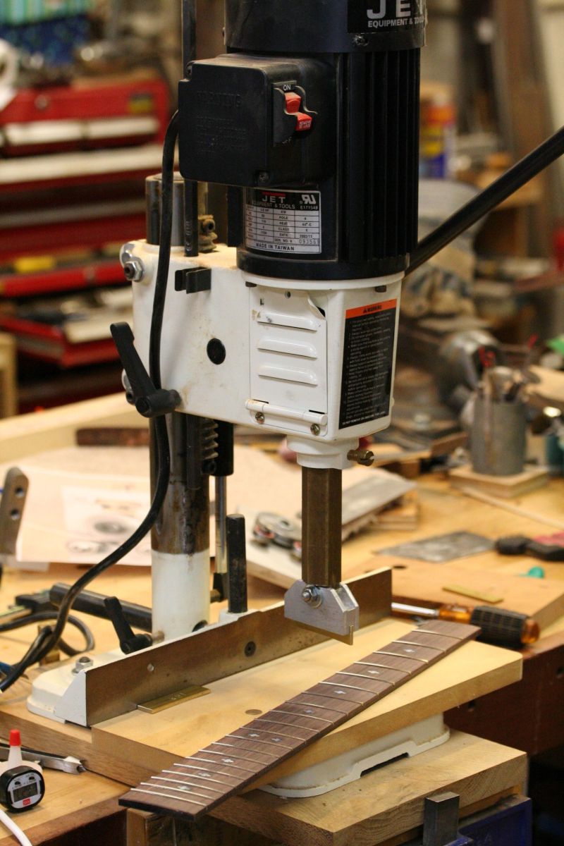

How about this for a fret press:
I had just finished mortising my first two necks from the book and I hadn't put away my Jet mortiser yet. As I was about to press the frets on my cheap drill press, which is near useless for the job, the light bulb went off. I can tell you, the Jet mortiser makes a very stout fret press
Dean
Dean

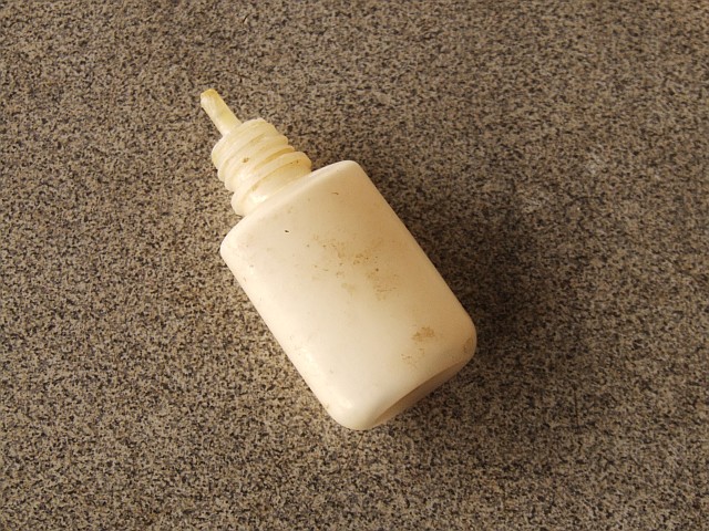

I use this little bottle, which I think originally came with a printer cartridge refill kit. I fill it with Titebond then I hold it vertically on the fret slot and squeeze gently whilst sliding it down the length of the slot. The hole in the nozzle is about the same diameter as the fret slot is wide, so it doesn't take much care to leave glue only in the slot and virtually none on the fretboard. Any excess can just be wiped off, as Nick said.
This little bottle is really good for rosettes, bindings etc., basically anywhere the standard Titebond bottle will give you an overdose.
If you Google "glue syringe" you'll likely find something similar, if you can't find anything suitable in your junk box.
I find the Jescar fret wire is best glued in as it seems to have a shorter tang than some of the other wire I've used.
Most of my fretboards are bound, even on the classicals, so I can't do the CA-down-the-ends trick.This little bottle is really good for rosettes, bindings etc., basically anywhere the standard Titebond bottle will give you an overdose.
