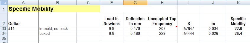

Hi, Trying to understand effective mass as it applies to the top's Monopole Mobility. In my most recent guitar, I ran the equation on the top while glued to the sides and clamped in the side mold, no back. Once the back was on, ran the same, not clamped in the mold. Other than the back and removal of the mold, there were no changes to the body. Here are the results*:
You can see the main change is in the peak resonance and subsequently the MM. I suspect the mold and clamp (two turnbuckle clamps pushing sides into the mold) are "mass loading" the sides and increasing the area of the top the is "effective". When the mass is removed, the effective area shrinks, increasing the frequency and the calculated effective mass. If the effective area shrinks, wouldn't this have a negative effect on volume even though it drives the MM number up. I thought MM correlated to volume or at least responsiveness, but to exaggerate, if my EA is only a couple square inches, there won't be much of either.
I'm having a hard time of visualizing what "effective mass" actually is in a guitar. Is it a real thing, or the result of a calculation. Is is the mass that actually produces sound? At 30-40 grams, this is only 5% - 10% of the mass of the assembled top. Is that really all the mass the affects the output of sound? Obviously, I don't have a very good handle on this.
* I know these MM numbers are high for flat top guitars, and even for the Selmer guitars I have tested. MM will come down with a neck, bridge and finish. From limited past experience, I would expect to it to come down to ~ 24. The best of these guitars seem to end up around 18-21 MM, so I may have overshot.

Maybe another way of asking this is whether effective mass equates to effective area (of sound board) somehow and if nothing else changes, if effective mass goes down, has the effective area reduced as well? Effective mass going down sounds like a good thing, but effective area going down does not. ????

Effective mass is a calculate figure that is representative of the amount of top (or back) that is moving and therefore radiating sound.
I think most of your conundrum can be explained by the fact that for a given force, less mass accelerates more and radiated sound level is proportional to acceleration.
Measuring guitar resonances whilst it is in a mould is how I discovered the mass loaded sides effect. As I see it, the benefit of measuring MM whilst the guitar is in a mould depends on whether you can find a relationship between that and how it performs out of the mould. I've never looked at that.
A quick look at my numbers indicates that effective mass is around 30% of the total top mass. There's a lot of mass in the upper bout, which doesn't vibrate very much. If you consider the area inside the node line of of a monopole Chladni pattern I'd say effective mass is comparable to that the mass of that area. Remember, it is called monopole mobility.
Damping the back, in my experience, produces only that, i.e. damping. It doesn't seem to alter the coupling. An example of that is that I found that for additional side mass to "work", it has to be bolted in really tightly. If there is any relative movement between the mass and the sides you don't get the intended effect.Craig Bumgarner wrote:One more.... Given the vagaries of whether a top is coupled to the back and phase cancellation method of "uncoupling" the top from the back, does simply dampening the back by holding it against my chest as I tap the top, (along with plugging the sound hole) insure the top is uncoupled? Maybe this introduces errors of its own like mass loading the back.
