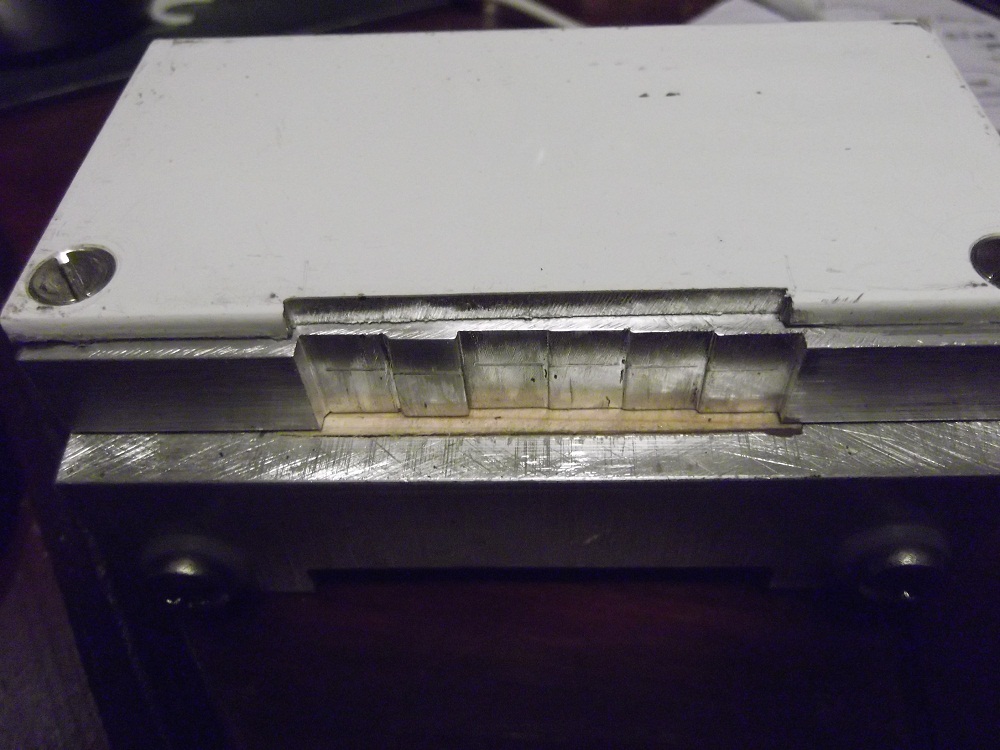

I might Disapoint you Dom, Cause I'm Going to make the steps fixed by carefully filing steps in a aluminiun block , I'll just make one for classical and one for my standard OOO S/S which I fit 12 -54

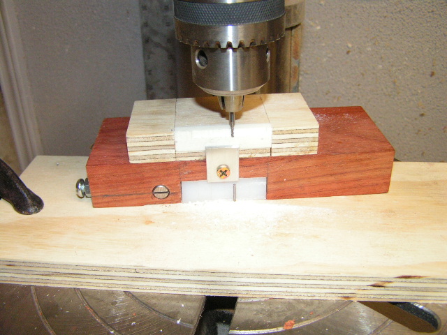

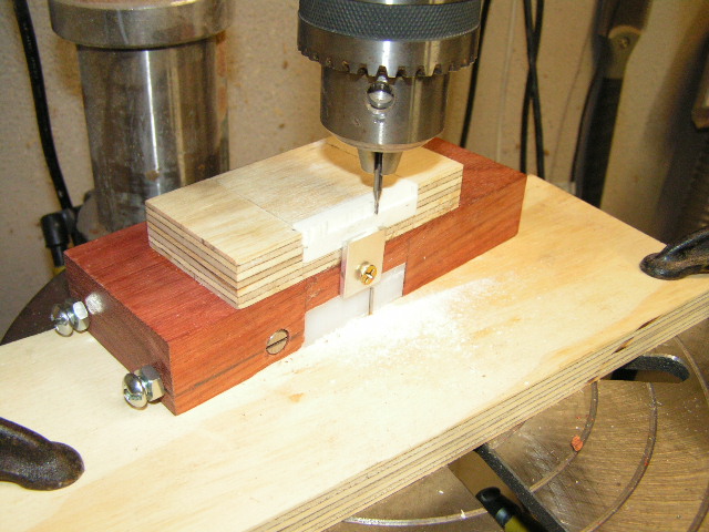

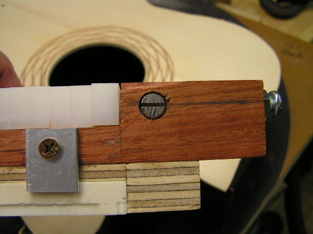

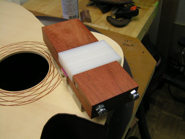

here is my rather simple, but effective jig using hdpe for the guides...the four middle pieces cut to .300 wide the end ones are .400 wide to center in the 2 inch slot and give proper spacing..on a 1.75 inch nut.

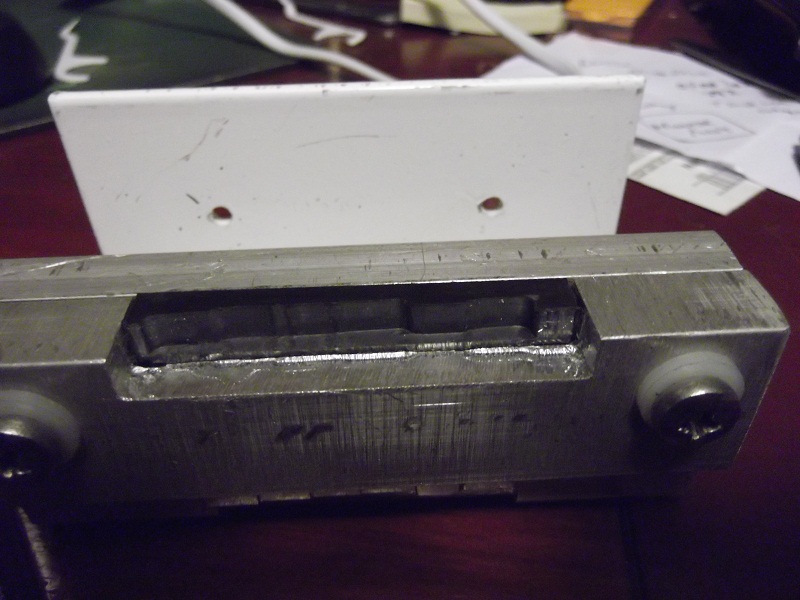

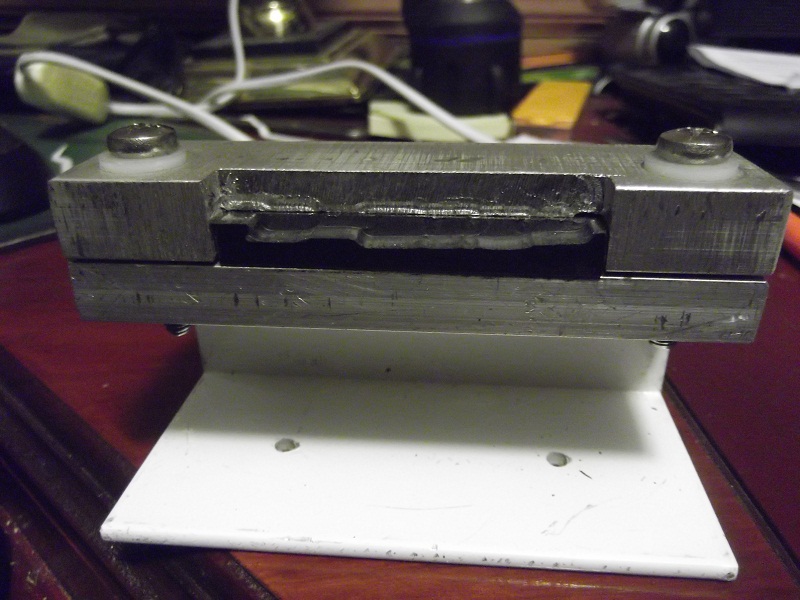

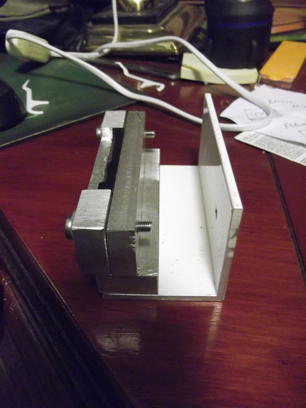

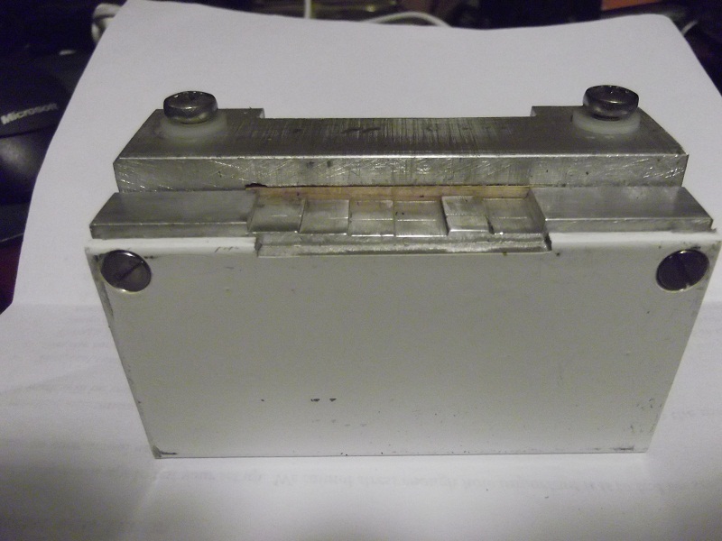

Mine is even more "Agricultural" but it did the Job .
