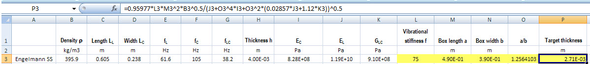

Re: Equ 4.5-5
Hi Trevor,
I have a question about equation 4.5-5 and 4.5-7. I am using the numbers from sample 1 on Table 4.5-3, converting them to what I believe are the correct SI units, using the Poison's Ratio constant 0.015 (using the 0.02 constant increases the difference I'm getting), and have been playing around with the brackets. I'm still getting a different number than what is on the Table. Am I making an error with my decimal placements?
Below is the equation as I'm entering it into Excel.
Thanks--Oliver
Equation 4.5-5
Density 395.9
Plate length 0.605
f long 61.6
thickness 0.004
=0.94625*B1*(B2^4)*(B3^2)/(B4^2))
Answer 11902942470.
Rounded Answer 11.90 GPa
Should be 11.96
Difference 0.05705753
As Percentage 0.48%
Below is equation 4.5-7, is there a similar problem with my inputs?
Thanks--Oliver
Equation 4.5-5
Density 395.9
Plate length 0.605
f long 61.6
thickness 0.004
Answer 11902942470.
Should be 11.96
As Percentage 0.48%
- Screen Shot 2012-06-20 at 12.43.30 PM.png (42.93 KiB) Viewed 51221 times
- Posts: 1643
Re: Equ 4.5-5
I've assisted a good few other people in getting their spreadsheets to work, using the equations as per the book.
Typically, Elong comes out at 11.90GPa and the thickness at 2.71mm, which is close enough to the answers in the book and different for the reasons given higher up in the thread and insufficient difference to give a problem.
I can't see a problem (doesn't mean there isn't one!) in the way you have coded Equ.4.5-7, but we've found that Excel is notoriously bad at dealing with this equation due to ill-conditioning. I have seen the equation coded pretty much as you have it and it turns out OK, so it may even be a computer dependent thing.
All I can suggest is that you put the computation together differently, splitting it across a number of cells, and see if you can get closer. Jeff and Dom, above, had a similar problem and fixed it like that. It's a worry, though. I'm sure half the world's financial systems are run on Excel!
One thing to try is SQRT(x) rather than (x)^0.5 and x*x rather than (x)^2, as I think these are the algorithms where the major problems lie. When you've fixed it (I'm sure you will) please let us know what worked (and the machine/software combination that you're working with).
If you continue to have problems, PM me with your spreadsheet.

Re: Equ 4.5-5
Instead of a constant of 0.95977 use this equation =(1/((PI()/2)^2*(3/2)^4))*(12*(1-0.02)) or 0.941461428. Use this number to also calculate El and Ec and use =3*(1/(PI()/2)^2) or 1.215854204 to calculate Glc. Using these numbers you get exactly what is in the book.
I figured this out looking at the equations we used during the course and found this difference. Not material in terms of the end plate thickness but nice to get the same answers.

- Posts: 1643
Re: Equ 4.5-5
Just for clarity, the modification that Dom illustrates here is the same as I was talking about here.
After the differences had been noted, I revised the modal tuning course notes. Not quite so easy to revise the pages in the book...
The spurious results that Excel throws up occasionally are still a mystery, though. Obviously if you're not getting them, nothing to worry about. All my workings are with Windows XP 2001 and Excel 2002 SP3, so maybe it's something that has been fixed with more recent software.

Answer 2.824681683
Vibrational stiffness 75
Length 0.49
width 0.39
Density 395.9
Youngs modulus along grain 11902942469.937
Youngs modulus gross grain 828243121.854775
Glc 0.91
a/b 1.25641025641026
0.941461428*B1*B2^2*B4^0.5/(B5+B8^4*B6+B8*2*(0.02857*B5+1.12*B7))^0.5*1000
Answer 2.770798056

OK so I finally got started on a couple of falcate braced classicals. Unlike the recently finished instrument which was built spanish method these two these will have bolt-on necks.
The last two days have been spent dicking around with a spreadsheet to work Equation 4.4-5. Finally got thing working late last night.....talk about a major erueka moment.
Today I spent time tap testing and pinning down Young's Modulus along and across grain and GLC. The top is Engleman Spruce from Graham Hein and results were as follows:
Mass - 150gram
LL - 580mm
LC - 205mm
h - 3.9mm
F Long - 63.6Hz
F Cross - 105Hz
F diag - 47Hz
Vib stiffness - 60
a - 490mm
b - 390mm
MOS EL - 9.21GPa
MOS EC - 0.39GPa
Shear Modulus (GLC) - 0.81GPa
Target thickness works out at 2.3mm
Mass - 150gram
LL - 580mm
LC - 205mm
h - 3.9mm
F Long - 63.6Hz
F Cross - 105Hz
F diag - 47Hz
Vib stiffness - 60
a - 490mm
b - 390mm
MOS EL - 9.21GPa
MOS EC - 0.39GPa

That looks in the ballpark Martin, so well done!
