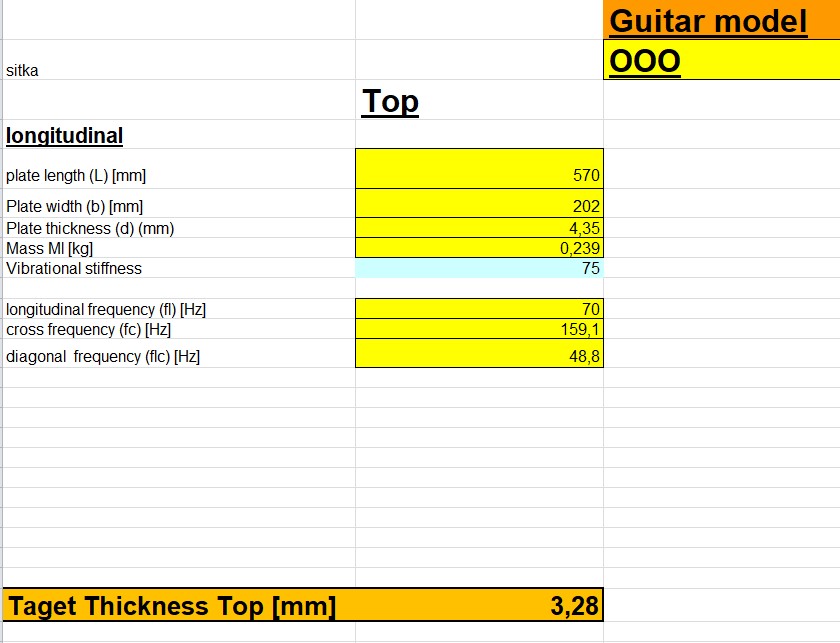

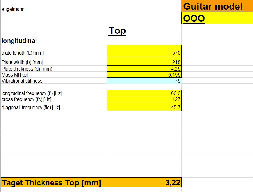

I have one sitka top and one engelmann top left. I did my tests again and come up with the following values:
sitka:
for the engelmann top:
Before I have to scrap those again is there anyone who can give me some advice if these values make sense? I thought the difference between sitka and engelmann would be bigger and actually I never had a suggested thickness of around 3.3mm for a sitka top.
And yes, I did the tap testing for both panels several times. The values changed almost not at all. 1 or 2 Hz at most.
As I said I would be grateful for some advice. I´m getting frustrated. Especially because I don´t find the reason for what´s happening.

Ahh, I forgot: you need the box size for the guitar
a=520mm
b=385mm
If I use the values from table 4.5-3 I can reproduce the target thickness.
a=520mm
b=385mm

Jurgen, I put your numbers through my spreadsheet and got 3.15mm for the Sitka (twice) and 3.22mm for the Engelmann. So I suspect you may have got the data entry wrong on the Sitka, unless the data you posted is your actual spreadsheet, in which case something really weird is happening.

Thanks for your reply Trevor.
For the sitka I found a small mistake. After correcting it I got the same result. So that seems to be ok. In the mean time I also checked with the deflection method and found quite similar results. So for this time I think I can trust the values for the target thickness.
