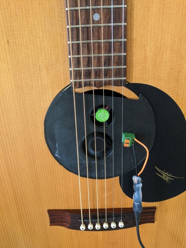

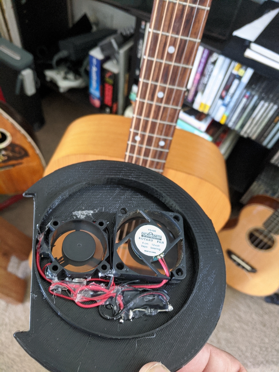

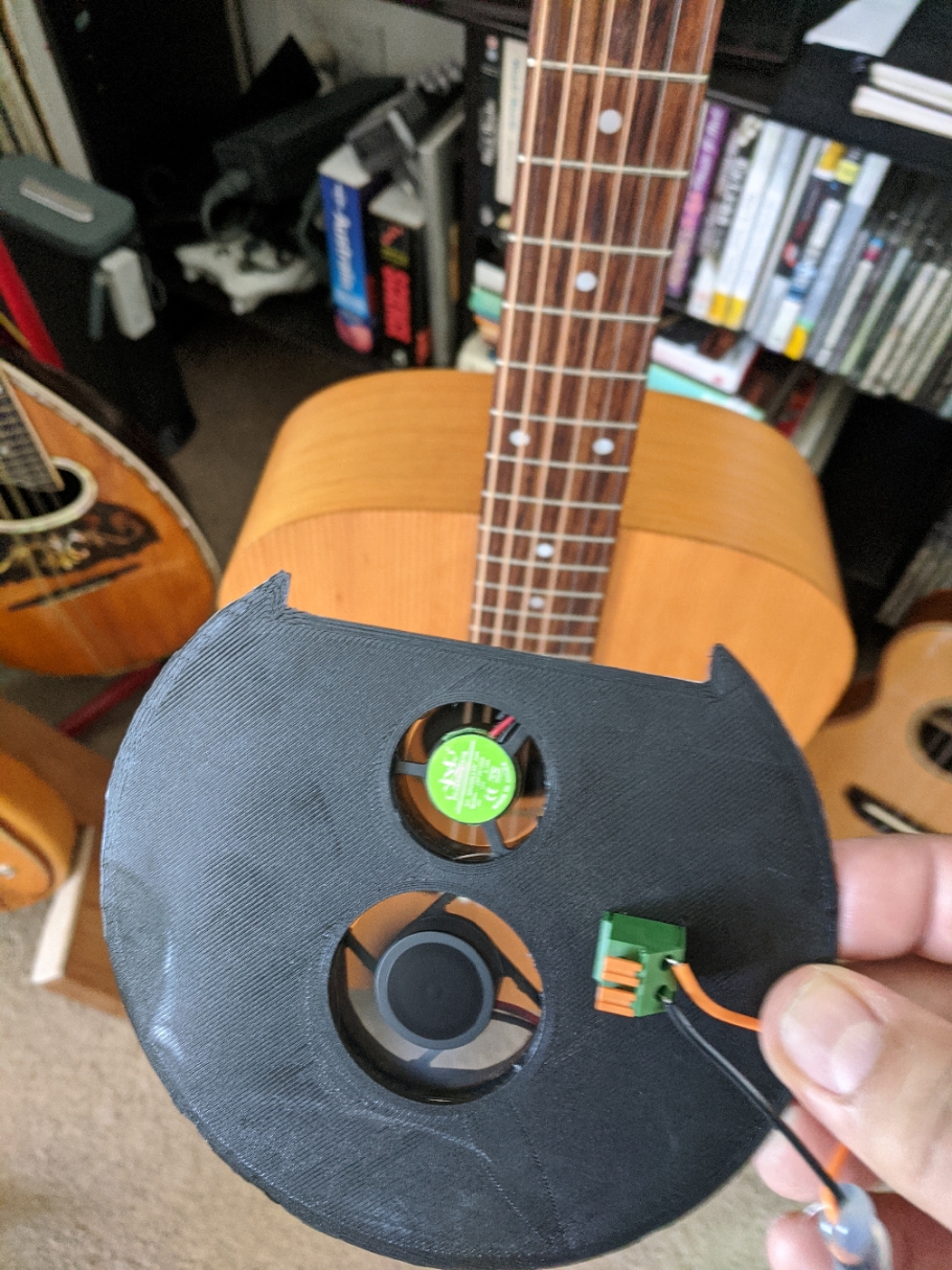

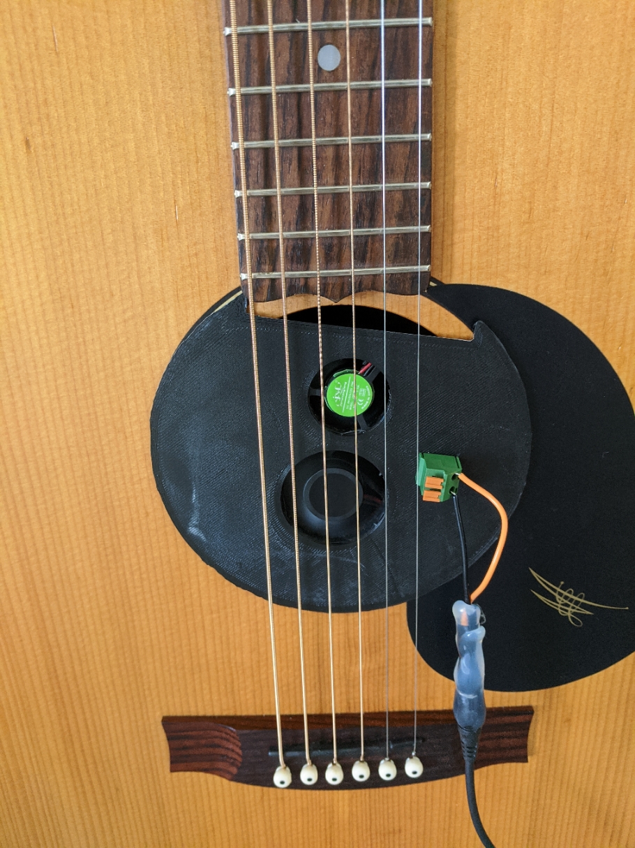

4: after 24h, to give the inside more air circulation, I used 2 small 12 V pc fans with a small cover 1 blow in and the other suck the air out (which I printed with PLA on a 3d printer as in the attached pictures) to force fresh air in and for 24 hours and after that, the smell was gone. you don't have to print a cover if you want to use a pc fan. you could use some cardboard or some thin wood like balsa or you could simply use masking tape and secure the fans on the soundhole. I hope this information helps if anybody has the same issue.
