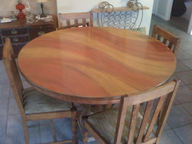

Ok Ill start :P
Here is my 4 seater dining table made from jarrah with matching material from our lounge.

How does it sound ? :lol:
Seriously though, nice work there Tim

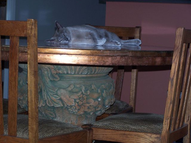

Done a few things over the years, but never took photo's of them. Sort of kicking myself now, but I could always make them again right. :D
Anyway, we did bring this with us when we emigrated from Canada, so easy to snap a picture of it.
This is our dining room table. The top is made from 4 sheets of MDF that I laminated together and used a 1/2 router to cut the shape out with a home made jig. Painted in a pattern of marble that I had a sample of. The colors went really well with the home we had. I also had my first go at applying copper leaf to the edge. We love the table, and will probably have it until we fall of the perch. It ways a feaking tonne, and takes 2 very strong men to lift it.
The base is a cement garden fountain that also ways a tonne. Chairs are some beaters that we picked up at an auction, or rather my Mother did. I told her what we wanted, and she got to spend my money. My Dad loves it that way. :lol: I cleaned them up and reupholstered them.
The cat is one of our very cheeky Tonkanese, who does as she pleases. My wife indulges her too. :shock:

Mmmm.....if you skinned acouple of those cats you could make yourself a nice pair of Tonkanese chaps :D

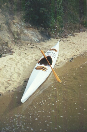

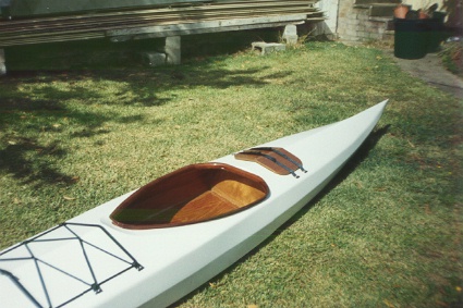

This was my first big project, other than a 4 poster bed, and some wood turning. It's a 17' sea kayak I built about 10 years ago.
Made from cheap 1/8" plywood, coated with fiberglass and epoxy resin, I put in some kevlar and carbon fiber in various places and then figured I'd better paint it 'cause the different materials didn't look all that great together, weighs a bit under 20kg, so it's easy to carry. Just not as easy as carrying a guitar.

Nice job with the Jarrah dining suite there Tim, looks classy.
