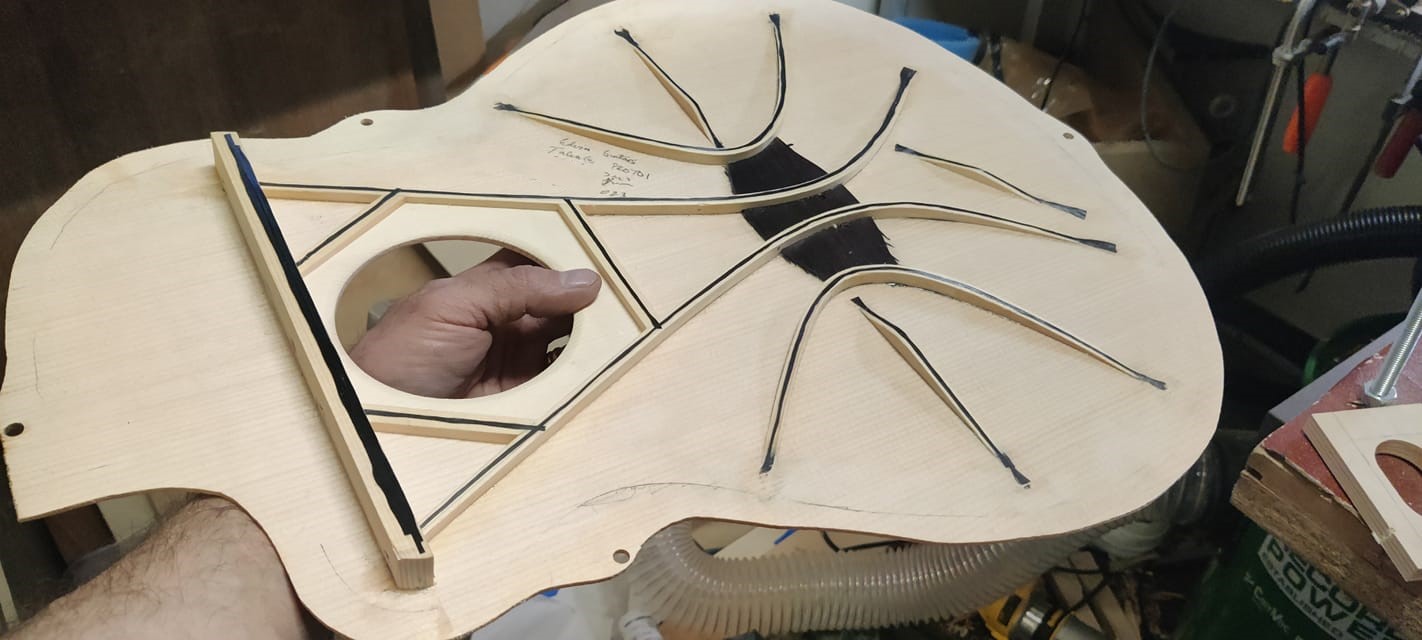

After having read Trevor Gore’s book “Contemporary Acoustic Guitar” for a couple of times, I finally finished building my first falcate braced OM sized acoustic guitar a few weeks ago. My feeling is that this is the most resonant and tonally exciting guitar I have built and I might say also that it is the best sounding one I have ever played, including expensive factory made guitars. This guitar really shines in fingerstyle playing and styles where you have to play and express music utilizing its huge reserve in loudness and nice tonal quality. For demo purpose, my playing skills are yet not on par with this guitar, but I try to have someone to play some fingerstlyle stuff for a demo later.

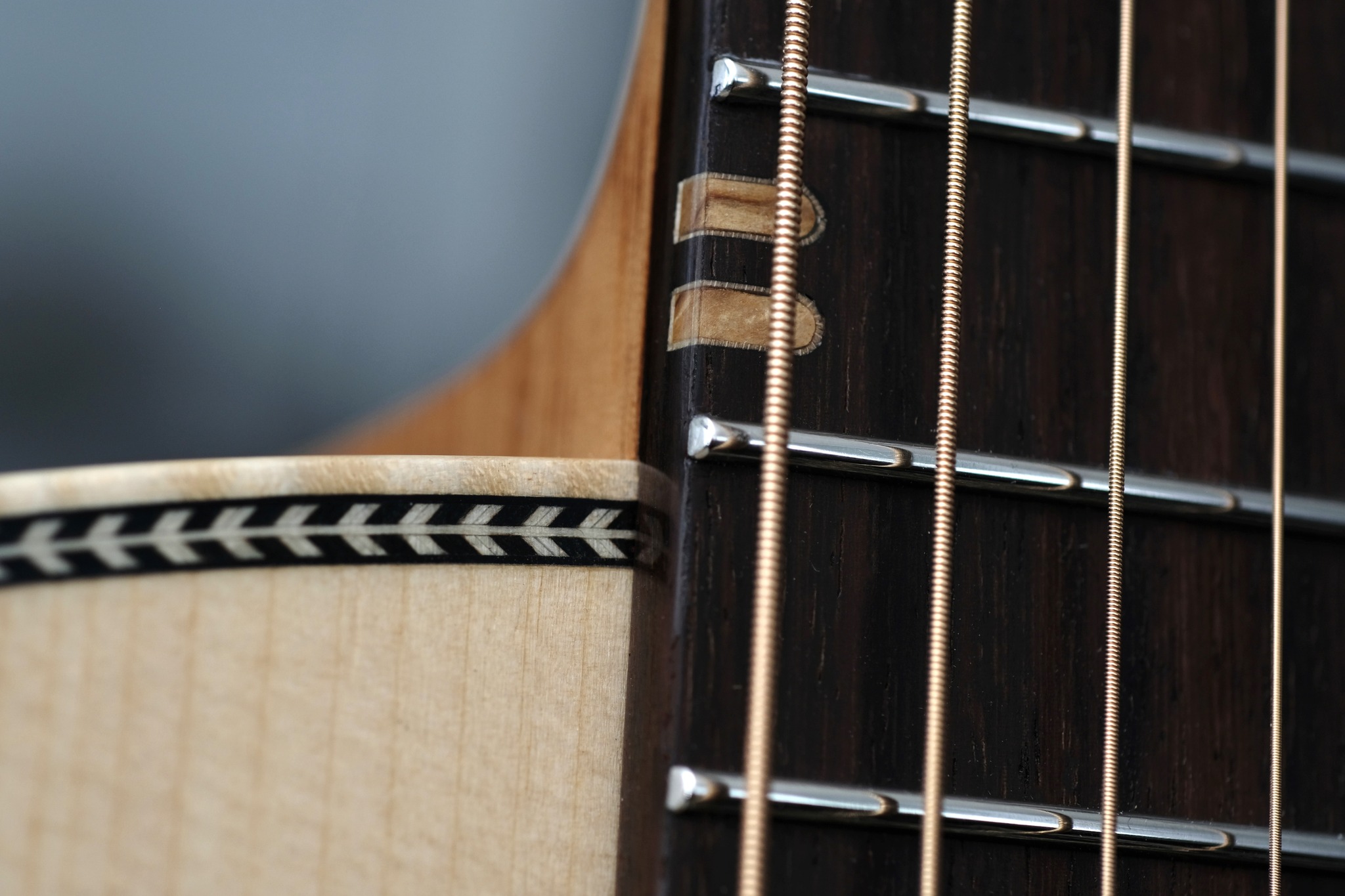

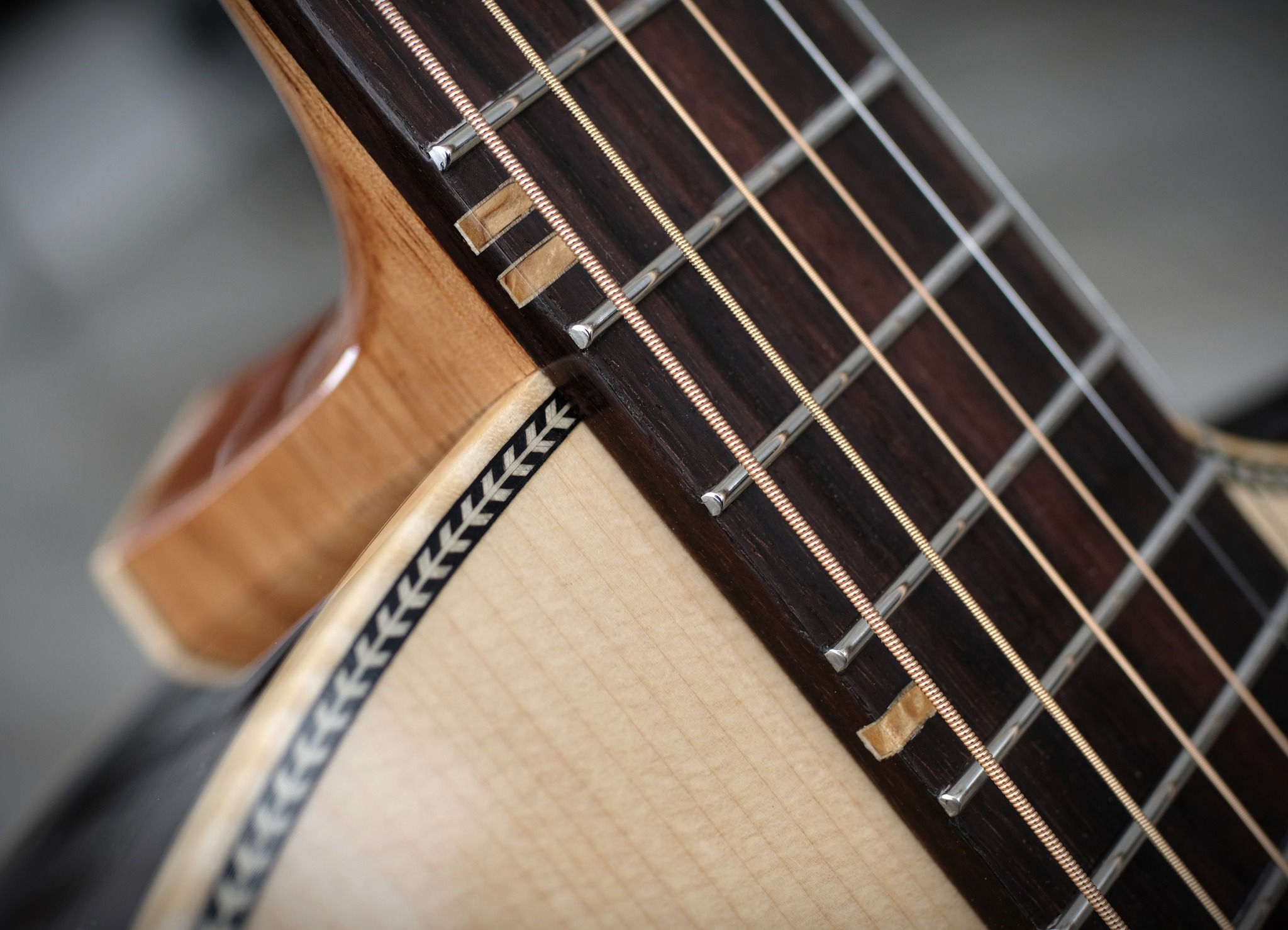

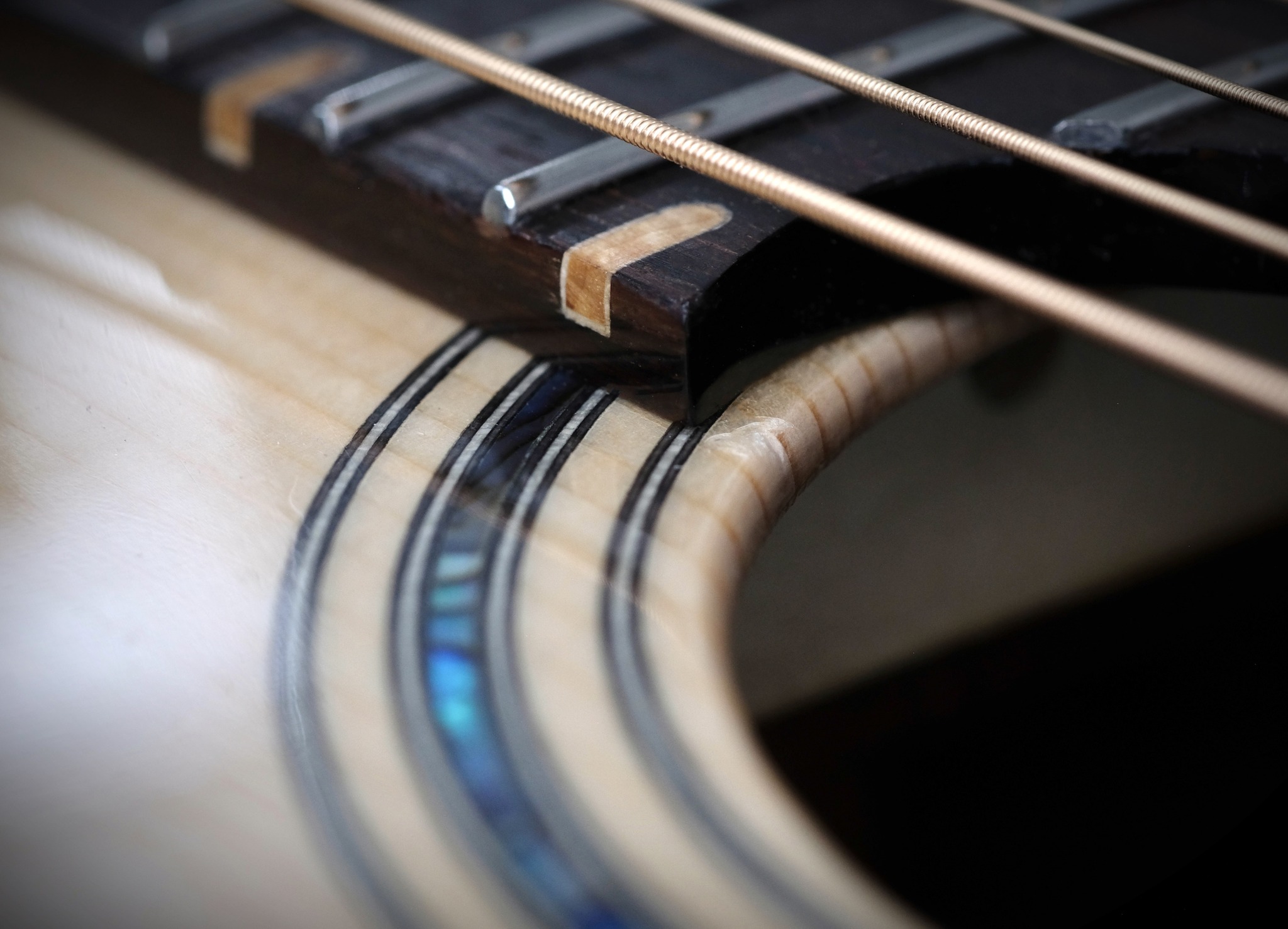

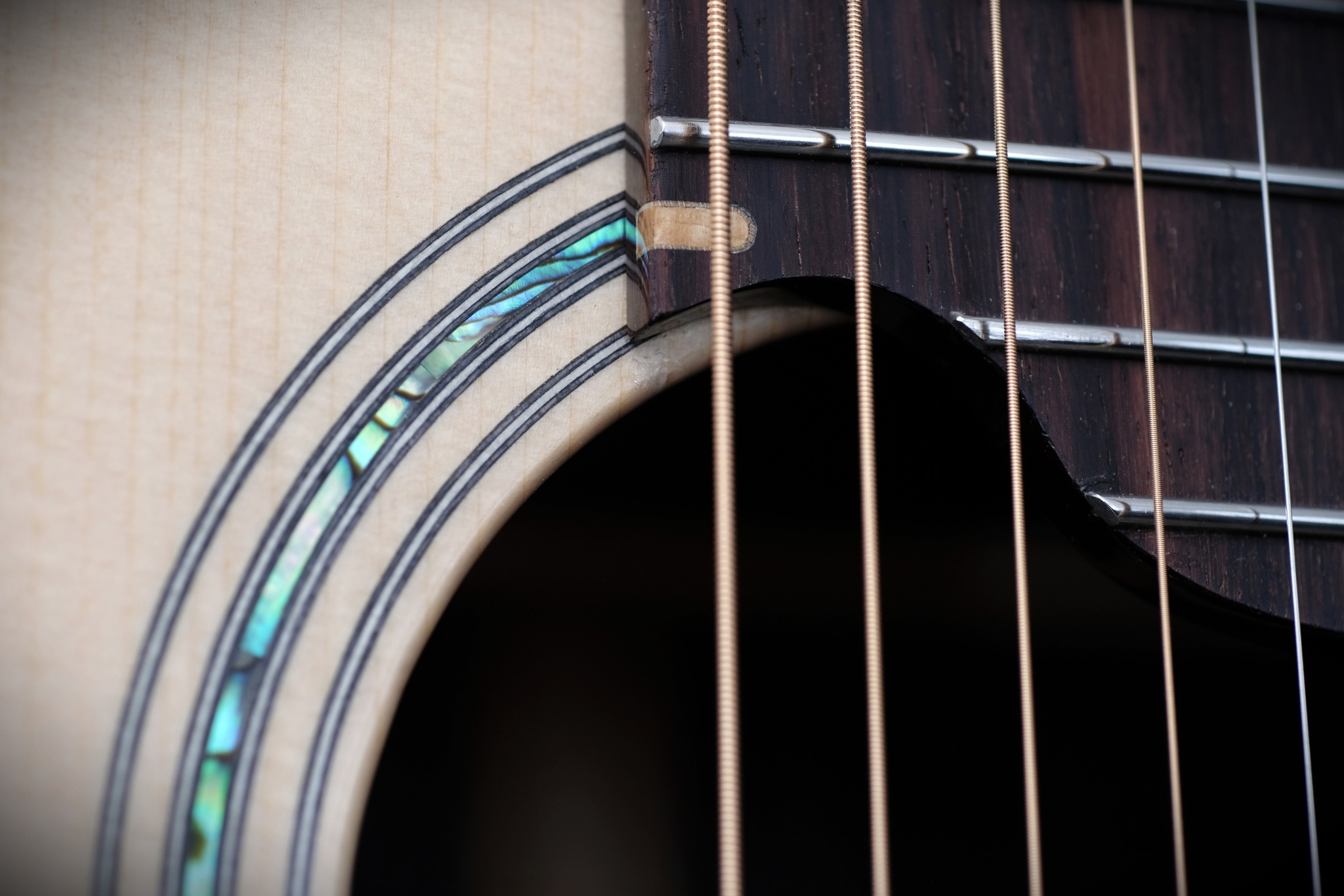

For the overall looks I was targeting to elegant and simple style. I left out pearl everywhere else except rosette. I used flamed maple, selected light Sitka spruce, East Indian rosewood as main woods. Fretboard marking decoration is made of arctic birch “Visa”, with 0.3mm maple veneer around it.

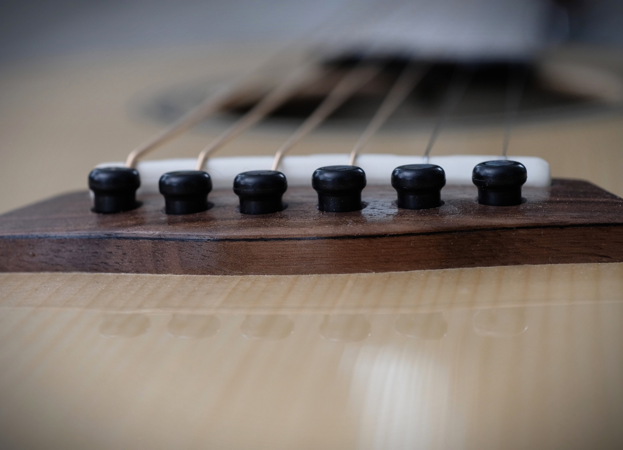

· Nitro lacquer, tried to minimize the thickness, measured about 0.07mm
· Live back as per in Gore’s book

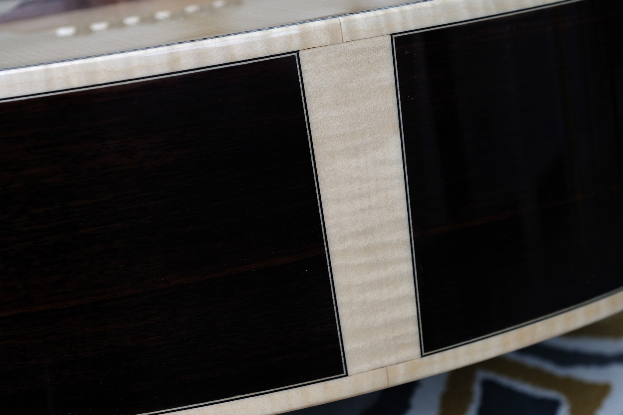

· Laminated sides, these are extremely sturdy, made of 2x2.2mm sides (rosewood/purpleheart)
· Placeholder for additional weights in side (helps to adjust resonant frequencies of the guitar)
· Falcate – bracing strenghtened with carbon fiber
· Bridge: American walnut, with carbon reinforcement
· Tusq bridge/saddle + bridge pins, compensated for every string

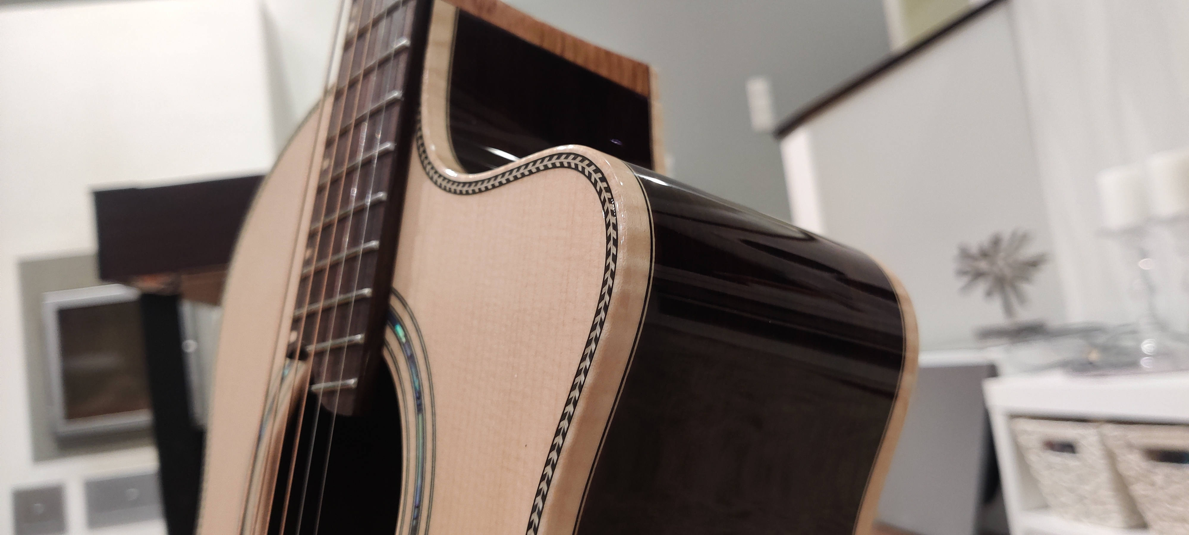

That looks excellently executed. Very dark Indian Rosewood. I have built a few falcates and the design just seems to work.

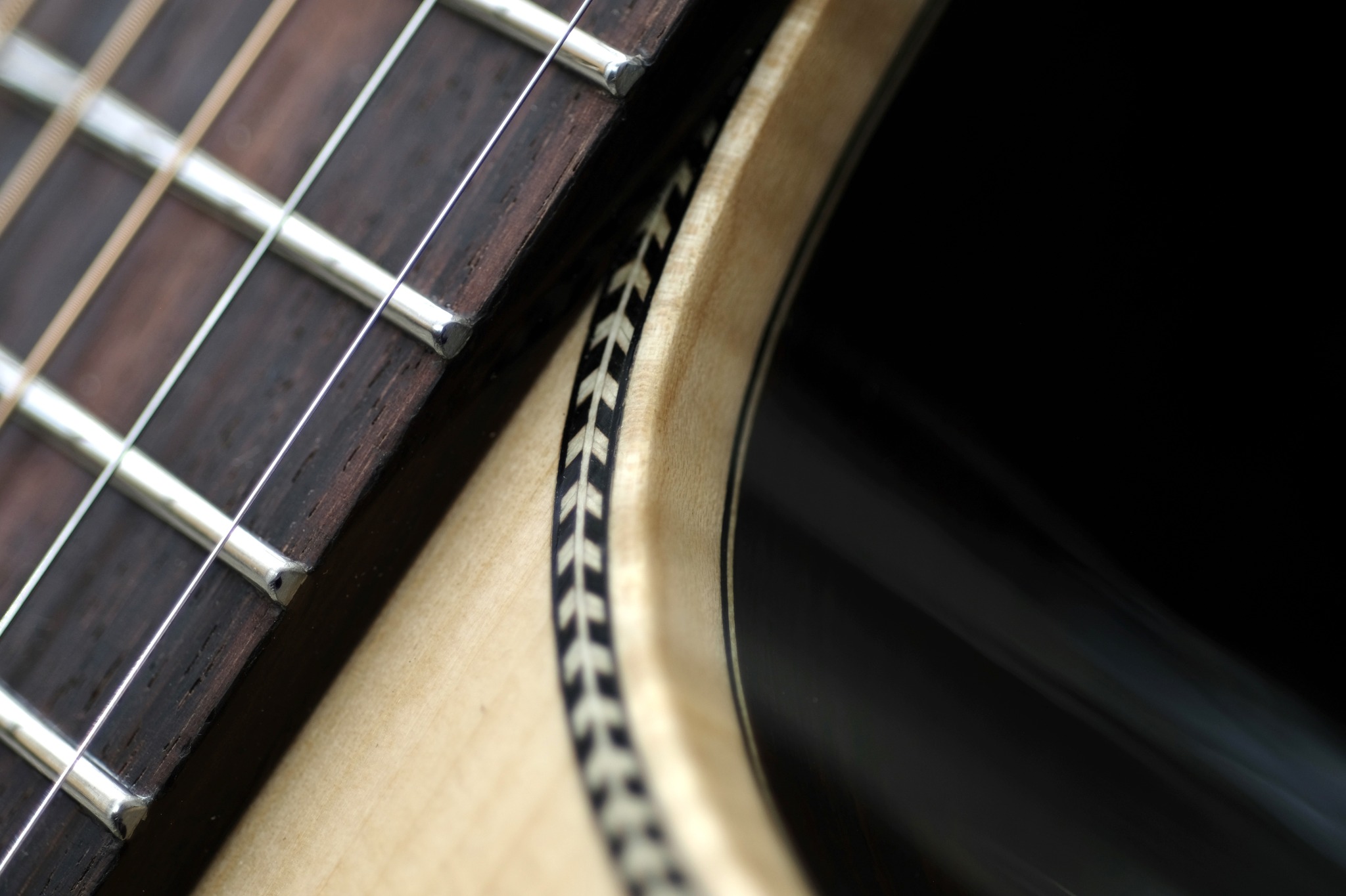

You have managed really clean use of the epoxy with the cf. Mine.don't look any where near as tidy. The wheatsheah purfling looks great and I notice that you have given the top string some more space from the edge of the fretboard so it doesn't get pulled off.

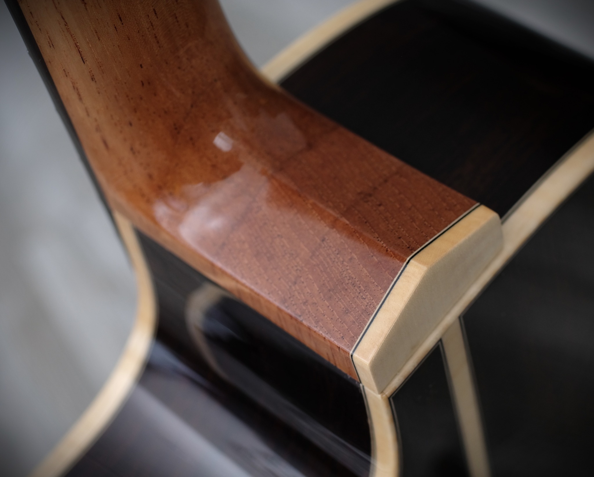

I would use a more sharp cutaway but that is simply an aesthetic choice. Don't have access to photos just now but will post later. A great looking guitar.
The pic+camera lens just fools your eye, my string spacing to edge is pretty much standard to any other "normal " acoustic.
I did make a mold for the sharp cutaway shape as well, but frankly speaking, I did not like so much the shape in the book , realized that when I stared at the templates in my workshop. Plus, I broke the first mahogany side in the bender and then thought it would be a major pain in the butt to bend the flame maple bindings on that curve. So I will probably return to that project later, because I already have bent the inner sides from purpleheart flawlessly. Will use a bit thinner mahogany+ rosewood binding which is easy to bend.

That is a beautiful guitar! Welcome to ANZLF and thanks for sharing your work. I spent last night carving a maple neck with ebony fingerboard and started wondering what sort of fret position markers to put on it. Now I am going to use the idea of your edge markers which can be seen from the front and the side. So this makes you a confirmed member of the ANZLF community - your ideas have already stolen from you here!
