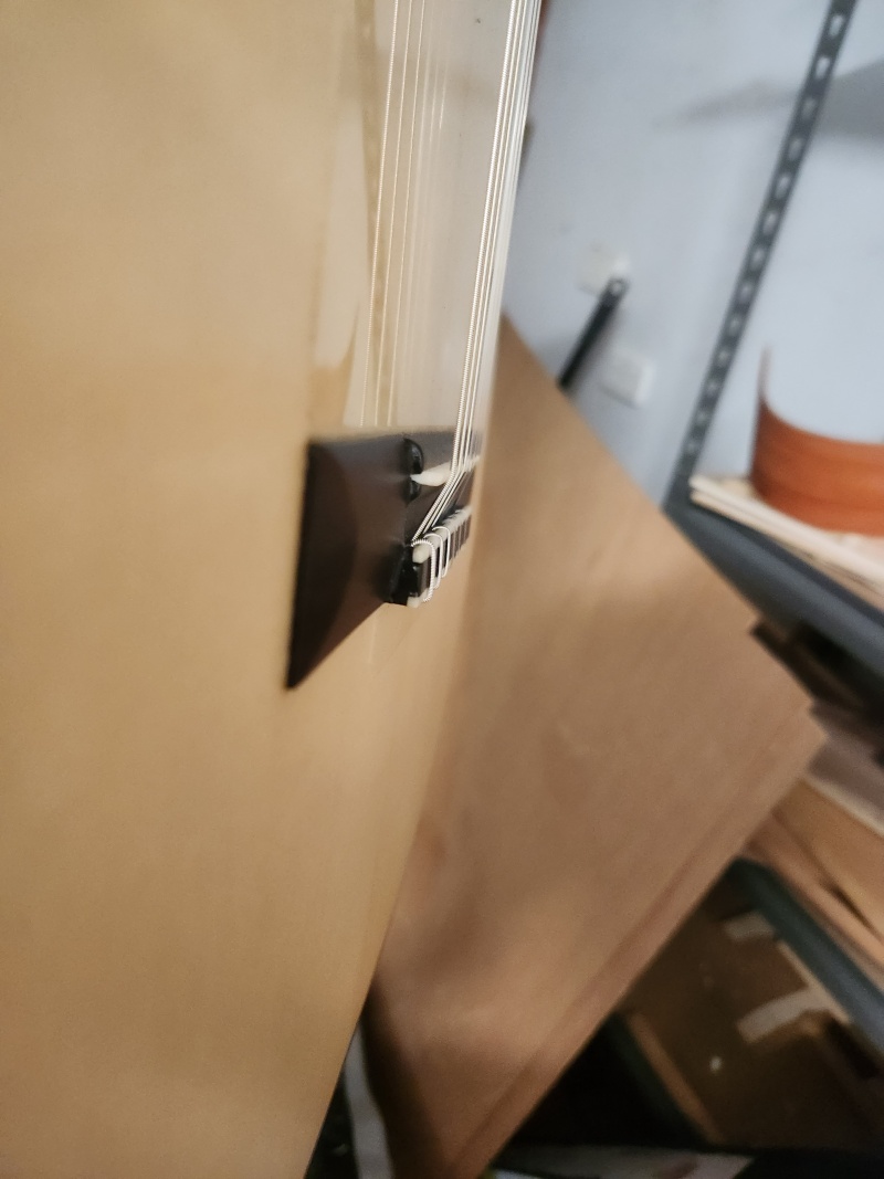

7mm height of the strings off the soundboard? That is surprisingly low (12-13 would be typical for a steel string). Is that a characteristic feature of the flamenco style (my ignorance), and what effect do you think it has on the playability or the sound? How do you achieve that - must be a very thin bridge? Is the fingerboard also thinner?
Re: New Flamenco Blanca
Posted: Thu Dec 21, 2023 2:32 pm
by Steve.Toscano
Mark McLean wrote:
Thu Dec 21, 2023 6:28 am
A lovely guitar Steve. I really like the balance of colours and detail, but still remaining simple and elegant.
Thanks Mark.
The 7mm height is important for good technique with golpes (tapping).
My flamenco bridges are typically 4.5-5.0mm high at the saddle.
To get a good break angle over the saddle (and therefore retain good torque) at this height i do a 12hole bridge with the bottom of the string through hole being only 1mm from the soundboard.
See below example of retaining steep break angle.
The fingerboard starts off at 6.25mm but i level it after its glued down, so I dont know exactly where it finishes at, but i suspect around 6mm.
There is a forward angle on the neck, the nut area would be around 3mm off the plane of the upper bout if that makes sense. The underside of the fingerboard is then scraped to fit over the upper bout.
